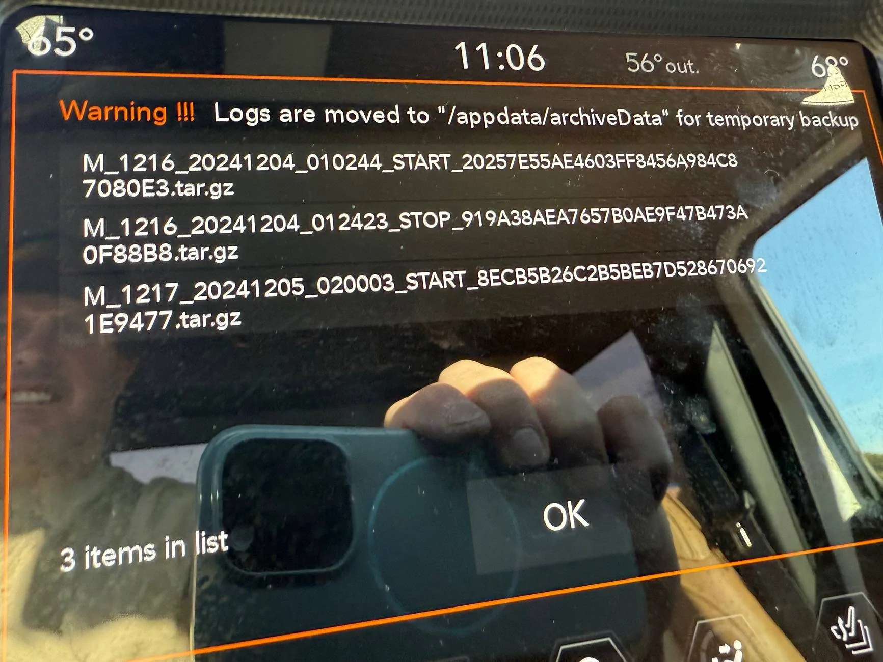

I get this error screen about once every 10 starts. Any ideas.
Bone stock system with no sub/amp in a Rubicon.

This is a radio issue, nothing to do with your FlashCal+ so don't worry there. The radio needs to be reset on a test bench. Only thing I'm aware that will fix it. Other wise it will keep coming up for the life of the radio, up to you if you can live with it. Luckily this is an easy fix and cheap compared to what can happen on these units. We can fix it under our bench testing service. Feel free to give our sales team a ring to discuss the service.
