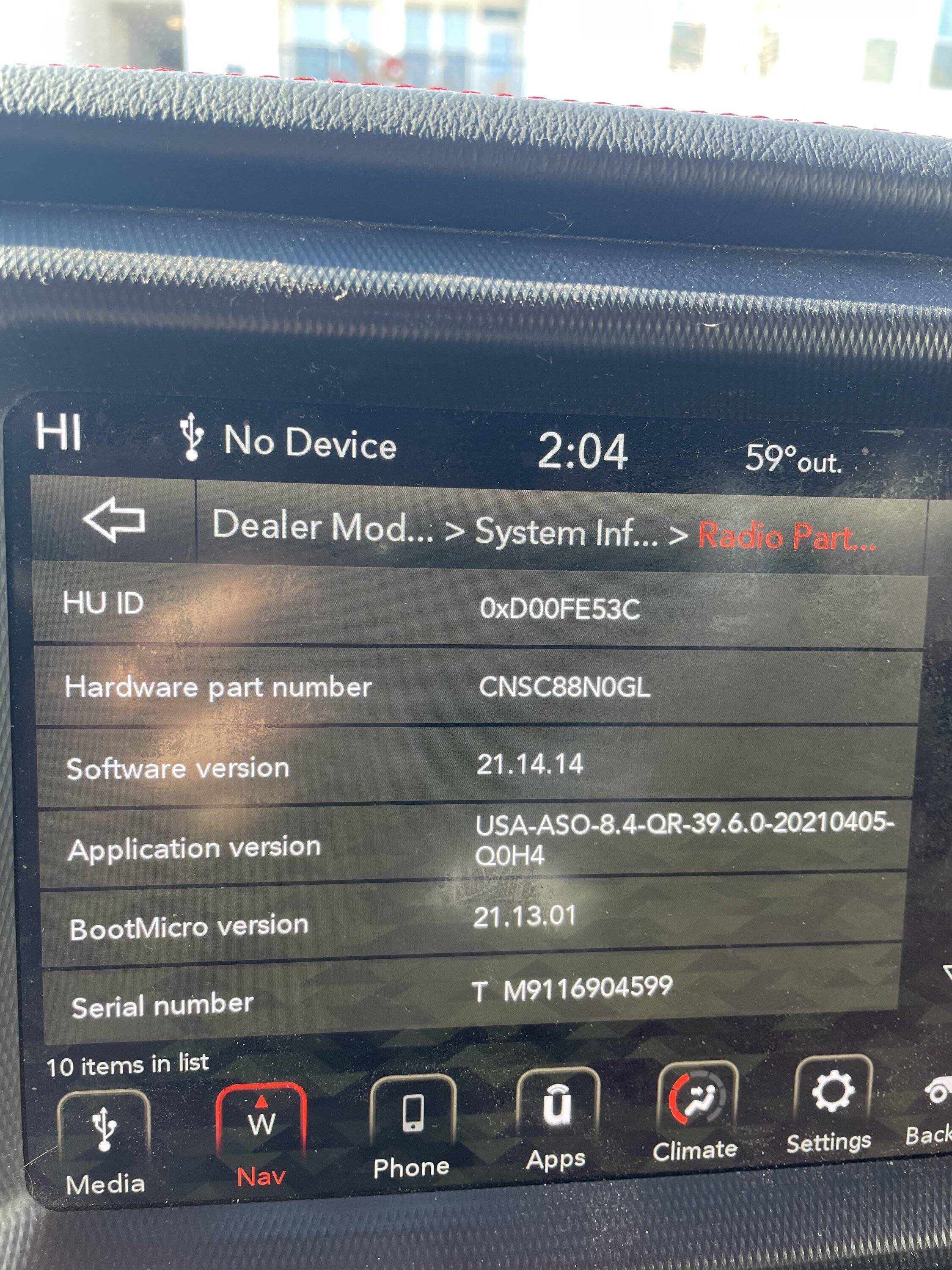

Ok so here’s my software version. Surprised it says 2021 since it’s a 2019MY, unless it was previously updating just fine.
So the number you care about in that application version string is 39.6. You’re one update away from current, which is 40.1.

Fire up the Dealer Mode menu and snap a pic of your Radio Part Information screen.

I’m having this same issue with update failing at 18% error code 20. I checked dealer mode and version is 39.6. Correct to assume I can manually update via USB stick?
my car has also been getting traction control error lights on the dash and check engine light showing up, other weird dash lights turning on then being gone next time it’s driven. Is this all caused by the out of date software?
Yes, you can easily upgrade from 39.6 to 40.1 via USB.
