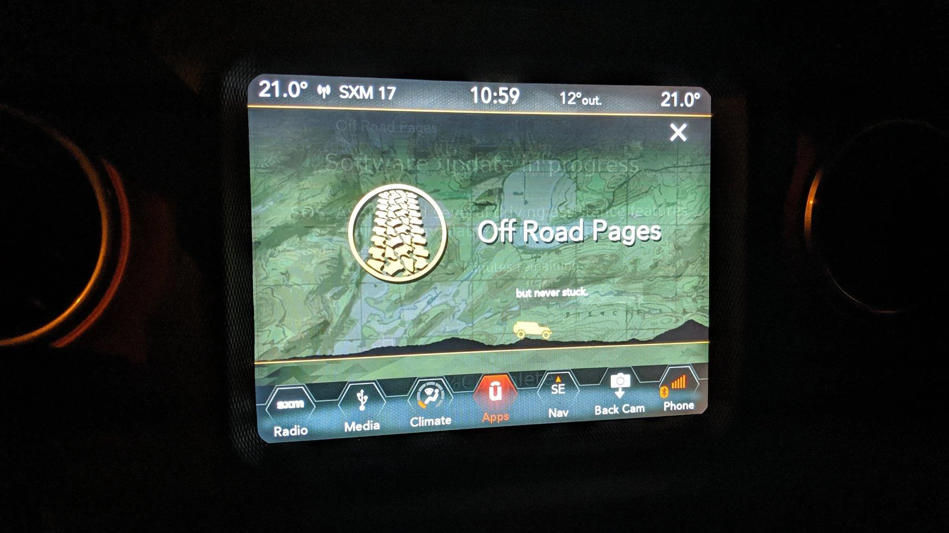

I was able to download the file and followed their instructions to update my system. I now have ORP with this update. After update, I turn off car then turn it back on and see that there is some sort of "background" or "underlayer" of the text or screen that says it is in the updating process. After a while, it seemed to be less visible. Will see how the new software performs in the next few days.

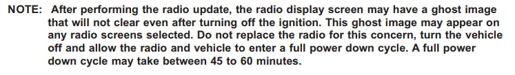

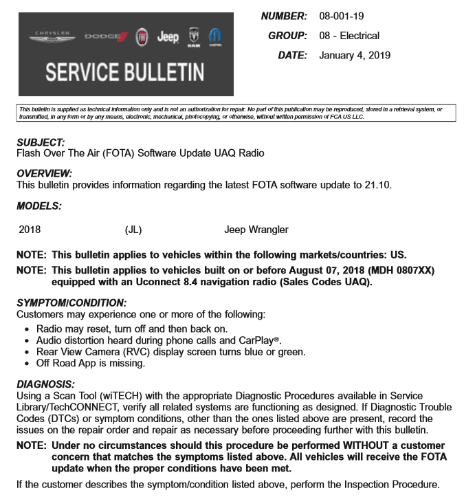

If you read the instructions completely before the update, you should have seen that this is a known part of the update process. For anyone else performing the update, it's the NOTE on page 9 of the service bulletin. You can see the example in the photo below.

Thank you, I didn't read all the way to the end. And yes, the ghost image did disappear this morning :).
