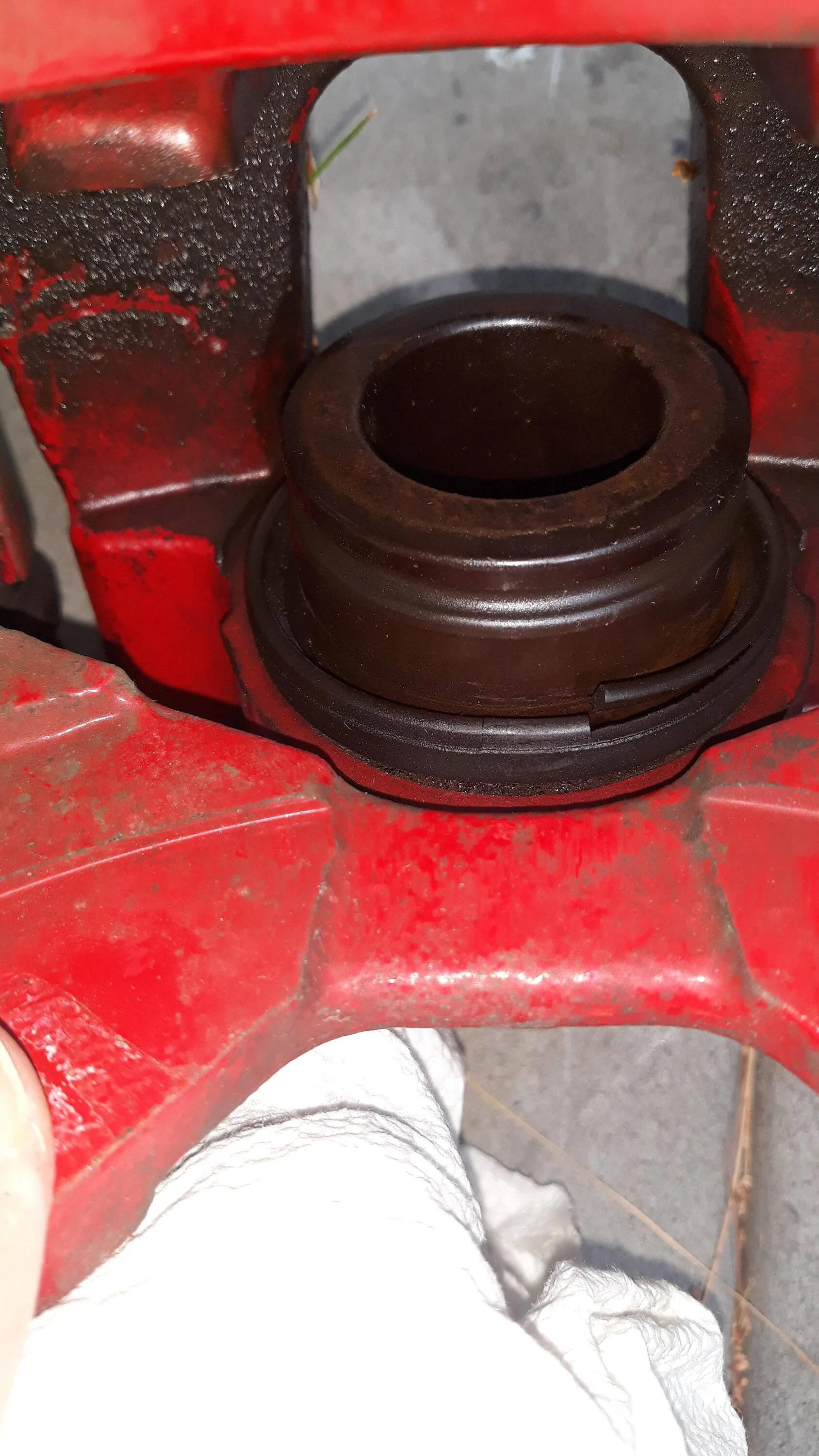

Gotta agree with you on the Powerstops. We got a great deal on them (complete kit) but we didn't notice any difference in braking.
But what was really disappointing was at 40K when they needed pads replaced all the seals were dry rotted just shot. I've never had a brake job where I couldn't get at least one change without having to rebuild the calipers. Even the original calipers the seals are in better condition.
That was about a year and a half ago. Couldn't find seals or pistons anywhere (one was pretty scored up), wound up getting another setup .... had to get it back on the road.
They weren't leaking any fluid thats just from sitting in the box.
Jeep Wrangler JL Brakes 20230921_134725

That is pretty bad. I did not go the whole caliper/rotor/pad route (only rotors + pads) but I was more than a little disappointed in the cost vs. performance. I spent 25% of the cost of the Teraflex's on the Powerstops with no improvement.
