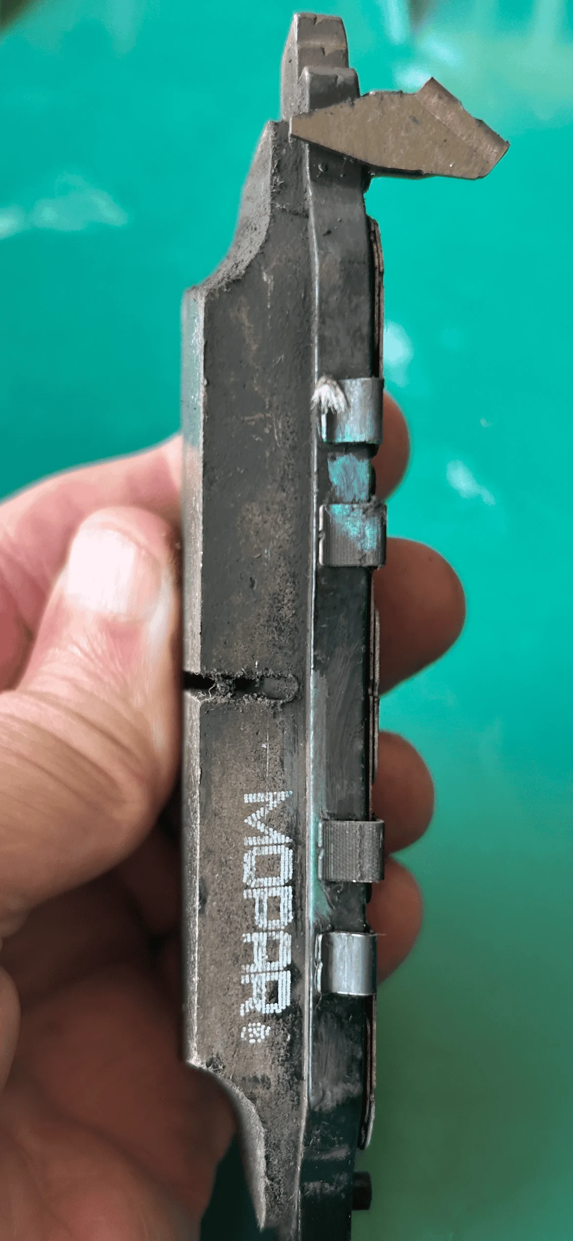

I put new power stop pads on and saved the old ones.
I did too...for about 500 miles and then installed Teraflex. Zero comparison between the stopping power of Teraflex and the OEM or PowerStop, but my JLUR is heavy and needed better brakes.
I could push right through the OEM and the Powerstops no matter how hard I stood on the pedal.

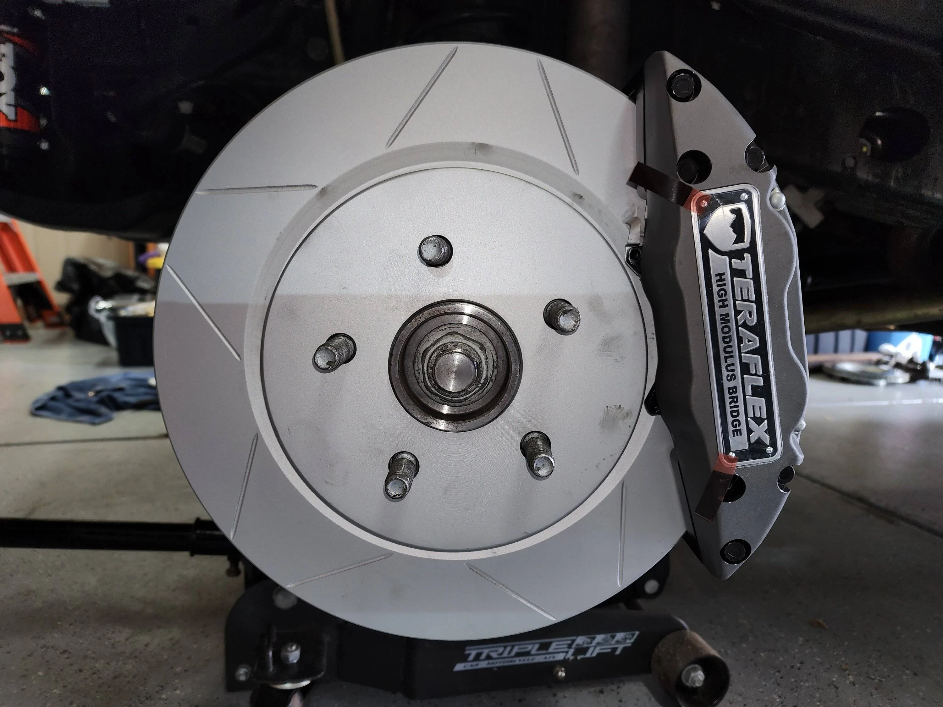

There is no pad that is going to significantly improve the braking power of the OEM brakes nor will rotors--I changed my OEM to PowerStop rotors and Z36 brake pads and there was minimal IF ANY improvement. It was a complete waste of money for the PowerStops--BUT I have a set of rotors and pads with less than 1K miles that I can sell to anyone who wants them!
Look at the difference between the Powerstop rotors with OEM calipers:
Jeep Wrangler JL Brakes 20230414_094252 (1)
Versus the Teraflex:
Jeep Wrangler JL Brakes 20230414_101331 (1)
Here are some data points and these are the largest brakes I can install with my current wheels (17") and here are the differences:
Front:
OEM Rotors = 12.9" versus Teraflex 14" or 17% more total braking surface
OEM Piston = 4 x 2" versus Teraflex 8 x 2" or 100% more total piston surface
Rear:
OEM Rotors = 13.4" versus Teraflex 14" or 8.8% more total braking surface
OEM Piston = 2 x 1.88" versus Teraflex 8 x 2" or 325.5% more total piston surface
