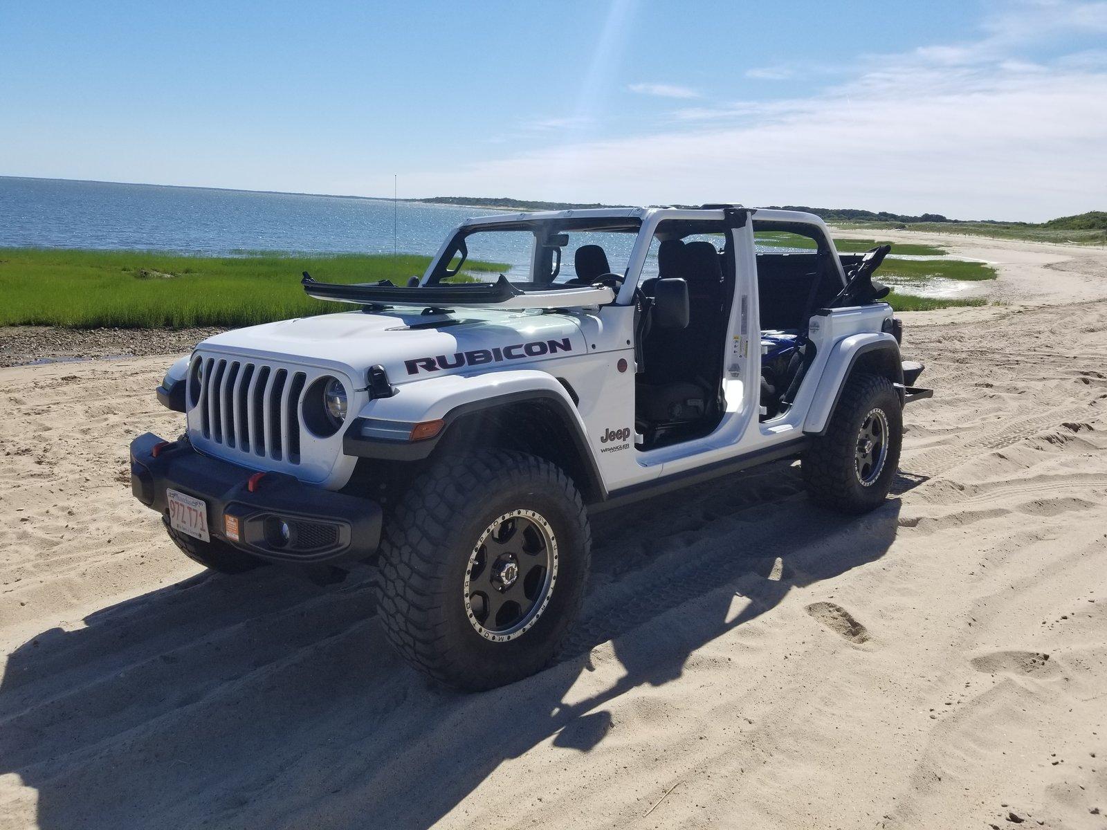

I'm in the sand every weekend. 15psi is the trick!
Jeep Wrangler JL Bogged down in the sand! 20180707_092719

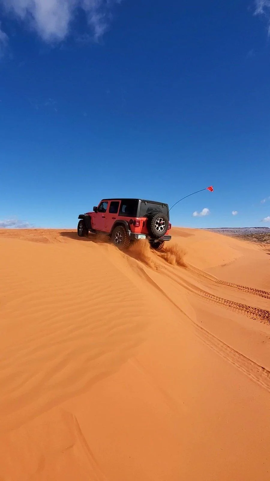

I just got home from Sand Hollow in St. George Utah. Some very big sand dunes with deep, loose powder sand. The first night I did not air down with my 2020 JLUR with the 3.6. It also dug down and bogged quite a bit. Even with traction control off it cut the power a LOT! The second day I aired down and it was a night and day difference. It still would cut power from time to time ( same thing happened to the other JLUR with me) but it was better.
I think with the JL, unless you pull a fuse or have a programmer there is no way to fully disable all the electronic assists, and that makes it feel like you lose power. There is another video about "drifting" a JL where they did disable everything and it made a huge difference.
Jeep Wrangler JL Bogged down in the sand! 0D345C10-86A8-46AC-8C6D-A2716C922941
