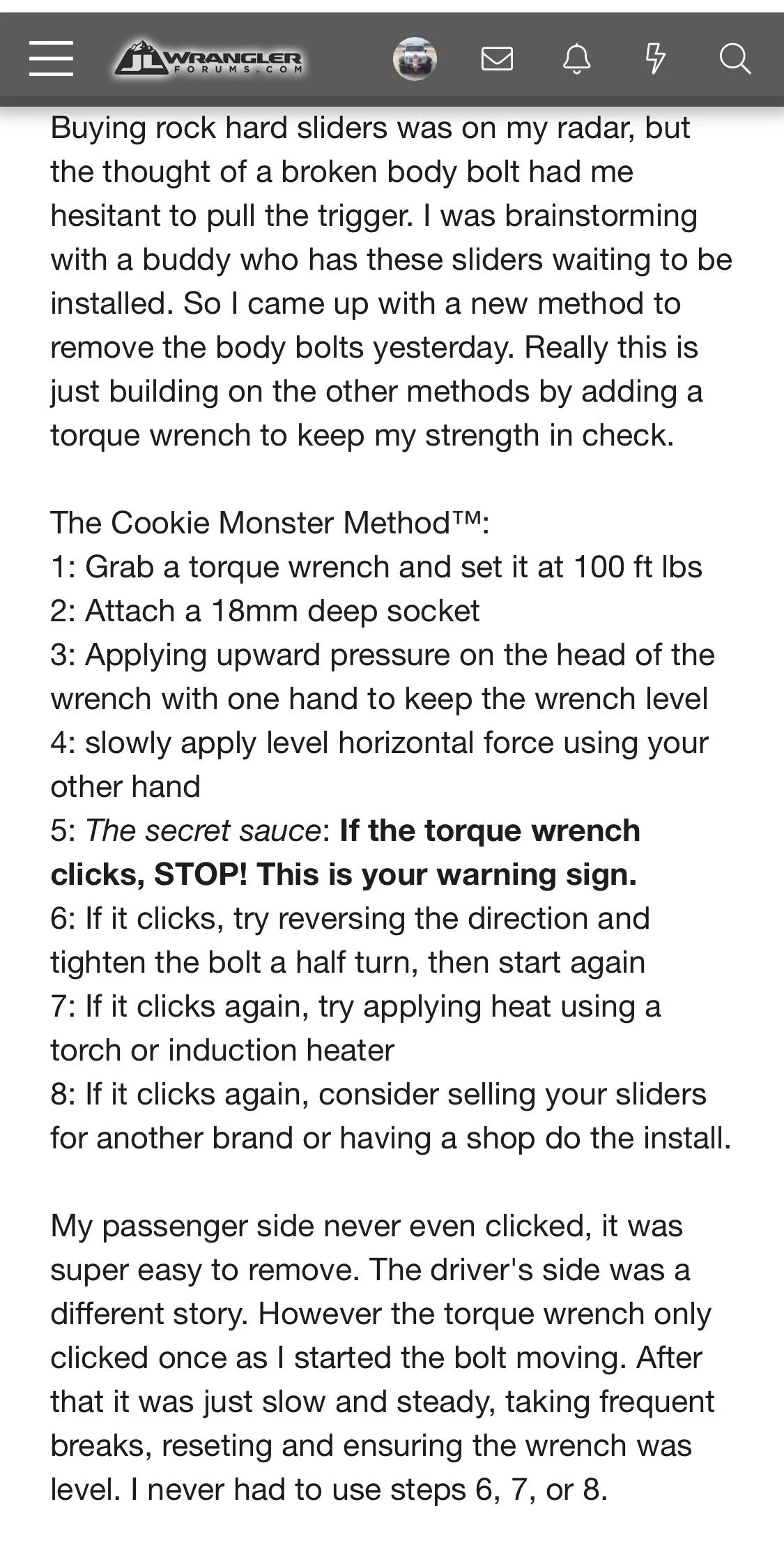

Hi just trying to get some opinion from other members who might of pulled this off, I’ve read over a few thread but now debating whether to do my own work and attempt this or let a shop deal with it just Incase it goes south and a bolt breaks it’s on them, my question is how many people have attempted to remove the body mount bolts on their jlu? I have a MY22 and about to install sliders which use the body bolts as install method, I’ve read of heating up to loosen the loctite and even came across this awesome post by another board member with great advice, just trying to figure out what direction to go, thanks in advance!

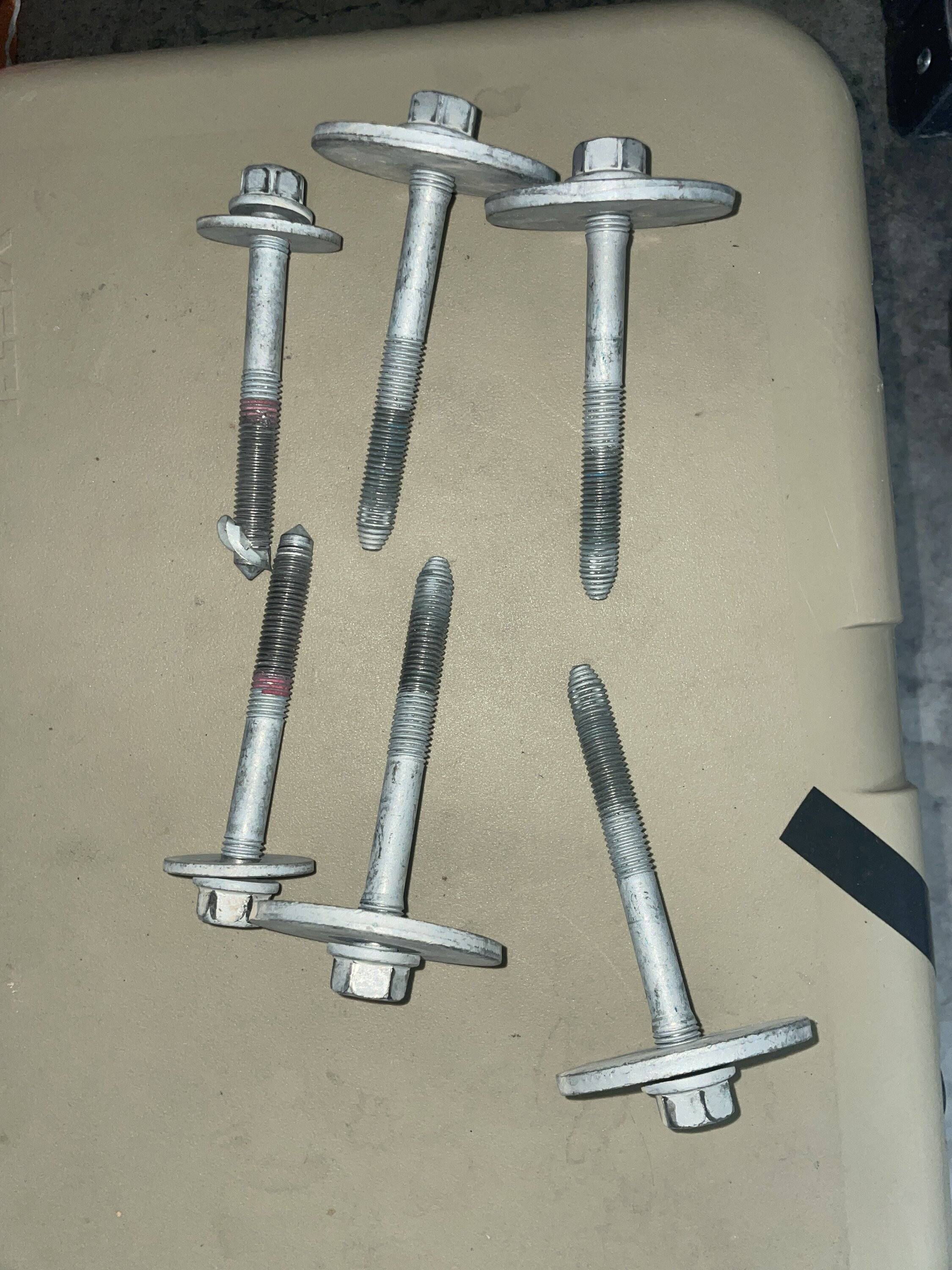

Jeep Wrangler JL Body mount bolts F3E0B976-F8A0-4109-B86C-566382499105
I was so happy to be able to take this picture. I did use the torque wrench method and it was zero issues and never clicked once. Its the front bolt with the red lock tire that will be the problem bolt. Before giving in and paying someone else to do it just try to remove the front bolts. If they don’t fight you the rest should be even easier.
If the wrench clicks then reverse the direction for one rotation to possibly unbind any locktite. I reversed directions a couple times on each bolt before I had to.
