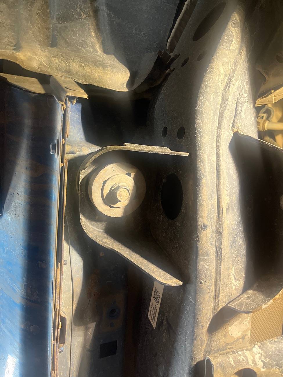

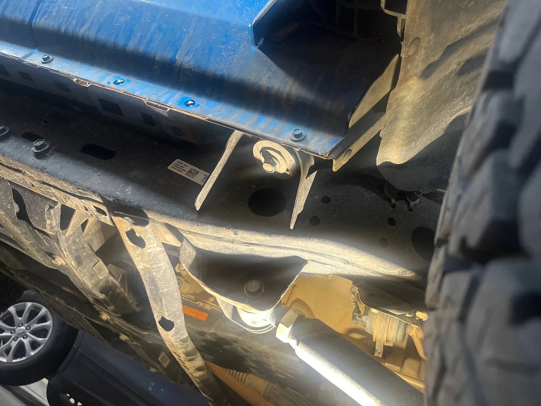

I’m installing some Rusty’s sliders which require the removal of body mount bolts. Are these things normal lefty loosey righty righty? I’m on the passenger side and the front one almost seems to be getting tighter. I tried the middle one and I heard a big snap.
I’m laying under the Jeep looking up and turning the normal threaded direction. Before I break something that’s going to cost too much to repair, need some wisdom.

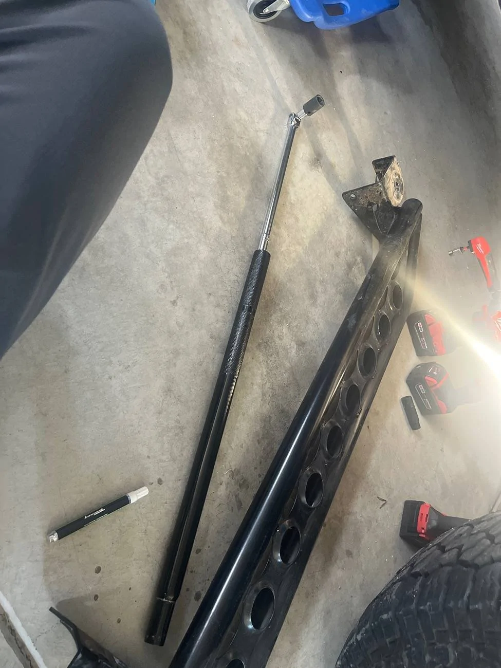

I have an 18” breaker bar with a Daytona jack handle….

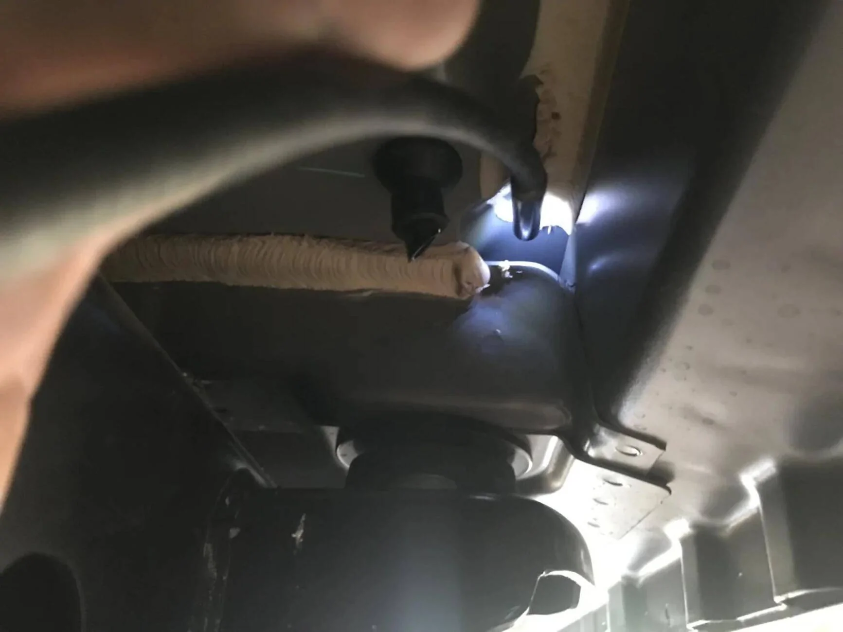

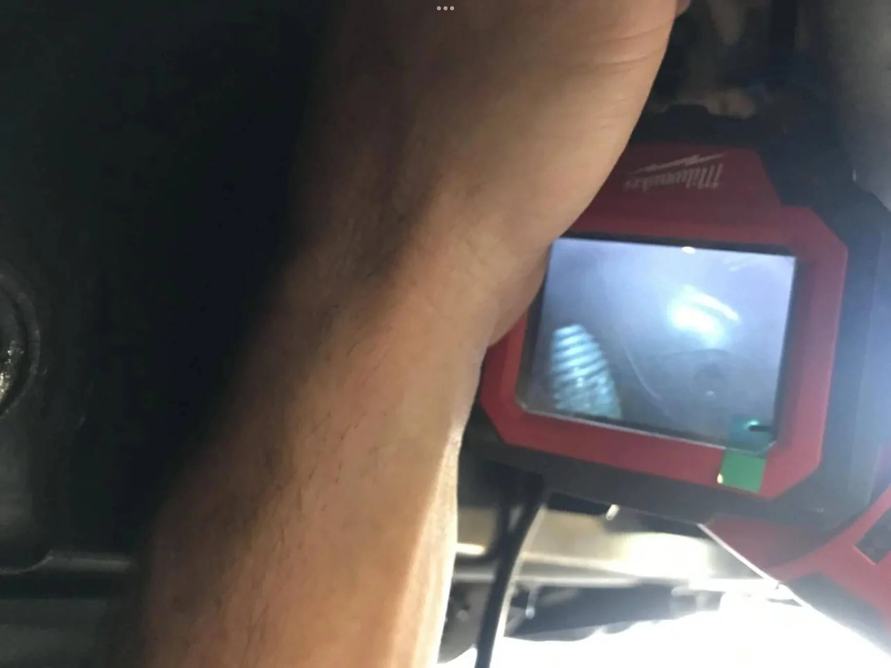

I have pulled the body bolts on two JLs, on a 4 door and a 2 door.
The first was on my 392 and knowing the bolts were easy to break I took extreme caution. Tighten and loosen by 1/4 turn many times on the same bolt. One was not giving up so I got out my bore scope and discovered you can access the threads on the backside through gaps in the body panels. I used a ton of lube (PB blaster or WD/40 anything with a long bendable straw) and flooded the cavity with spray lube. after just a few tightening and loosing atempts the bolt threaded out smoothly. When I did my 2 door I sprayed all the bolts prior to their removal. After the bolts were removed I used a blow gun to blow out any remaining lube. I sprayed so much lube it left a puddle on the shop floor and was running down my arm, but I didn’t break anything. I think I used two cans on the 2 door to pre soak and more during the process.

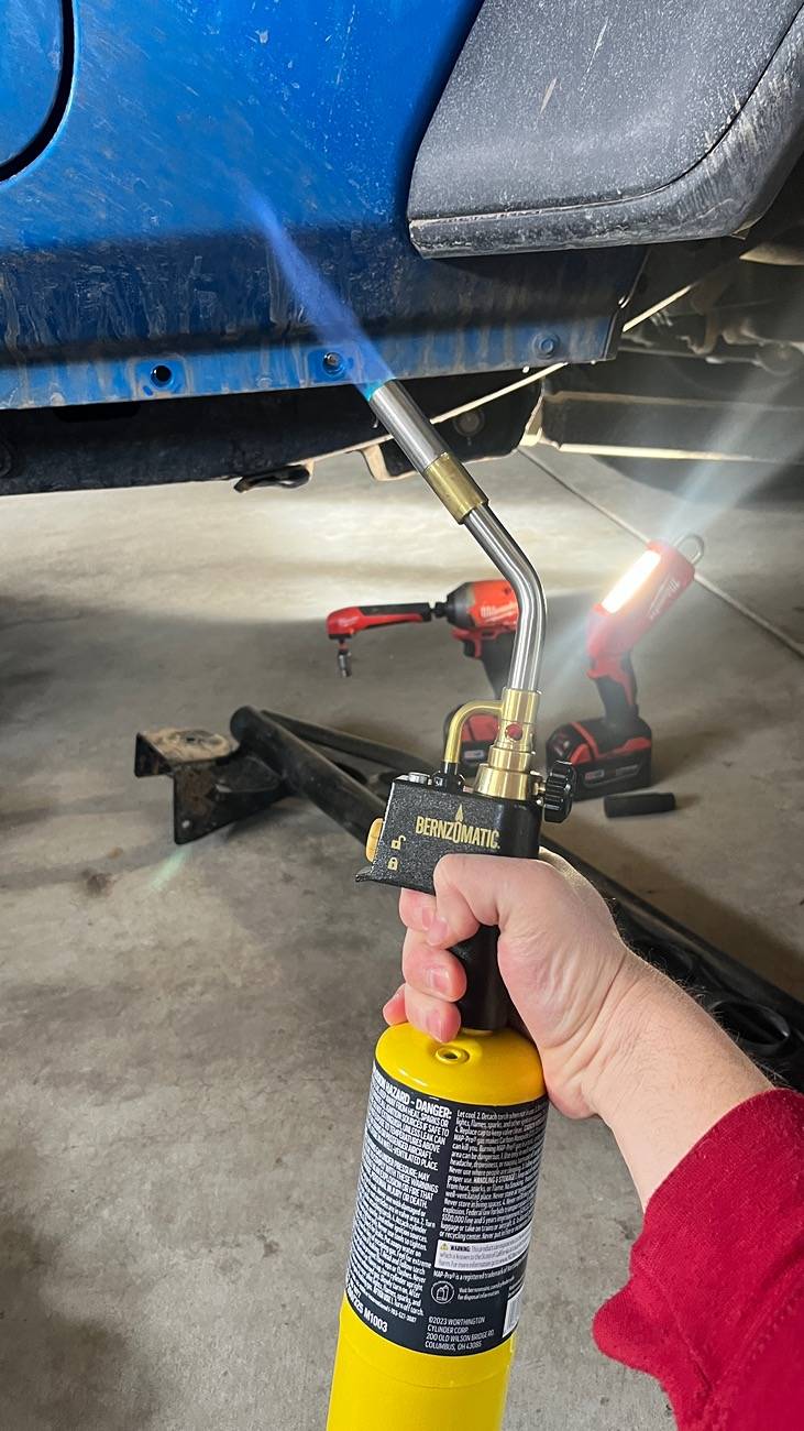

This…. Jeep is in fiiiiiiiiiirrrrrrrre
-Rihana
Same one I used. It actually stays in the house garage now and pretty much exclusively gets used for starting fires out on the back deck lol
