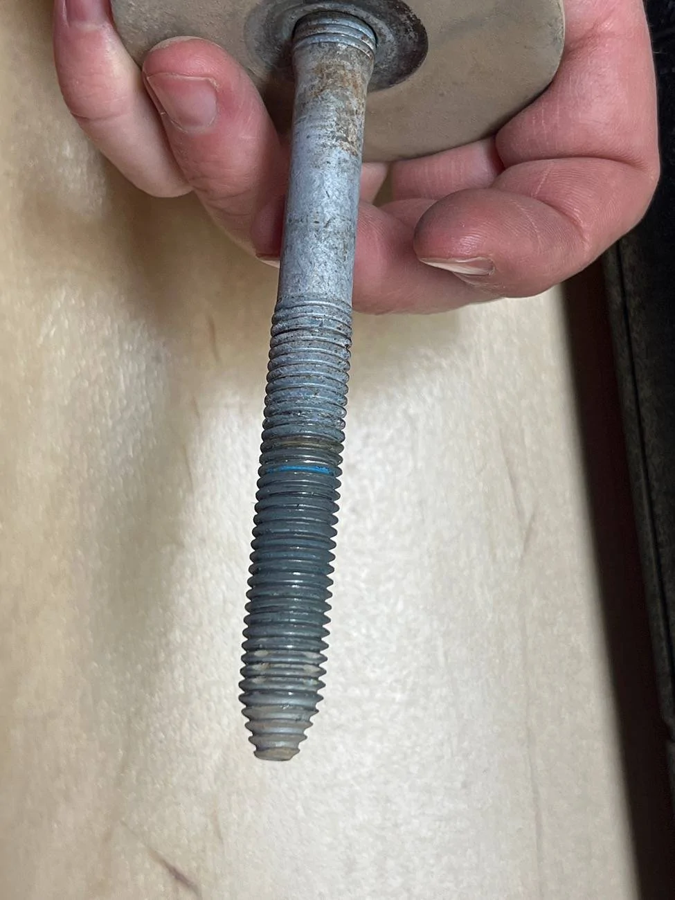

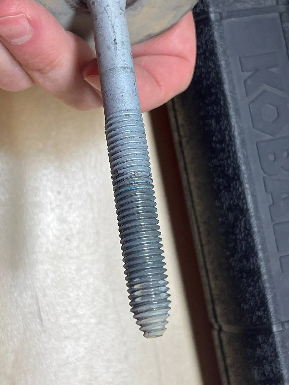

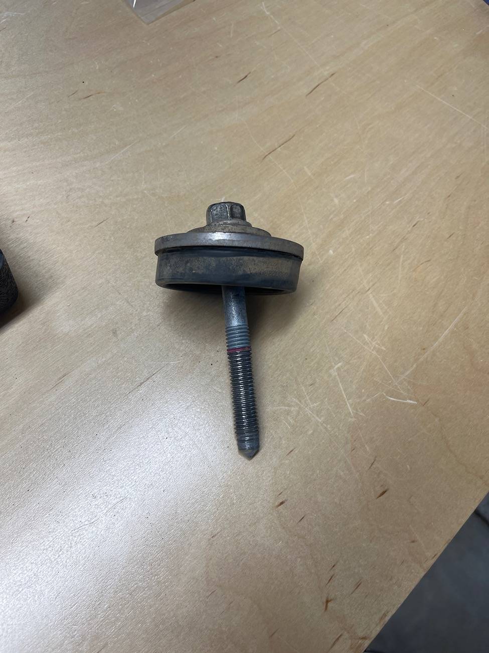

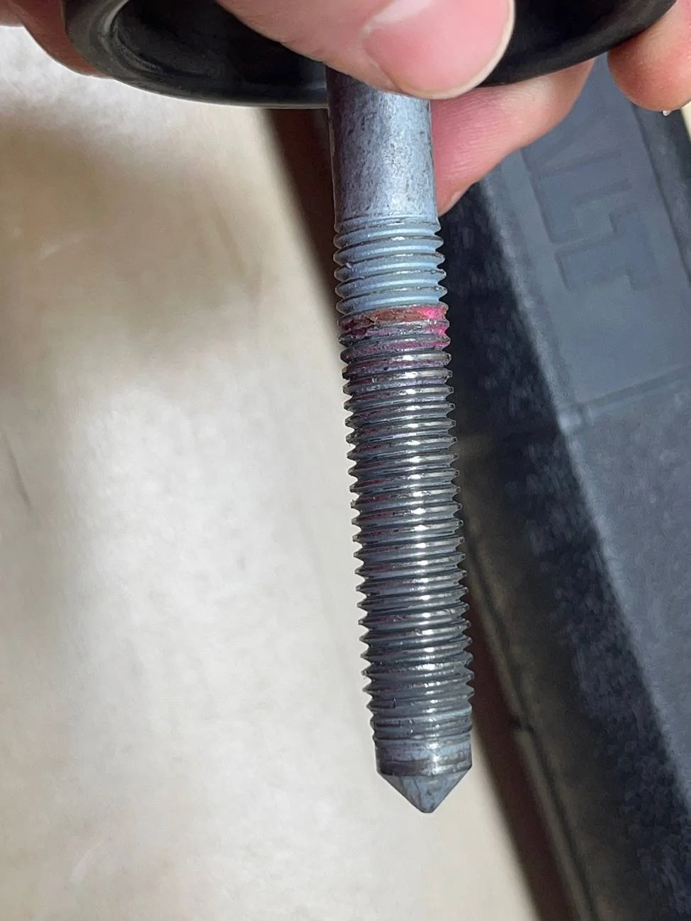

Anyone have suggestions for these bolts? They’re chewed up some, threads probably still okay though.
Im considering cleaning them up with a wire brush and metal pick to get themlooking nicer then drop some anti-seize on the tip for a little lube <insert Michael Scott joke> then another drop of appropriate loctite where the factory put it.
yay/nay?
again, thank you all so much, I can’t demonstrate how appreciative I am for the help. 😃☺😊
yay/nay?
Don't use antiseize and loctite on the same bolt. Loctite performs similar function to antiseize in terms of corrosion prevention. Note that those bolts really aren't really corroded anyway.
Wire brush/pick will work fine, or get the appropriately sized die and run that bolt through and it'll clean up the threads great.

I don’t know if I’d want to reuse the bolts with too much heat being put into them, chewed up, or what not. I’d also prefer to chase the threads to clean out and possible remaining thread locker.
Maybe it’s just past based paranoia. lol

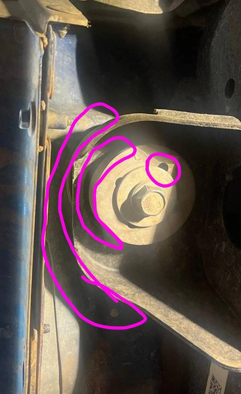

I don’t know how I would spray them, I only have access to the head and they’re upside down so the liquid wouldn’t penetrate up to get to the threads.
I have so,e pb blaster I just lubed my garage door with, it’s silicone lube meant for garage doors so I’d probably need to get a general purpose.
I had the same issue with my sway bar bolts. The only access I had to them was through the head. But I still sprayed the head, and even though there wasn't really a gap there, I tried to spray between the sway bar mounting bracket And where detaches to the frame, and thankfully it actually did the trick. Turns out the penetrating oil does a really good job at penetrating small non-existent spaces! šŸ¤—
I ended up stealing your photo from above, you got plenty of places you can spray it, where it will eventually get to the threads. It is penetrating oil after all...
Jeep Wrangler JL Body mount bolts normal or reverse threaded? 1000007561
Each space where there is even seemingly a non-existent gap, the penetrating oil will get through. I've circled all of the points where you should be spraying.
You actually have a lot more places to spray yours to get through to the bolt than I did with my sway bar.
Like I said above, what have you got to lose?
If I were you I would go for it, but it's up to you how much time you want to spend cranking these bolts off. šŸ¤·ā€ā™‚ļø ;) šŸ˜Ž
