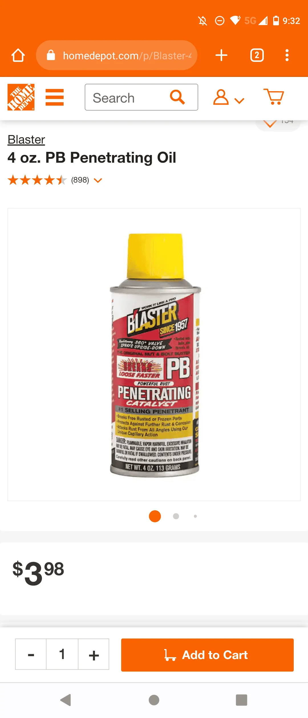

I'm going to do my body lift later this spring. I had a well respected shop manager at my go-to auto body shop recommend that I spray Blasters PB Penetrating Catalyst on the bolts 3 days before I go to loosen them. He said just make sure it's not going to rain for those 3 days, and keep the vehicle dry. And then the day you go to crank those bolts off, spray a little more on them at least 4 hours prior to your project start.
I haven't actually tried it myself yet, but this guy's word is valuable. I mean, he's only been in the business for 50 years, what would he know? ?
If I were you I would use this technique, spray them 3 days prior, then 4 hours prior then loosen them a little bit, spray them a little more, maybe let it sit another hour, and then finish wrenching them off. You shouldn't have any issues.
