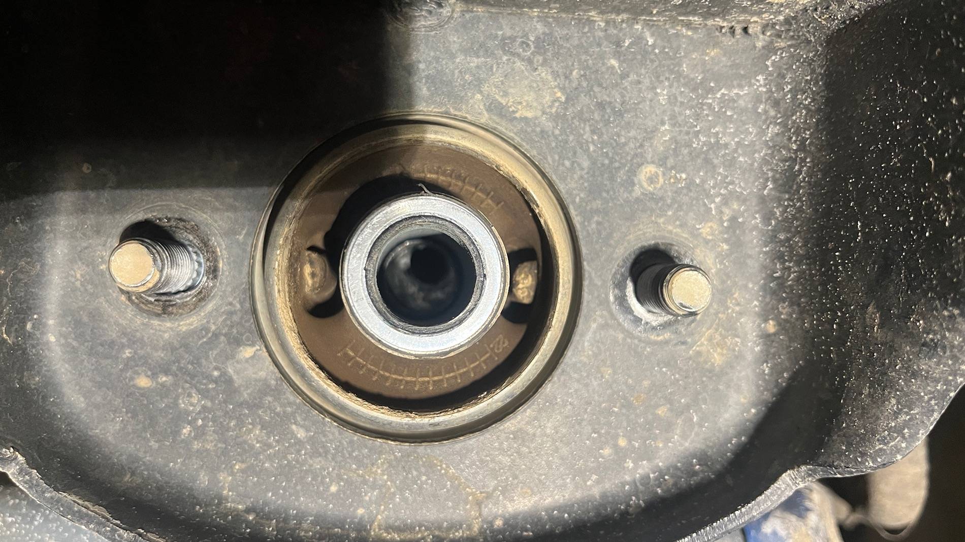

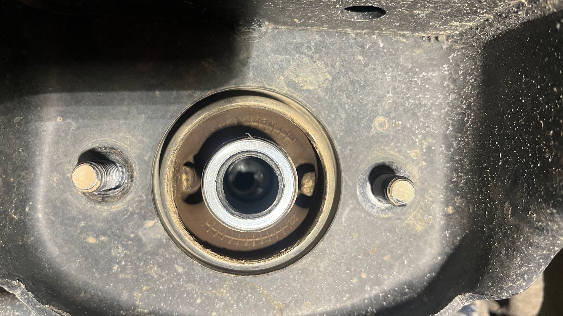

It looks like I have a bigger problem. I went out there and stuck a screw driver in the hole for the body mount bolt. I can move the threaded piece from side to side. That tells me there was a nut that was tack welded and busted off while removing the two rear bolts. Those two were far easier to remove than the front, I can't imagine how weak the welds must have been if this is true.
You may be thinking, "you're just seeing the retaining clip that is moving from side to side." Nope, it's that clip and the cylindrical threaded silver piece above it. Bummer.
I assume I can pull out the front and rear seat and the carpet and I'd be able to access the top side of these. I saw a video where they had to cut a hole in the rear of the wheel well for a front bolt that was snapped. Then they made a cool fancy access panel if that front nut ever had to be serviced again. I need to find where that guy lives because he can do anything. 😁
It's late and dark and really hard to see but I took a couple pictures and short video. Maybe someone knows what I'm talking about and I'm just a moron and there's a secret trick to this, fingers crossed that I'm not as smart as my wife says I think I am.
Now, it could be that the nut is allowed to slide side to side like that. I can't really tell if I can push it up, I'm a little afraid to but at this point, if it is indeed broken, what does it matter if I push it up and it just flops off? Maybe I'll try that tomorrow when there's better light.
This is going from "how do I remove these bolts that should be easier than they are" to "how do I remove the carpet and get to the floor under my carpet?" aye yi yi

I still do not see how it is possible that if the welded nut broke loose the bolt would have came out...does not make sense.

I broke one installing a rear bumper but i was frustrated and used an impact wrench trying to reinstall a bolt that was very slightly shifted out of alignment. They seem marginally welded. I agree though. The odds of the bolt being removed and then the Rifast bung (if that’s what is in there) breaking free seem slim to none. However Murphy is alive and well and is a sneaky bastard.
