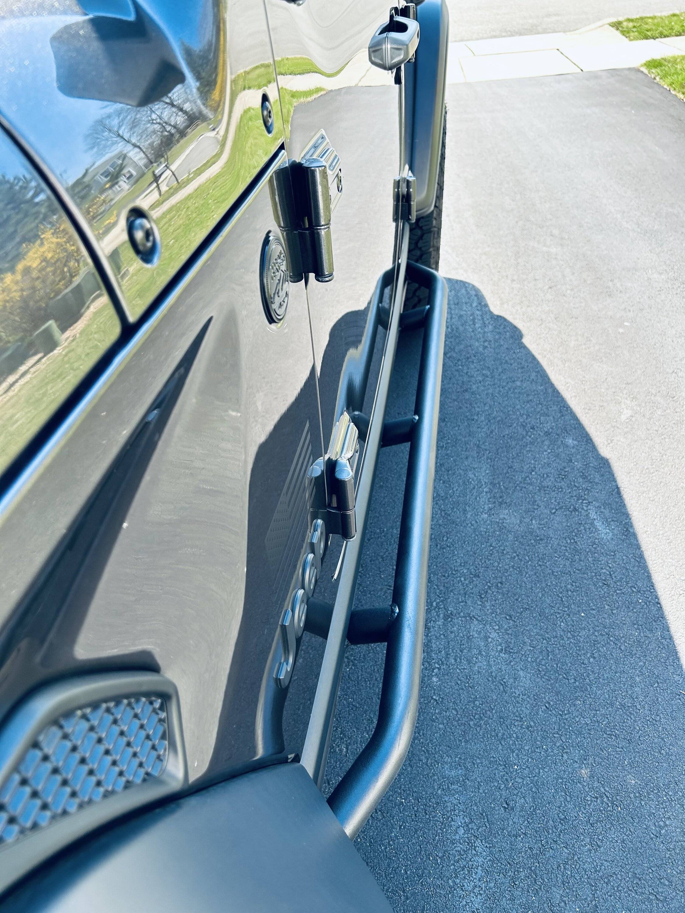

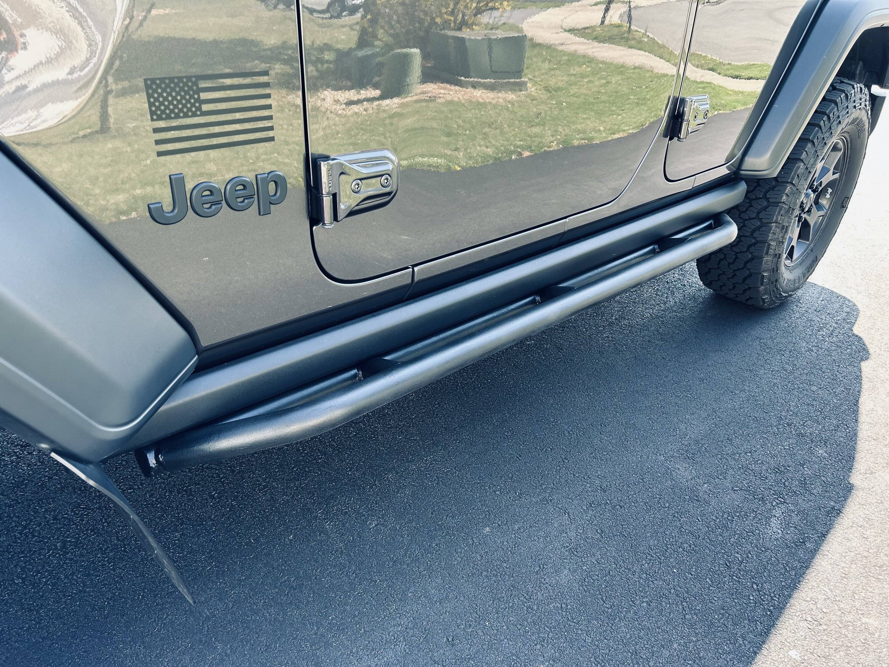

Did you ever get the Ace rails installed? I recently had them put on by a local 4x4 shop(100 bucks), it only took them about 30 minutes w/out issue.
Jeep Wrangler JL Body mount bolts IMG_0594
Jeep Wrangler JL Body mount bolts IMG_0589
Antonio
Antonio
Antonio
Jan 4, 2022
32
717
1,038
NJ
2022 JLU Rubicon diesel
Looks great!!
I ended up going with moose step assist rock rails for now, eventually when I do my lift I will reconsider this
