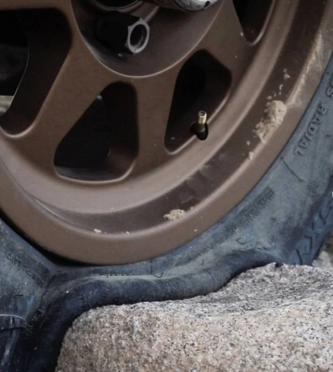

My opinion over the years, I have actually only lost a bead 1 time, we have burped tires tho' multiple times, always the outer, if you look at how a wheel is made, the inner bead has a raised part on the wheel to lock it in.
Unless you run serious trails with 3 pounds of air, forget it. The inner never pops off...BUT when and if it does your in deep poo.
Have a tire shop "glue" outer bead and then lower to 10 or 12 and roll with it.
Here where we wheel, lots of rocks,mud,trees etc....and 3 pounds on a beadlock wheel is a good way to cut your tire, biggest reason to run beadlocks is for when bouncing side to side with low pressure, you wont pop the outer bead off.
This is why outer beadlocks only are normal.
Always carry starter fluid or brake cleaner (no Kali' kind) and a lighter ;)

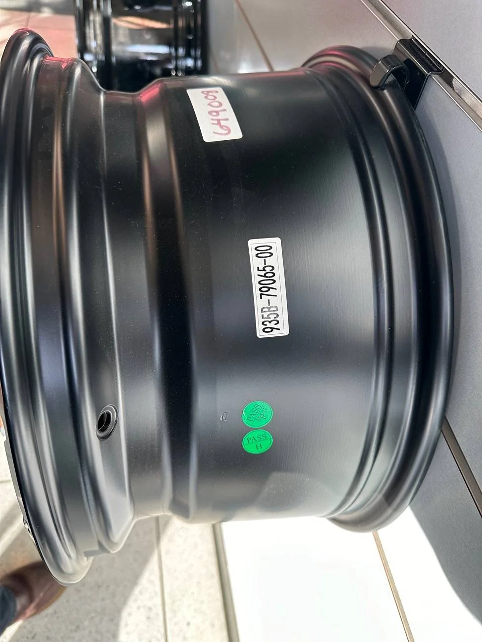

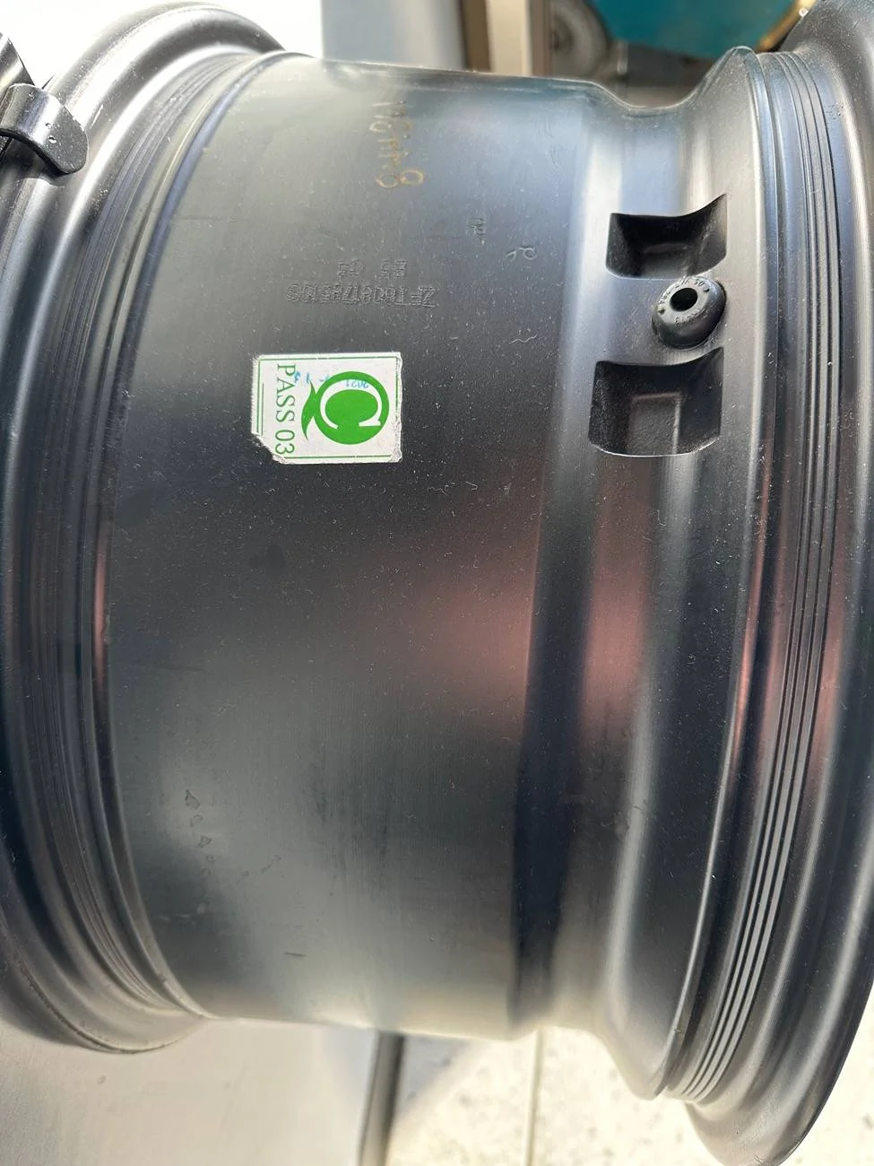

Couple of hand-waving follow-ups:
1. The primary safety issue arises because normal tire mounting uses tire pressure to seal to the wheel, so as long as the tire has sufficient air pressure, the tire is locked in place. If you get a nail, slash or bump it too hard, and cause a flat then the tire can come off the wheel. But in normal operation that won't happen.
Bead locks are basically a mechanical ring that locks the tire to the outside of the wheel. Air pressure is not required, but if any bolt is loose, you can get an air leak and run the tire flat during normal driving (or just parked). You must "actively" monitor the rings to ensure they remain tight. Normal driving causes the wheel and tire to heat up and cool down which, along with vibration, routinely loosens the bolts so constant maintenance is required.
2. Bead locks comprise a bead-lock capable wheel and corresponding bead ring that goes (bolts) on the outside to create a wheel-tire-ring sandwich. I thought "bead grip" was trademarked by Method (not sure), but Icon and other manufacturers have similar wheels. These have a "groove" machined into the inner wheel where the tire sits to help keep the tire in place under low (or any) pressure. The tire seats down into the groove, typically with ridges on either side to help keep the tire in place. Both sides of Method or Icon wheels have these "grip grooves" AFAIK so both sides ("inner" and "outer") of the tire are captured, unlike typical bead lock wheels that only grip the outer side. Look at some pictures of a regular wheel, and then Icon and Method wheel, and the difference is pretty clear. Tires are mounted on bead grip wheel like any other wheel, no special handling required, and other than monitoring air pressure as usual no additional maintenance is needed.

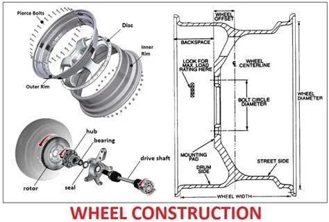

Great pictures, thanks!
Even the non-bead grip Methods, like some other racing and off-road oriented wheels, actually have a little higher inner bead "bump" to help hold the tire bead on the inside edge a little better. Many wheels, at least that I have seen, have little to nothing to prevent the inner edge of the tire from being pressed from the outside to cause a leak. Notice how in this (random Internet) diagram there is little to prevent the inner side of the tire from being pushed away from the outer rim and thus losing air. "Performance" wheels often have a higher inner bump/ridge to help keep the tire in place against the wheel rim during hard cornering.
