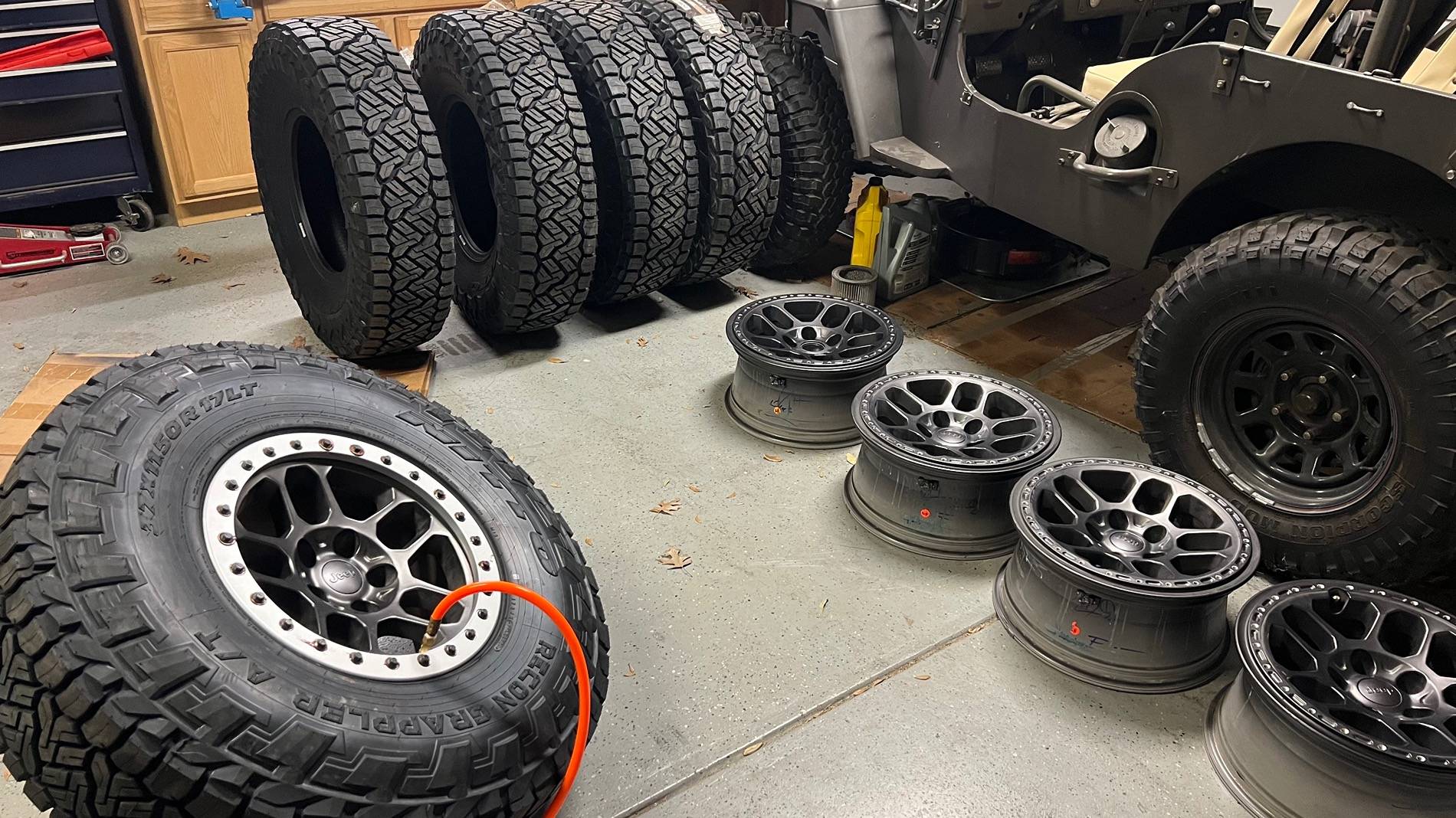

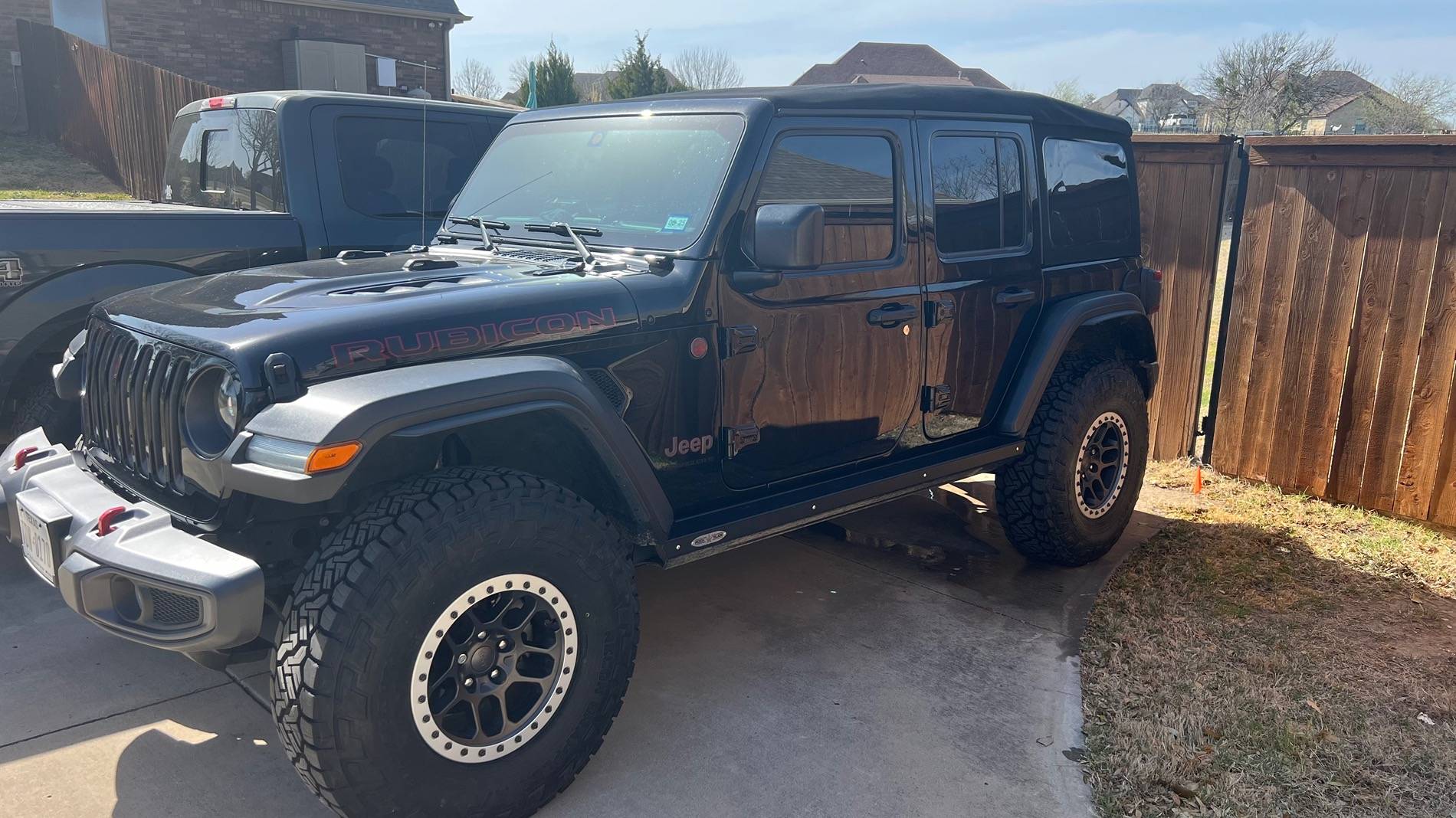

Here is my 23 JLUR - XR with beadlocks installed. If you are going to run beadlocks you will likely have to mount them yourself and maintain the torque on the rings. No standard shop will mount them , and it is somewhat time consuming to make sure you get them properly seated and then follow the torque sequence. If you have any questions just let me know.
All you need is the ring and hardware, they come as a kit. Negatives would be potential liability since they are not DOT compliant and weight since you are adding rotating mass.

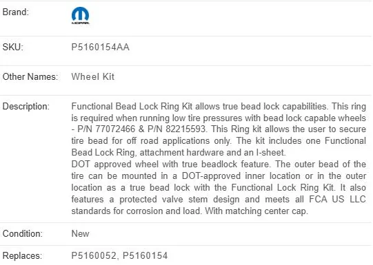

There are (expensive) DOT-approved bead lock wheels and rings that have special retaining clips on the bolts, but the Mopar rings are not that way. You can mount them with the inner bead inside the wheel (a normal non-bead lock mount) to be DOT approved, but normal bead lock mounting (tire rim outside wheel and inside the bead lock ring) is not DOT compliant with the Mopar rings (so using the Mopar rings for true bead locked tires is not DOT approved). If you want to be legal, mount them normally, then swap to regular bead lock configuration at your destination. Have fun.
Oh, they run ~$300/ring kit, I've rarely seen them more than 5 or 10 percent off, and you need four of them -- five if you want one on the spare.
