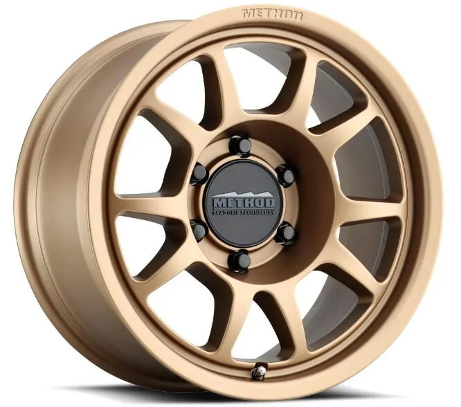

One thing to note while purchasing regular wheels is the valve stem angle. Especially if you buy something like the apex rapid precision valve. Notice before purchase the angle of the valve from the wheel, if its close to the edge/lip, it may not be a good solution as its a hard part. Not like a rubber valve stem which has some flex and tries to resist being torn off. I had a set of bead grip 702's and you can notice its a bit tough to work the apex deflator with the room that you have. I never liked the angle of the valve stem.

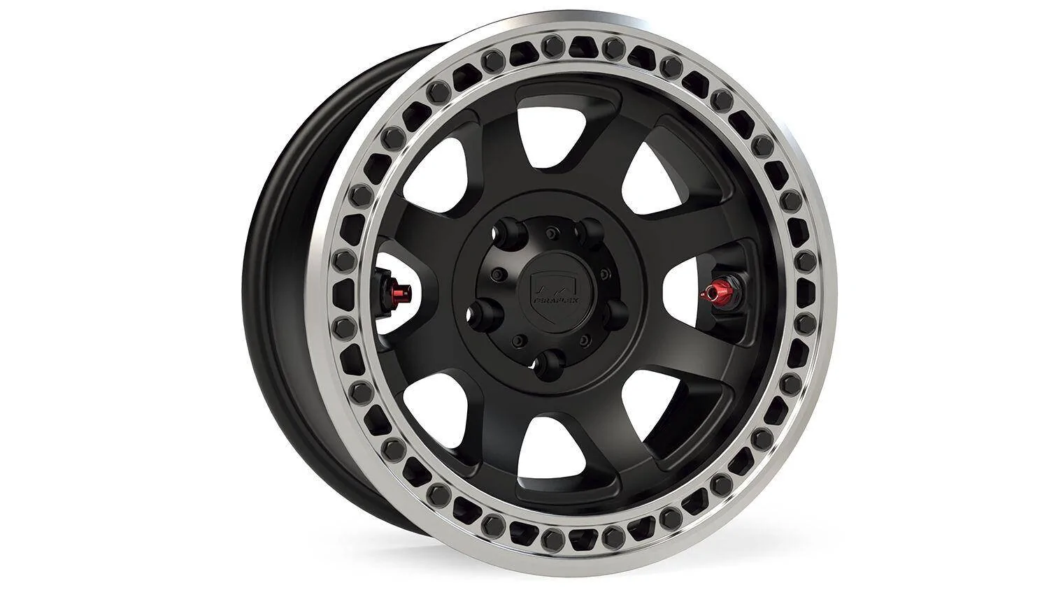

Beadlocks generally have plenty of room for these type of valves and a ring to protect it all. My newer beadlocks are from Teraflex and its super convenient to walk around opening the air deflator valves, and as soon as I open the 4th, I walk back around to close them all. takes about 1 minute for the entire process and no other tools needed to monitor as it's set to a psi that you program, just wish they would have a -38 offset.
