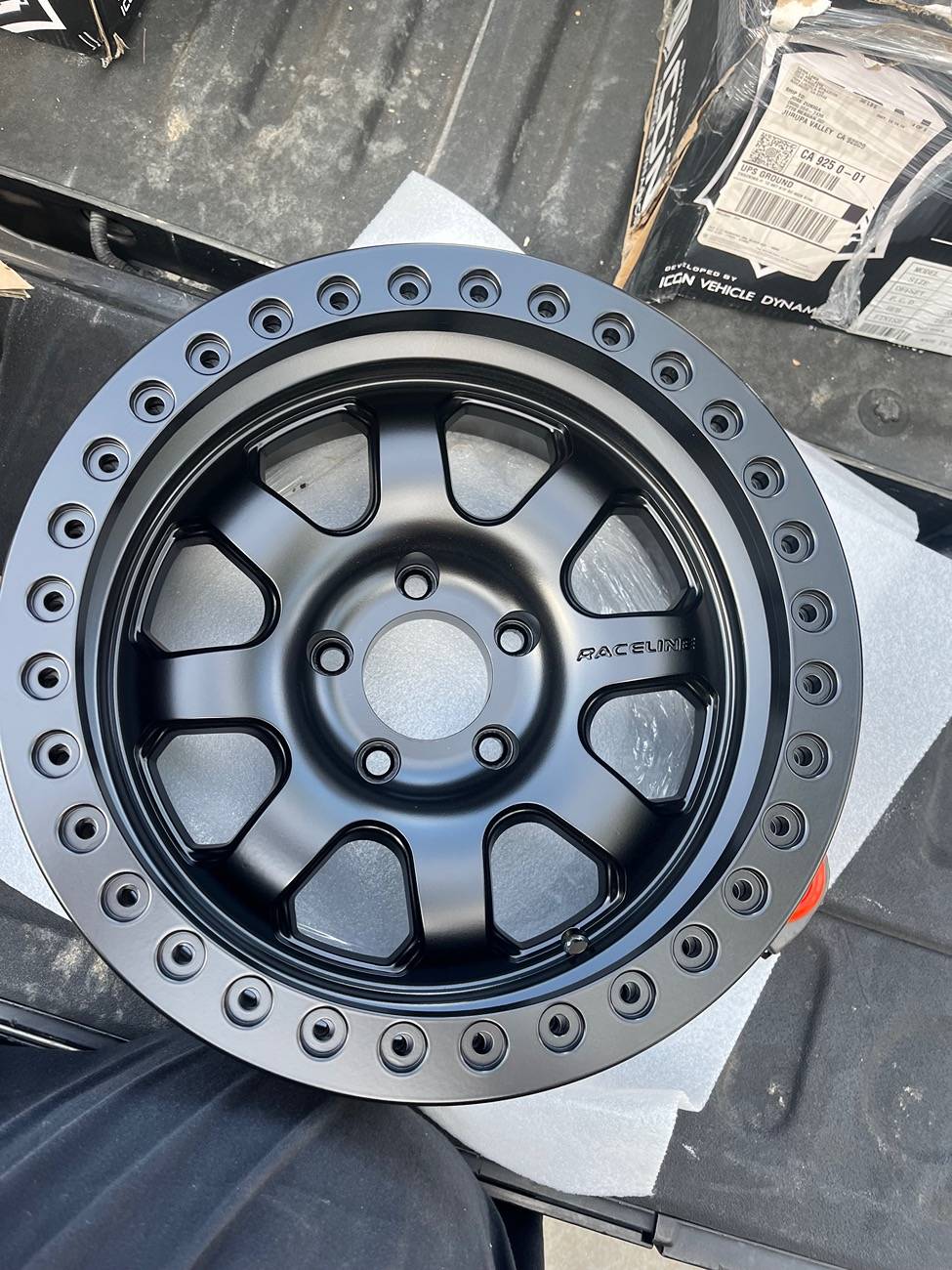

Hey pros
i have a set of beadlock avengers
the casting says 17x7.5 but I can’t even find a 7.5 on their site
they measure over 8” wide fron inner wheel to bead lock face.
wondering if anyone knows if all their castings are 7.5 and then they weld on the beadlock face To to 8+
I want to run 38x13.50 but worried about wheel width
any thoughts here?
thanks

The same as my stock beadlock capable. 7.5” standard inside mount, or 8” using the true beadlock side…. Quite a squeeze for 13.50’s.

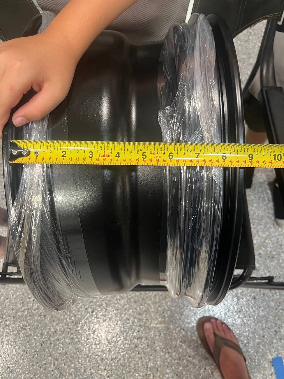

Well I realized I was measuring from inner on one side and bead lock face surface on the other
i needed to bolt on the beadlock ring then measure.
much better 🤦‍♂️
I think I’ll be good since I have to run 1/4 beadlock ring spacer….probably lol
Jeep Wrangler JL Raceline avenger beadlock size question IMG_1969

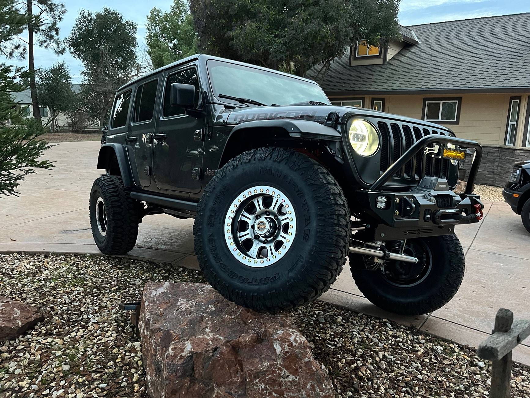

I run Raceline Monsters which are very similar to the Avengers. They are 8.5” wide and work perfectly with my 38x13.5 Patagonias. The Pats do not require a spacer to mount the ring.
Jeep Wrangler JL Raceline avenger beadlock size question IMG_4405
