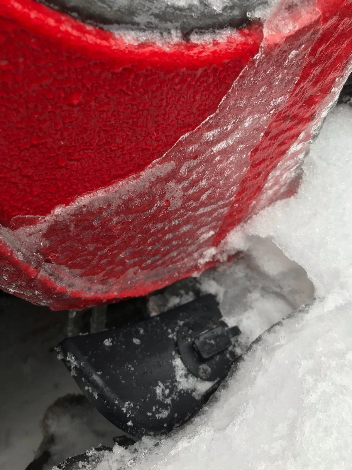

I keep a Battery Tender on mine, too, but mine lives in the driveway just outside the garage, so I mounted the tender inside the garage and ran wiring outside to near the Jeep. On the Jeep, I attached a covered, flush-mount SAE plug to the flat plastic shroud just behind the front bumper with wiring from that plug to the battery terminals. Works really well.
Jeep Wrangler JL Battery Tender Hook Up IMG_5407
Jeep Wrangler JL Battery Tender Hook Up IMG_5409
