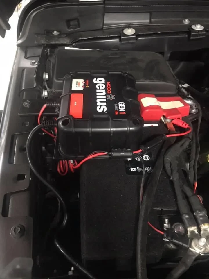

foxswimmer
Jason
Jun 14, 2019
70
68
Raleigh, NC
'20 JLUR, '04 Mazda3, '13 Sienna (because kids)
Thanks Andy I'll give that a shot. Now I just need to confirm that its an AGM...
Take a peek at your battery but this is what mine looks like on my 2020 JLUR with the tow package. Part number BBH7A001AA, and you can see 'AGM' in the upper right of the battery label.
Jeep Wrangler JL Best battery tender IMG-5702
