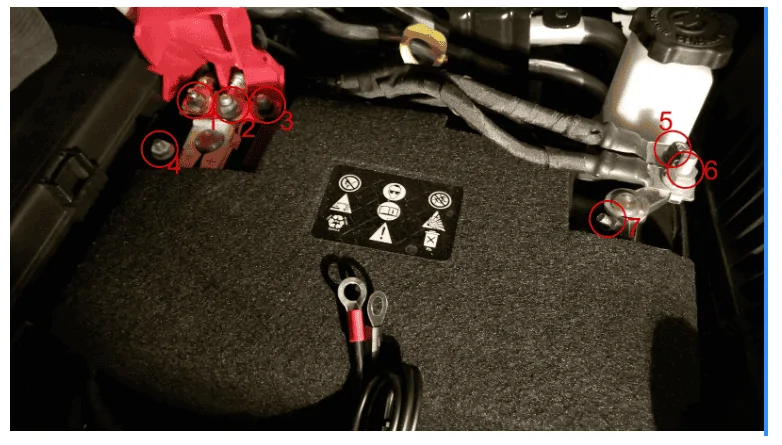

When hooking up the battery tender (I also use a NOCO10). There was a lot of discussion about where to hookup the Negative. I apologize to the originator of this photo for not remembering and being able to provide proper credit.
When using a battery tender/maintainer the tender/maintainers red clamp goes to Main Battery Pos. terminal and the tender/maintainers black clamp goes to either #5 or #6 in the picture below. #6 is a a larger diameter threaded stud so I go with #6.
The reason for this was that if you hookup to #7 it could cause problems for the IBS system.

I hookup the neg at the grounding bolt on the engine housing. Which, I think, is the same as hooking up to #5 or #6, which ever goes to the frame.
