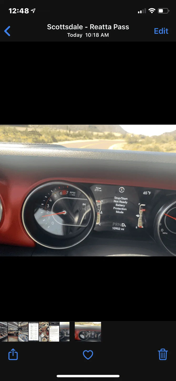

I have had my 2019 Jeep JL Rubicon in 5 times in the last 6 weeks for the same Battery Protection Mode issue. Twice the dealer claimed it would fix itself if I drove it more. I drove from Scottsdale to LA and it did not resolve itself. You obviously have a design flaw based on all these responses and I am sensing the dealer just hopes I go away. I addressed this issue at just over 9000 miles and have added over 1000 miles per the dealerships instructions. I want a resolution because it was not fixed as I left the dealership and I was assured it should fix itself in a couple of days.

JLU in my possession for 7 days and had same issue (yellow A with alert exclamation) when I took possession. Dealer said was just a low battery and with some minimal driving it would charge up and alert would go away. After a week of driving and 500 miles, alert was still on. Brought to service dept today and auxiliary battery failed test. Replaced with new battery and all works fine now. Hope this helps others with similar issues.
They replaced my battery after the 4th visit and it worked fine for two days until the Battery Protection Mode issue returned.
