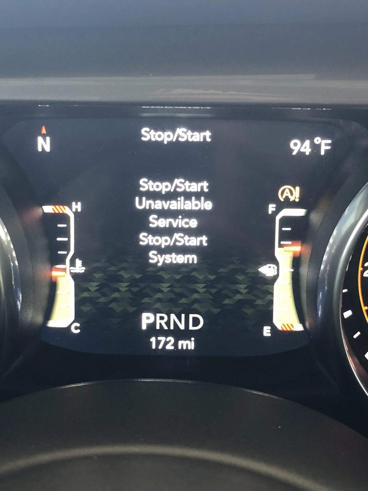

Forgot to mention that while studdering at idle, I got the message “ start stop unavailable. Service start stop system”
You mean "shuddering"?
It may be possible that the relay in your fuse box could have become loose because of the shuddering. They may be two separate issues otherwise. The shuddering is more serious issue in my opinion.

My JLU Sahara is in the shop after 2 days of ownership for similar start/stop issue. Mine would shudder real bad at idle and would even shudder at freeway speed. Disabling with the the dash button made no difference. Dealer says it’s a problem with aux battery but I have my doubts. Hope to have an update today.

couple days ago i got the same message "start/stop unavailable", took my jeep to the dealer this morning around 9am and picked it back up the same day. The problem was fixed and now its running good as new,they say it was due to a loose battery terminal.

My battery is good. The problem is a bad relay. Part is being ordered and will be received in a few days.
My part arrived and was replaced.
I drove the car to work and on the 6th stop when it started, I got the alert to service start/stop back.
Called the service advisor, and he asked to bring the Jeep back for them to diagnose the problem in detail. On the way to the dealership, I counted again the number of stops, and again on starting after the 6th stop, got the error.
So somehow, the 6th stop is the where it gets jinxed. I reported my observations to the security advisor and he noted it.

Service Start/Stop problem is fixed
Here is the diagnosis and fix:
"Performed a resistance test on circuit T760, found that the circuit test 'out of limits". Inspected wire harness and found broken T760 circuit wire causing to have an open. Performed wire repair by soldering and heat shrink wrapping. Test drove the vehicle and no further problems found at this time".
