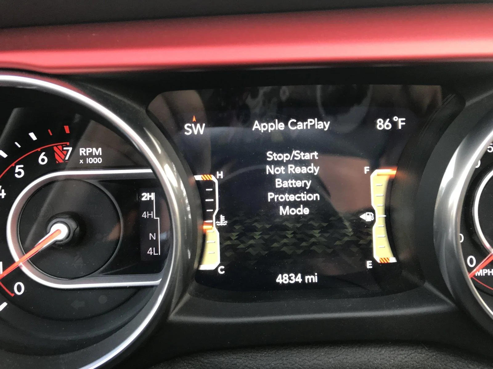

My 2018 Rudicon has been doing the same thing. It has been in the shop twice already and is schedule to go in again. Already replaced the alternator and a fuse. Battery protection keeps coming on and the battery volts go down throughout the day. Still no answers.

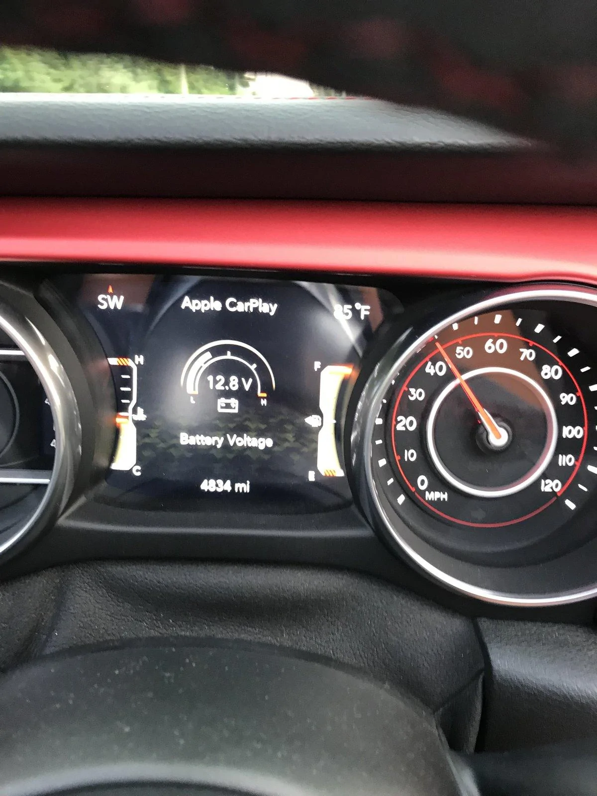

My voltage used to run low all the time and would ramp up on slowing down but now it runs 13.6-14.0 most of the time has never given me that error message

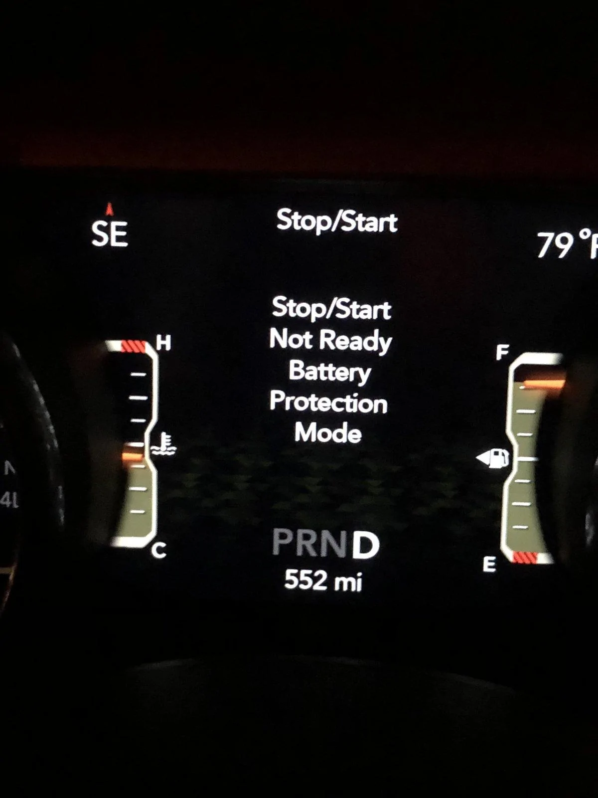

I've gotten this screen a couple times..
anyone else have this issue? I used a multimeter to check the battery with the vehicle off and am showing 12.73 volts. Was hoping someone had some info before I take it to the dealer. Thanks!
I would ask, if there is someone who doesn't have this issue ))) bought mine 4 days ago and same problem Start/stop error and ESS error sign). Now I have to drive to Chrysler Teterboro.. This is ridiculous, a car has just 500 miles on it and already needs to go back to Service. This is a common issue and I see posts about it from beginning of 2018. And they still sell these cars without fixing it. Car is far not cheap car, I paid almost $50k for it... This is not possible on any Toyota or Mercedes. 4 days and my first disappointment, let's see whats next.

Good news is that it is neither a defect nor an error message. It just means that it put the start/stop on hold because it is protecting the ESS battery. It will go away once the battery gets its full charge back subsequently. Take it out for a long drive.
An error message or a defect in wiring for ESS comes with a sound/chime and with a message to service start/stop system. The message remains throughout the time till you shut the engine off and start again.
BTW, did you drive 500 miles in 4 days? If so, then your battery may be bad or not charging well.

This is not necessarily true, I've had this error along with the ESS errors occurring and i've had everything including the batteries replaced and it is still doing this. It is now officially a lemon and being bought back by FCA.

Mine always gets the issue on long hot trips. Never has a problem starting though. Oddly enough the voltage goes up when coasting in this mode almost like on throttle it’s coasting the alternator to save fuel.
There is a separate message for battery too low for ess.

Forgot to mention that while shuddering at idle, I got the message “ start stop unavailable. Service start stop system”
JLU in my possession for 7 days and had same issue (yellow A with alert exclamation) when I took possession. Dealer said was just a low battery and with some minimal driving it would charge up and alert would go away. After a week of driving and 500 miles, alert was still on. Brought to service dept today and auxiliary battery failed test. Replaced with new battery and all works fine now. Hope this helps others with similar issues.

Be cautious, i had my aux battery, fuel pump and PCM replaced all at different times and the issue continued to occur.

Read other posts. This has already been explained. It’s a defect. Quick fix by dealirship. They just need to change one cheap part. Hundreds of cars has this issue. It’s is an error message and it has nothing to do with short or long trips, or battery. Mine started to work fine by itself after 2 days, like nothing happened before. If it happens again I will take it to dealership, too.

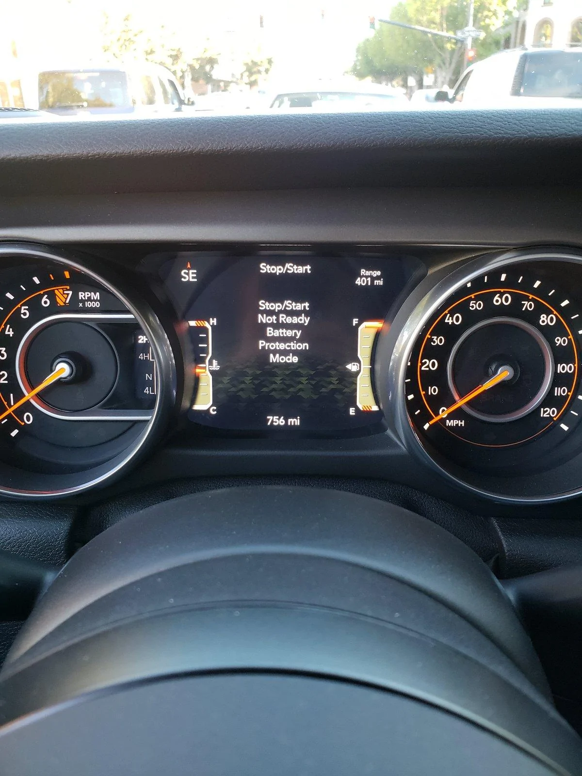

I noticed last night at a drive through that the start stop didn't work. It was working today until this afternoon and I'm getting the message that it's in battery protection mode. I've only had this JL for three weeks and only drive it on the weekends. It has 756 miles and there's already an issue.
