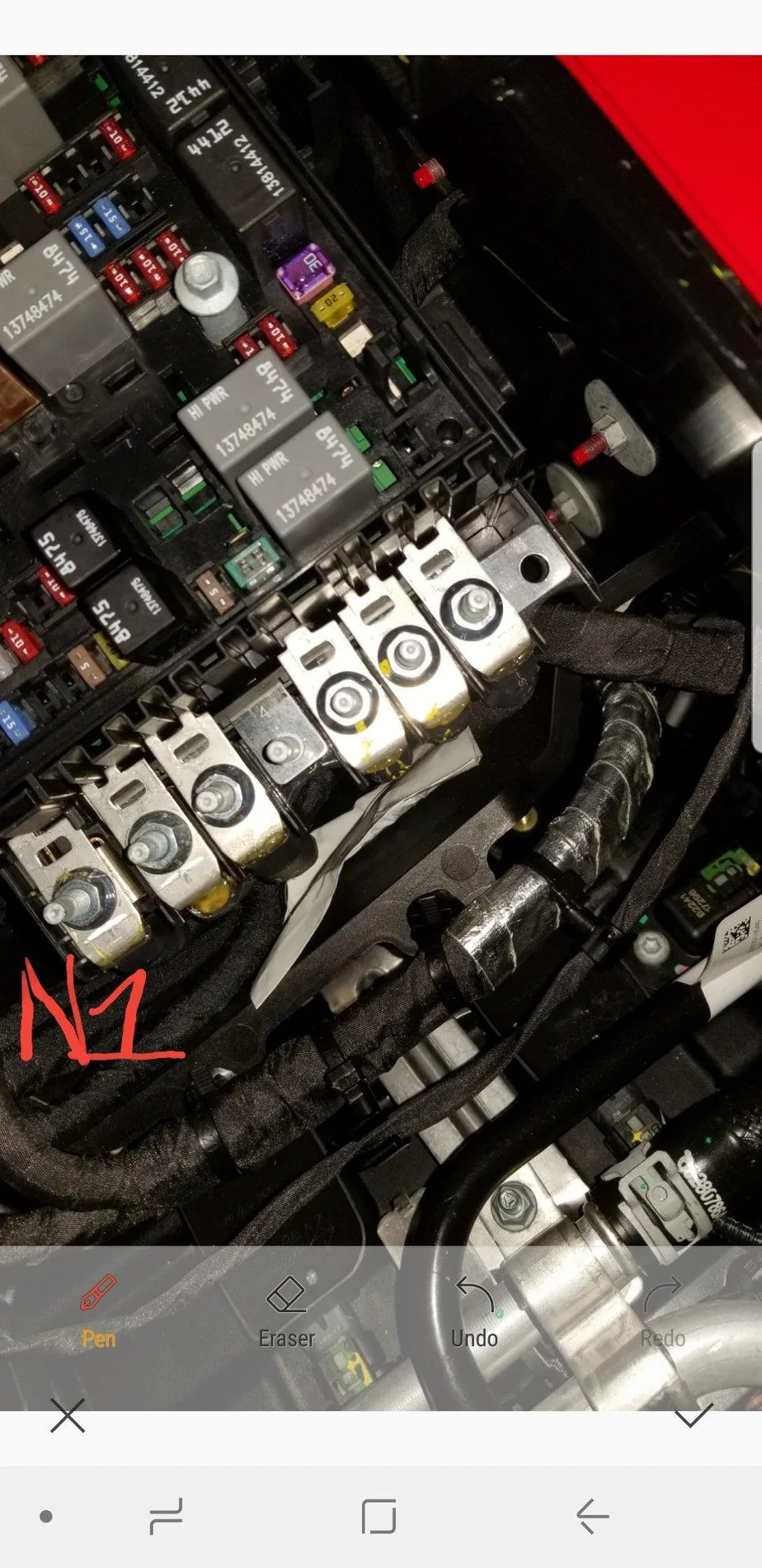

So I trickle charged the main battery and then using terminal N2 I fully charged the ESS smaller Battery..
Frank ....Please, post a pic of "N2" and provide more info on this N2, it's location.....

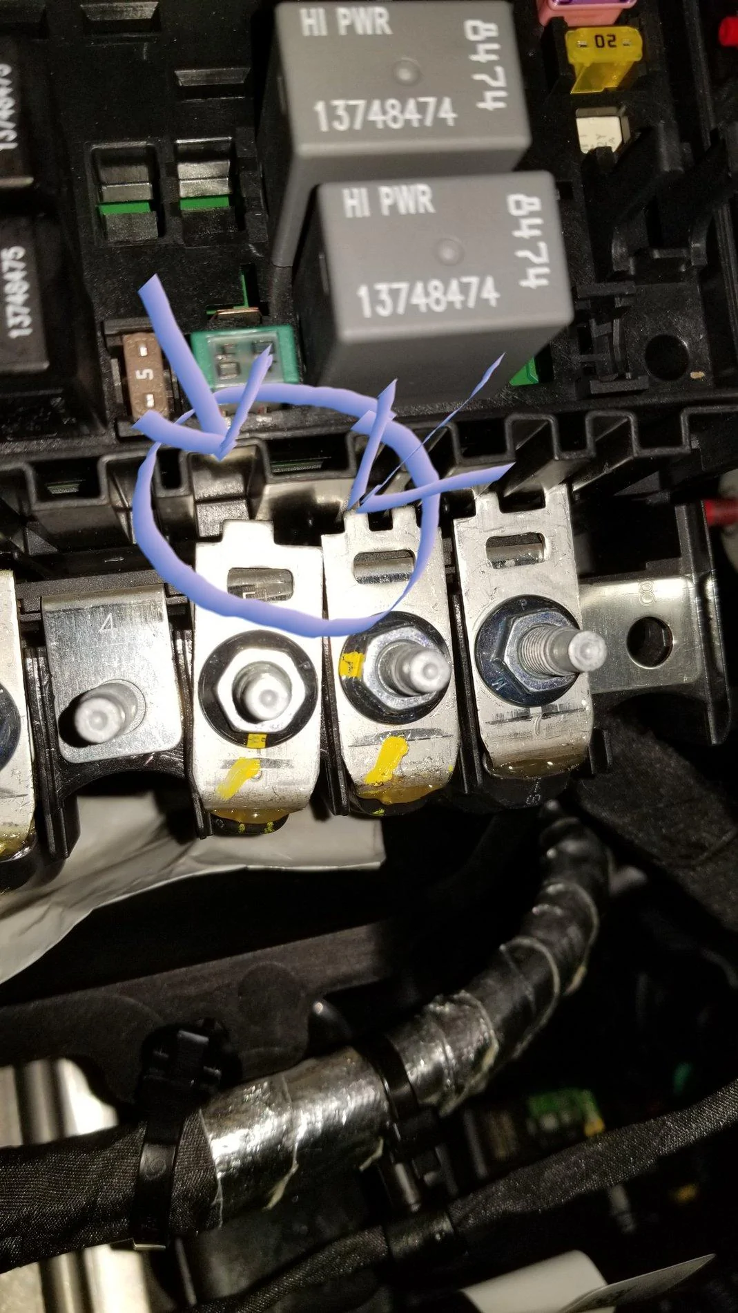

Located on the PDF outputs. Power distribution and fuse box, in another post i had touching terminal see pix

Saw your pics. Thanks!
So you took positive cable of trickle charger and hooked it to N2 and then connected other trickle charger connector to .... ?

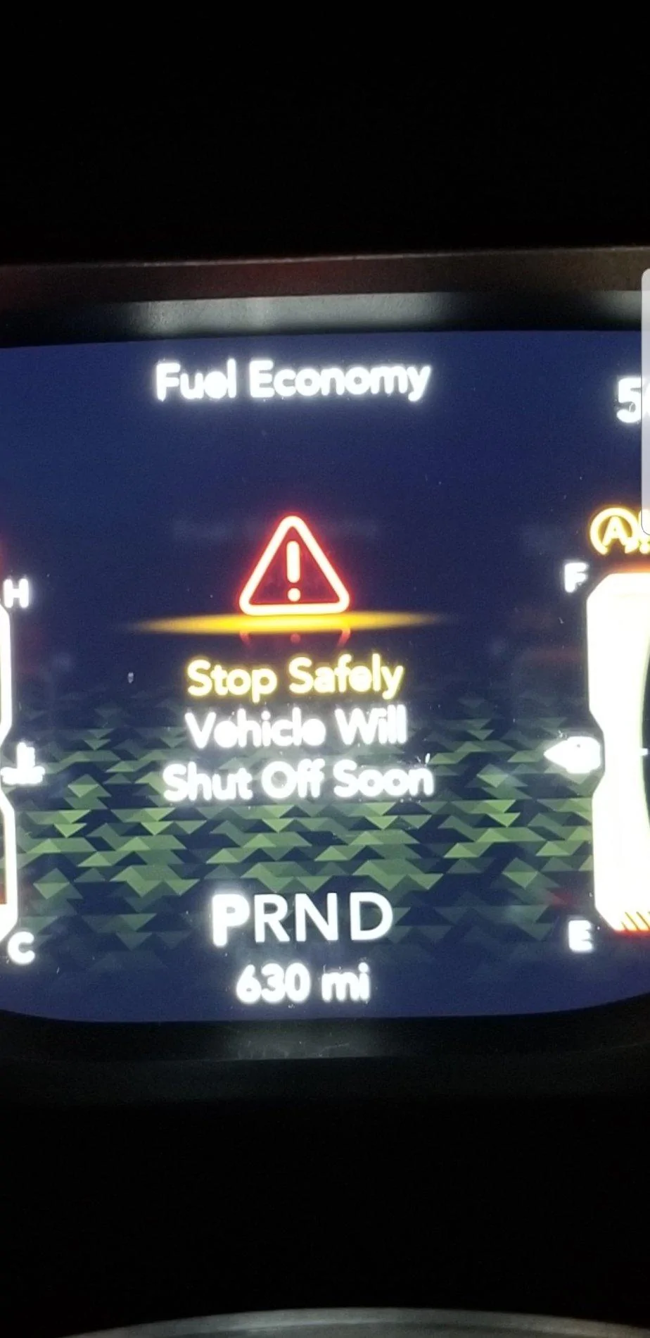

I was getting 2 diff voltages on N1 and N2
According to the fusebox lid shows one going to the ESS stop start battery.
So i charged both, using same battery negative as it uses chassis ground also.
Took many hours to charge that also...
If N2 voltage gets too low you see this dreaded screen on center dash. You will need a tow at that point
and better learn how to get it outta park manually! No power, will not allow you to get to neutral.

Did u see my pix on battery distribution fusebox loose. One terminal was touching another.
Also charged both batteries overnight.

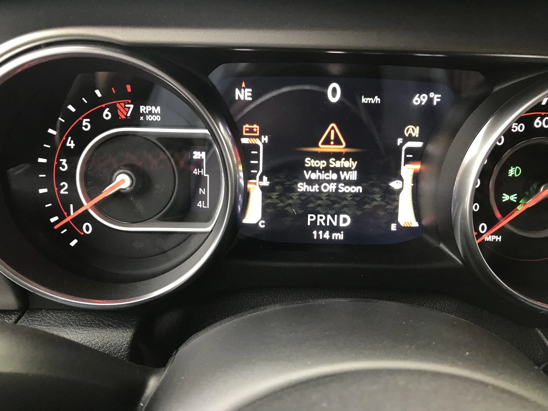

On the second day, I received the following message: "Stop safely vehicle will shut off soon." This happened right after I adjusted the temperature settings. I pulled over and shut the vehicle off and restarted. The message did not reappear and everything seems normal. Any suggestions?

I checked the distribution fusebox terminal and fuses and everything looks good.
