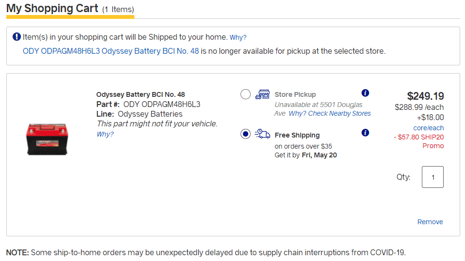

Not sure which size battery you have (48 or 94R), but NAPA currently has 20% off. If you sign up for rewards, this will qualify for 2 x $5 rewards.

I got it swapped out after trying to leave work and having to jump it off the fork lift LOL. 200+ for a damn battery. AGM non AGM, for start and stop or not start and stop….. WTF. Anyways yeah she is good now. Afterwards all my apps and crap on the Uconnect was gone. They ended up coming back. But shit hey my WiFi works again!!!! That shit hasent worked in several months. My Rubicon startup flash screen is gone for whatever reason but whatever.
