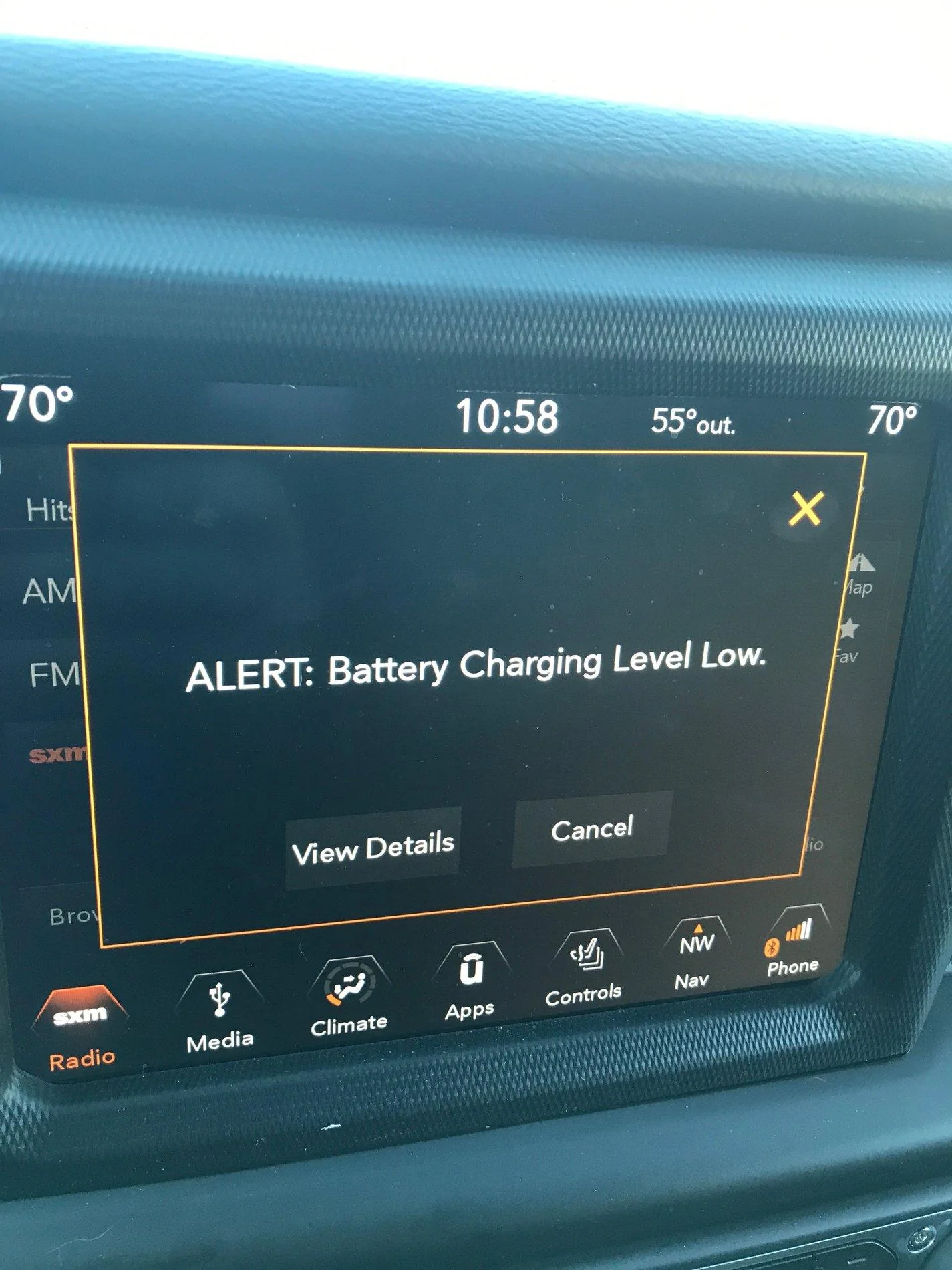

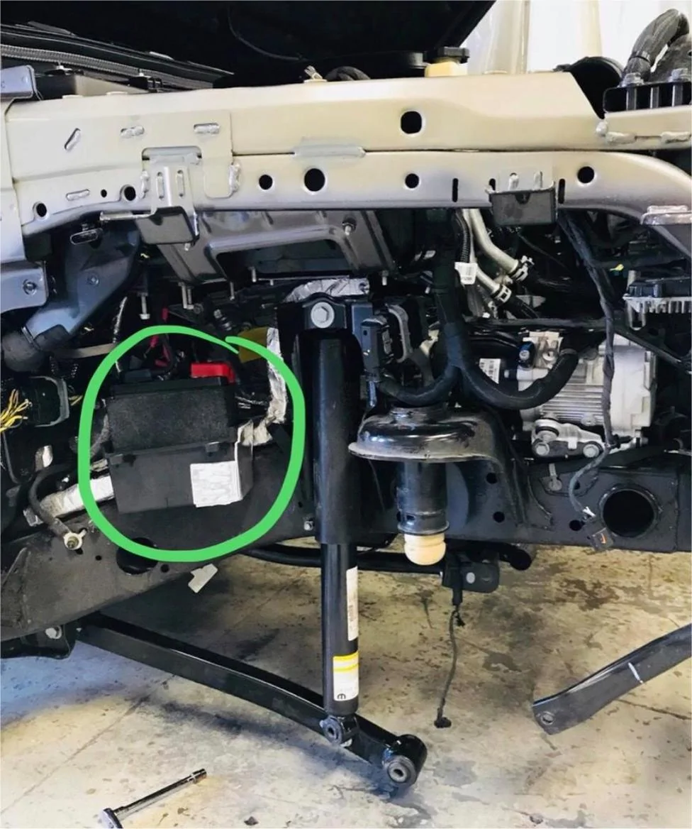

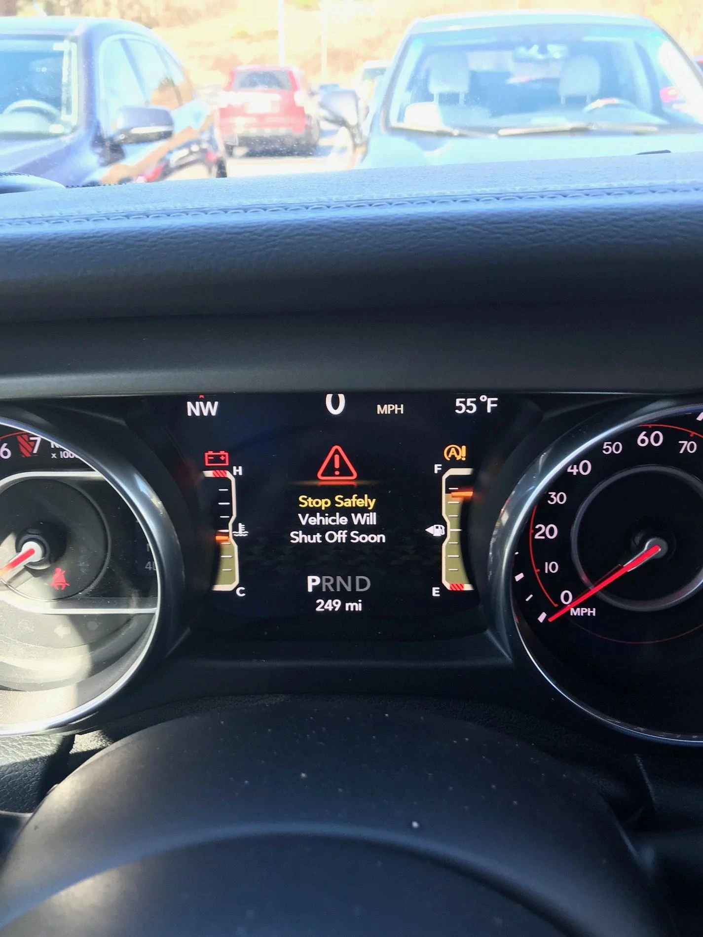

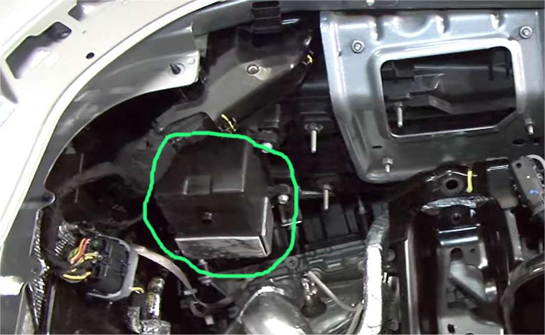

Are you sure that they did not also replace the "Power Control Relay Circuit? We have had two other forum goers that I know of post here that the issue they had, like you, required replacement of the Power Control Relay Circuit.I had the same issue. At first, intermittent then was there all the time. Called roadside and they towed it to the dealership (BTW, roadside is 5 years or 100K miles, I didn't know it was that long). It was a loose ground, from the auxillary battery, which is under the main battery. Posting in case it happens to another forum member, may save a tow and time wasted.![]()
