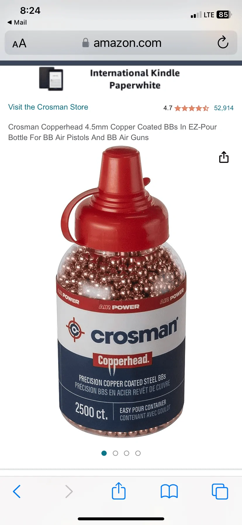

I have my tires balanced traditionally when initially installed then as soon as they start going out of balance I break the bead and add exactly 4 ozs of copper coated steel BB’s per tire while leaving the weights in place.
This is hands down the best balancing method I have ever used. I’ve done it this way for the last three sets of tires (2 sets of 35’s and now 37’s).
The only downside is you can hear the BB’s fall when coming to a stop.
The tires run perfectly smooth regardless of speed.
My current 37’s run perfect even though some of the stick-on weights have fallen off.
Best part is $15.00 will buy enough BB’s to balance numerous sets of tires.
Zero effect on airing up or down.
Edit: these are the BB’s I use
Jeep Wrangler JL Balance Beads A8017F51-4C9C-4197-8AF7-9783453AB09A

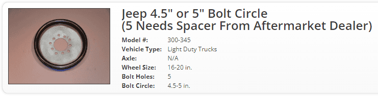

These work better than tire beads................. https://www.centramatic.com/
Are you using these? I always wanted to try them, but I know they're more oriented to semi-trucks.

Have you used these or are you currently using them? I'm concerned about them trapping mud/debris when used offroad.
Currently using them............Does not trap mud/debir when offroad.

really?
do you happen to know what P/N you're using? because Centramatic said they didn't have anything that would fit the J**ps when i called them due to interference with the brakes,..?
