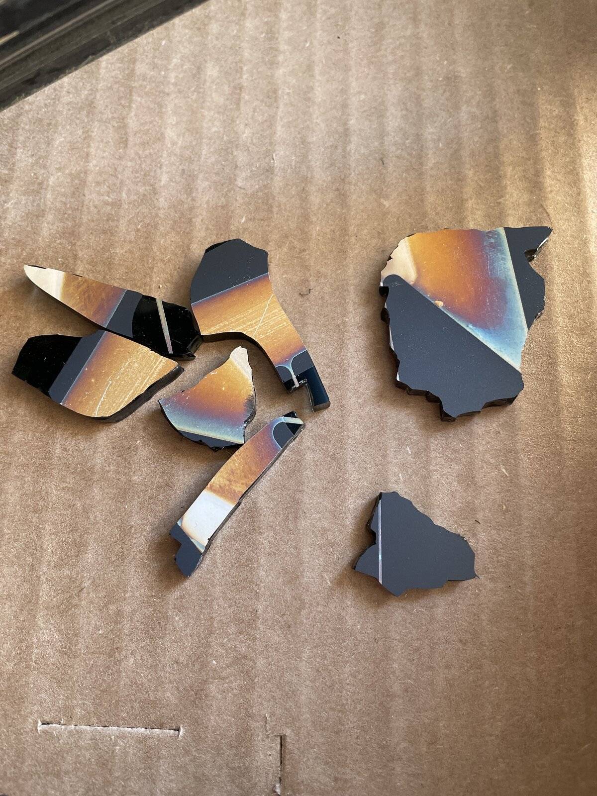

Just had this happen to me and was a little surprised that I found this thread. I was standing near the rear of my Jeep with the engine off parked on a level surface when all of a sudden the window just exploded into a million pieces. This is frickin nuts!
Just finished cleaning up all the glass. The glass around the defrost wires crumbles like dry clay and the part in the window looks like it got very hot and no I didn’t have the rear defrost on. It’s 80 in Phoenix today. See pic. This clearly looks like a factory defect to me.
