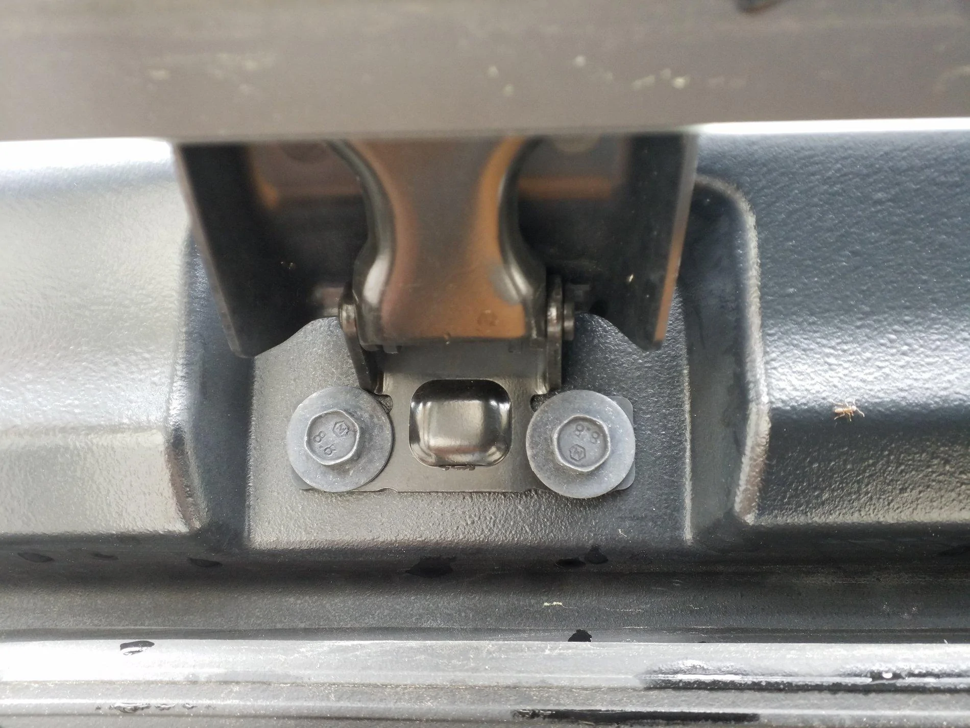

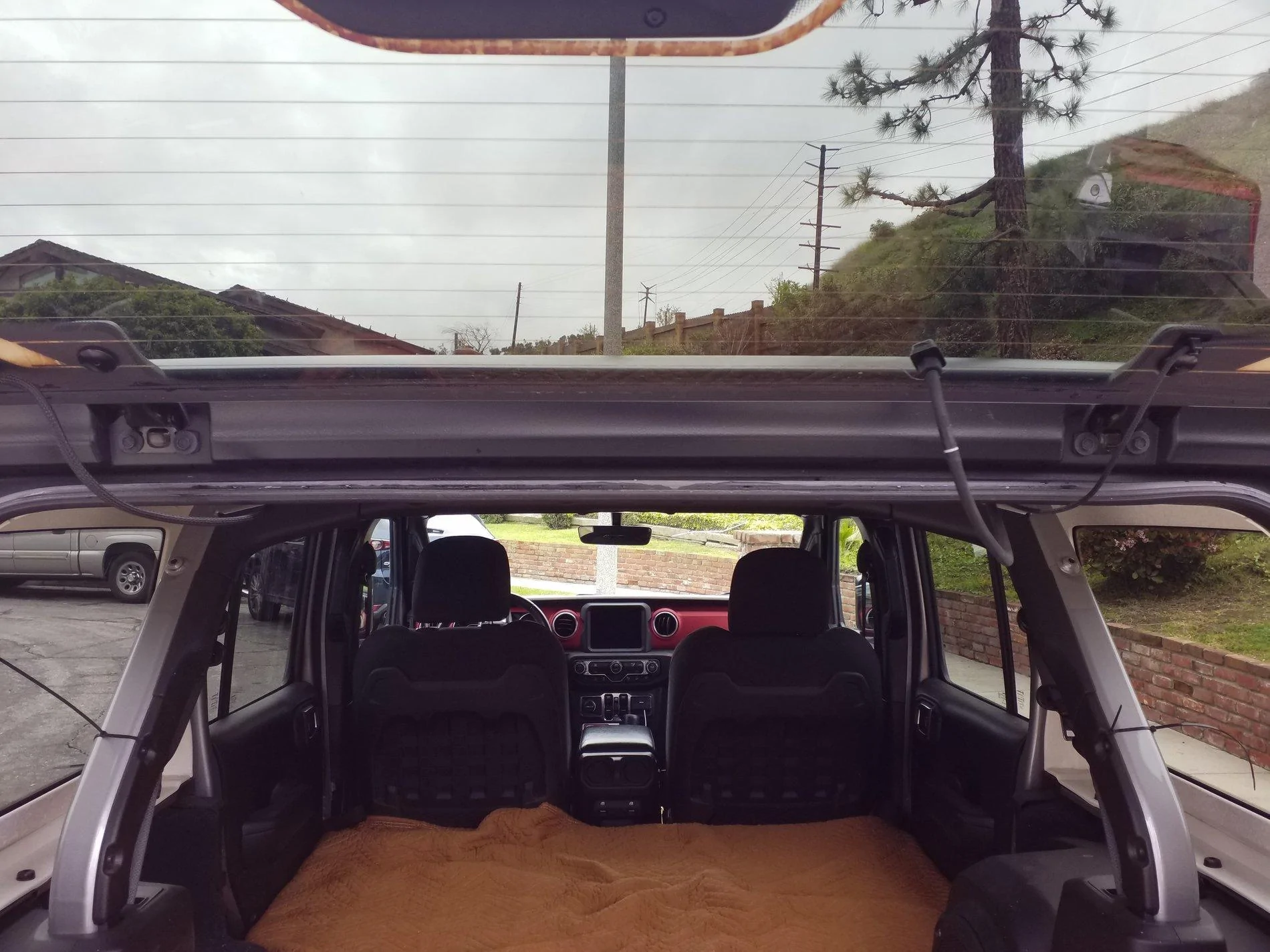

I went out to look at my rear glass hatch. Surprisingly, the glass looks very rigidly mounted. I would have expected to see some rubber sandwiched in the glass mount side.
Heres some pix of the hinges. When everything is hard mounted, the axis alignment of the two hinges becomes more critical.
