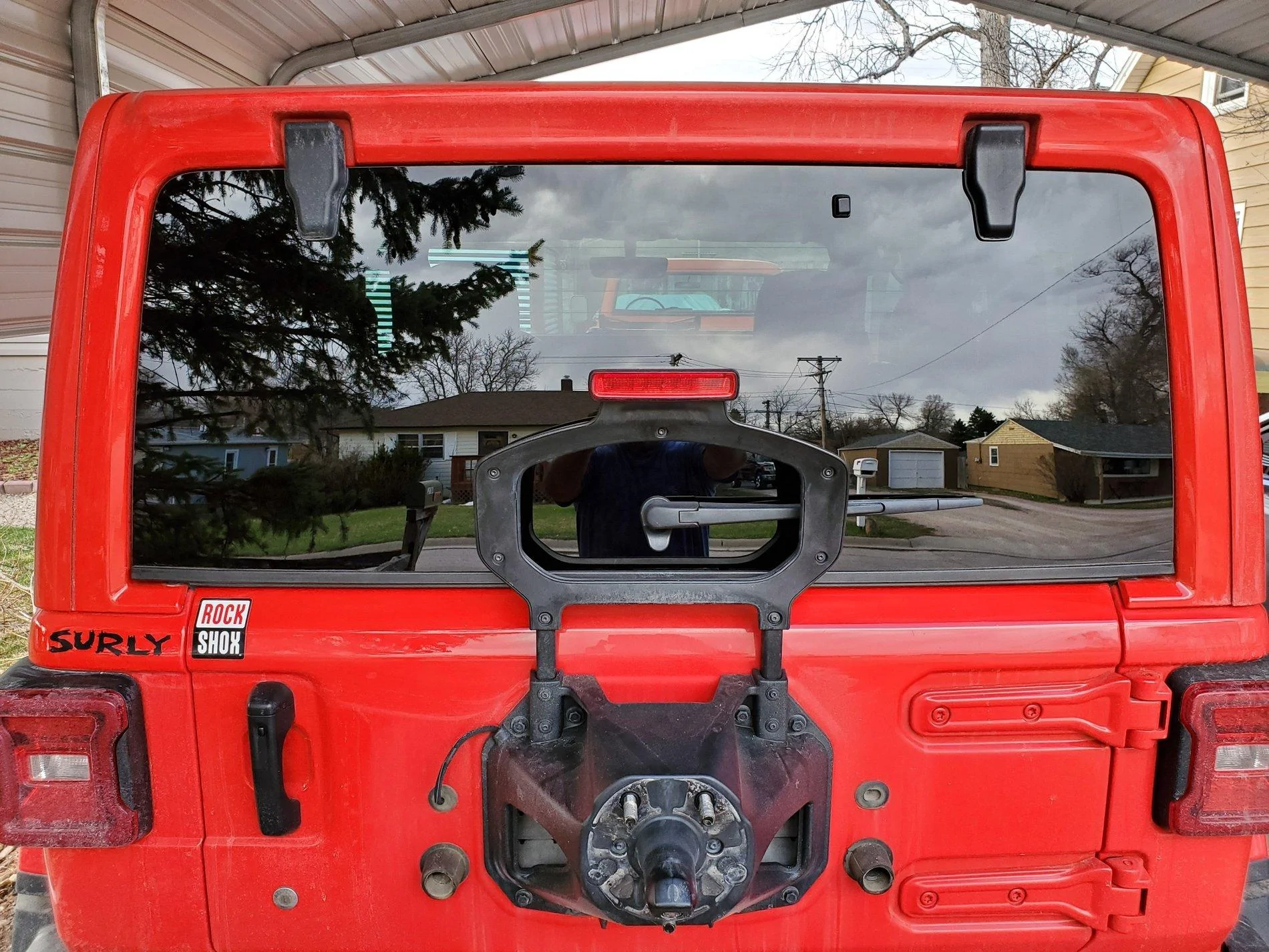

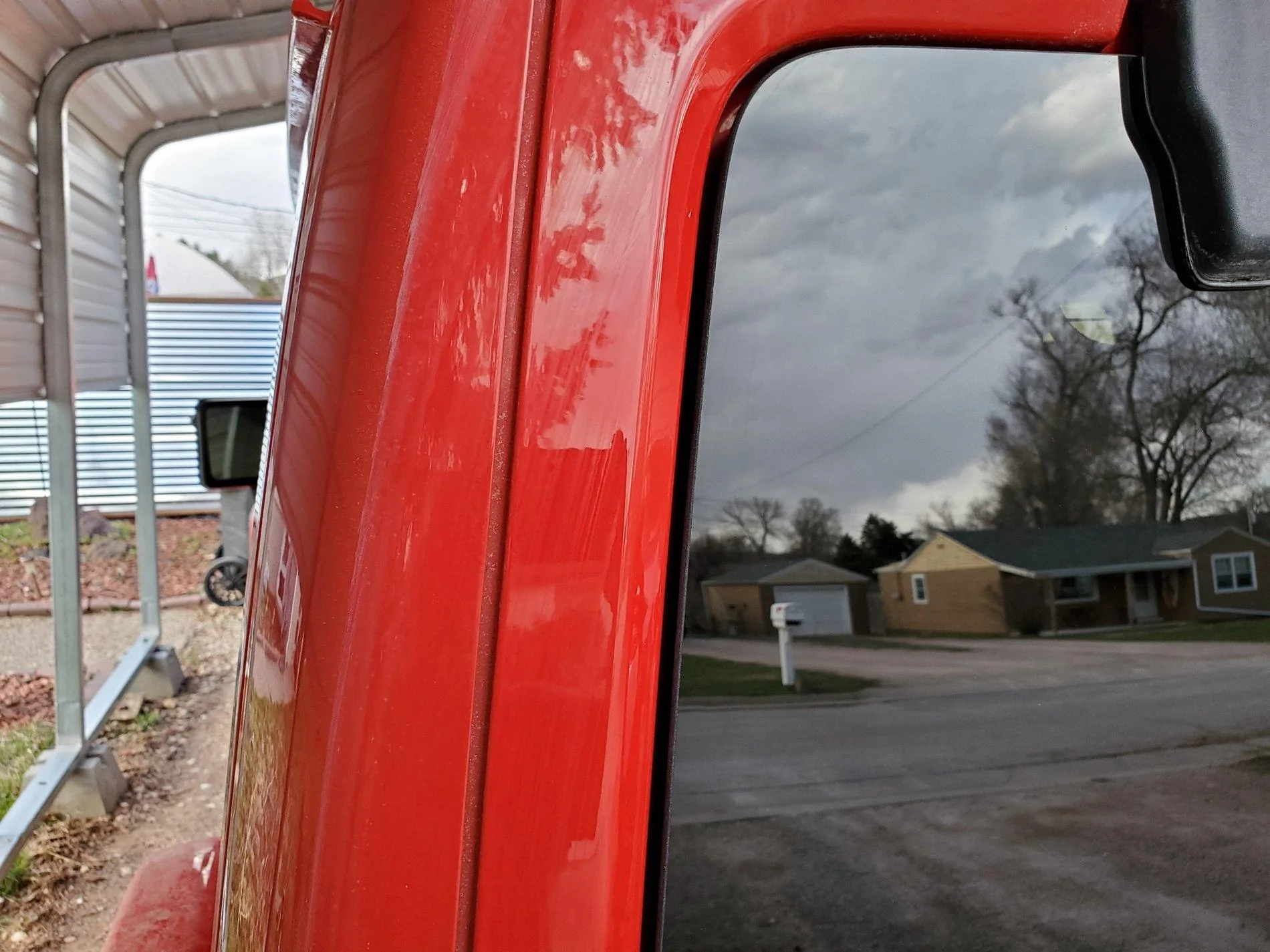

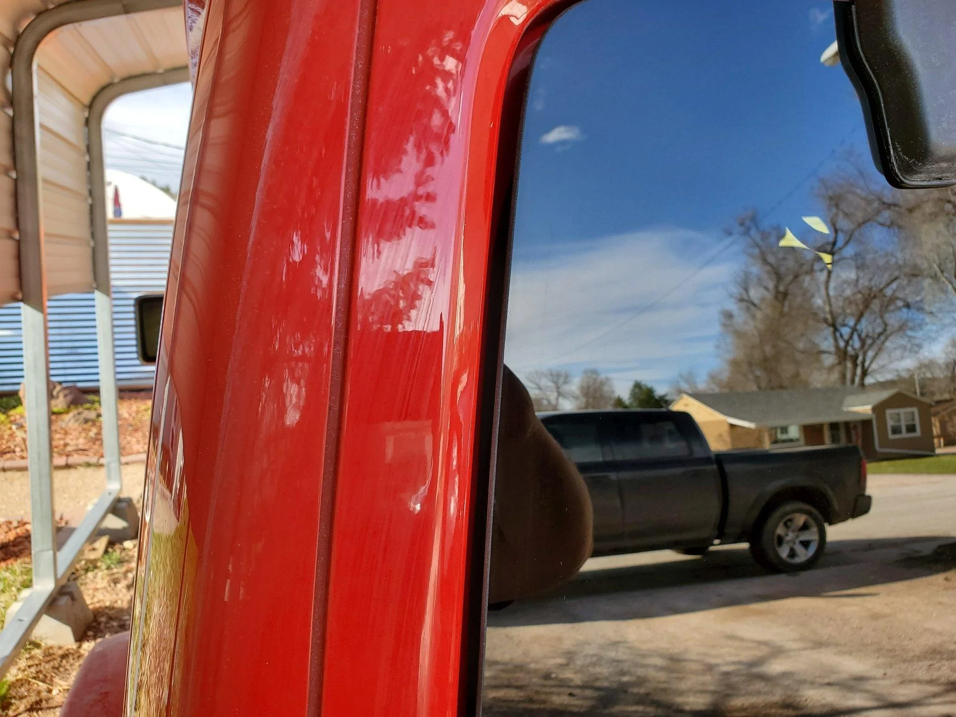

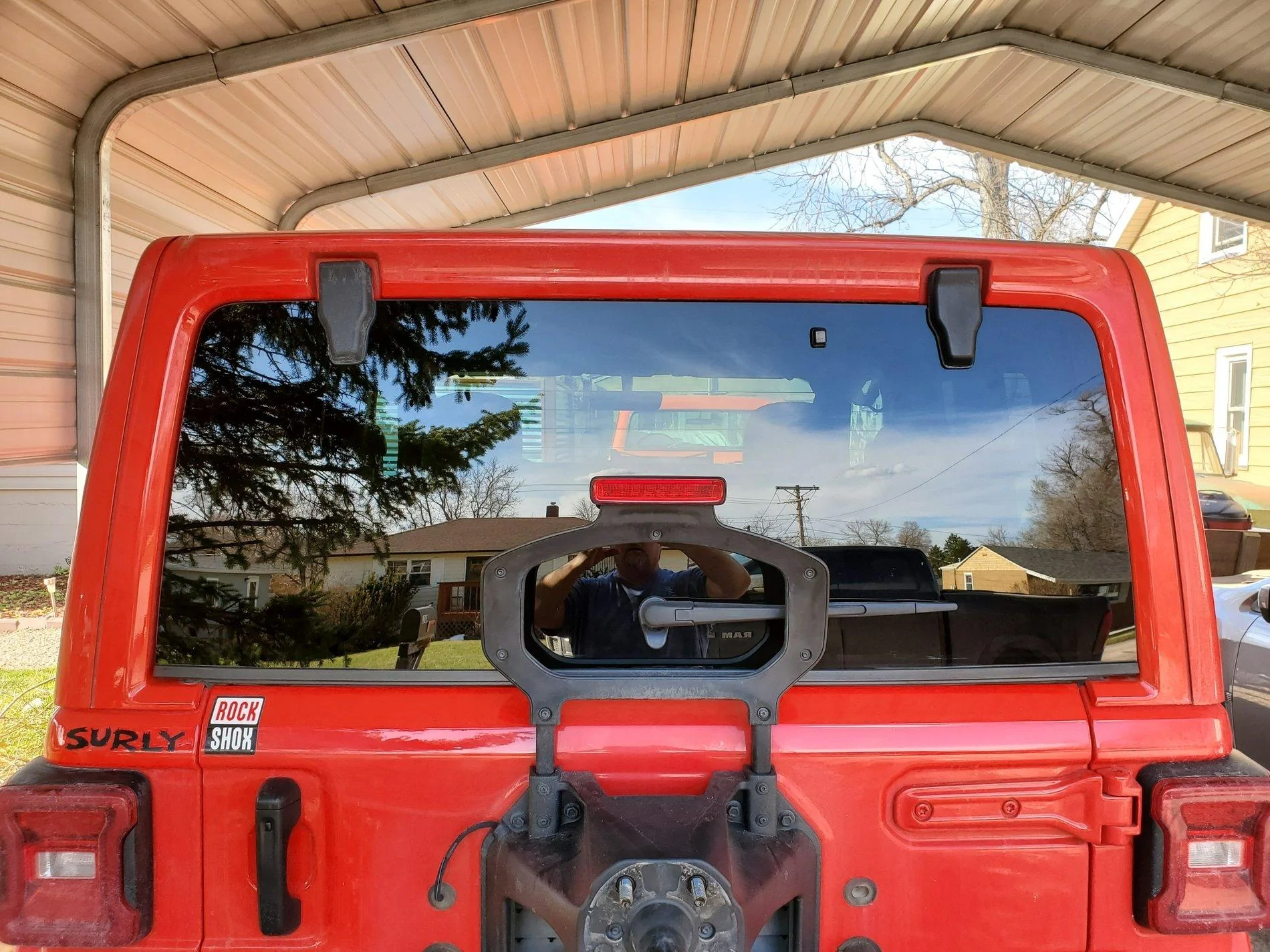

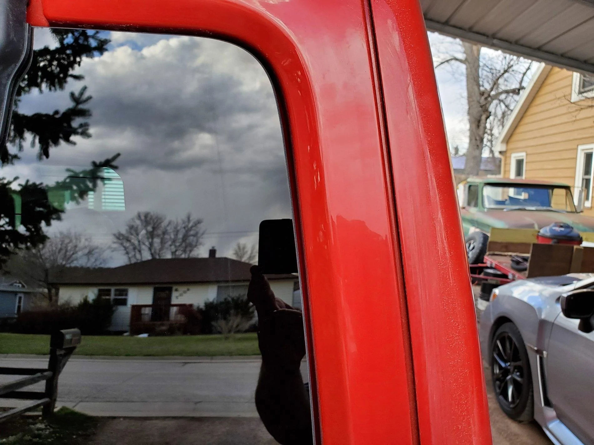

Ok...after careful review in the driveway, I had to race back to Safelite before they closed. Keep in mind they have done the install each time (all three).
As soon as I got home I could see it. I don't know why I couldn't see it before. 1/2 gap on driver side, ZERO gap, (resting against frame) on passenger side. They installed the glass each time with out centering it in the frame. Hinges look like a slight 20 degrees to the right. Took it back and they adjusted hinges and center glass in frame....f@ck me. I really hope that was it? Thanks to all who offered advice, both silly and serious. You guys are the best!
Before they fixed it

After they fixed it
Jeep Wrangler JL Back glass exploded...again! 20200406_171613_resized
Jeep Wrangler JL Back glass exploded...again! 20200406_171624_resized
Jeep Wrangler JL Back glass exploded...again! 20200406_171638_resized
After they fixed it
Duly noted. If mine ever needs replacing...
Surely that was your issue. Glad you got it fixed!
