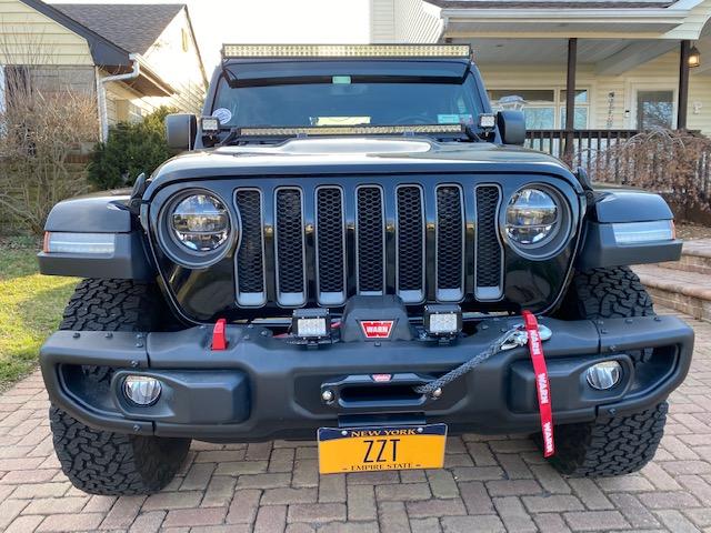

I did 4x KC on switch 3 and the other 4x KC on switch 4.
Mainly because I thought I might want to run the outboard wide angle stuff without the spots in the middle being on.
In practice, it'll probably be run everything all the time.
