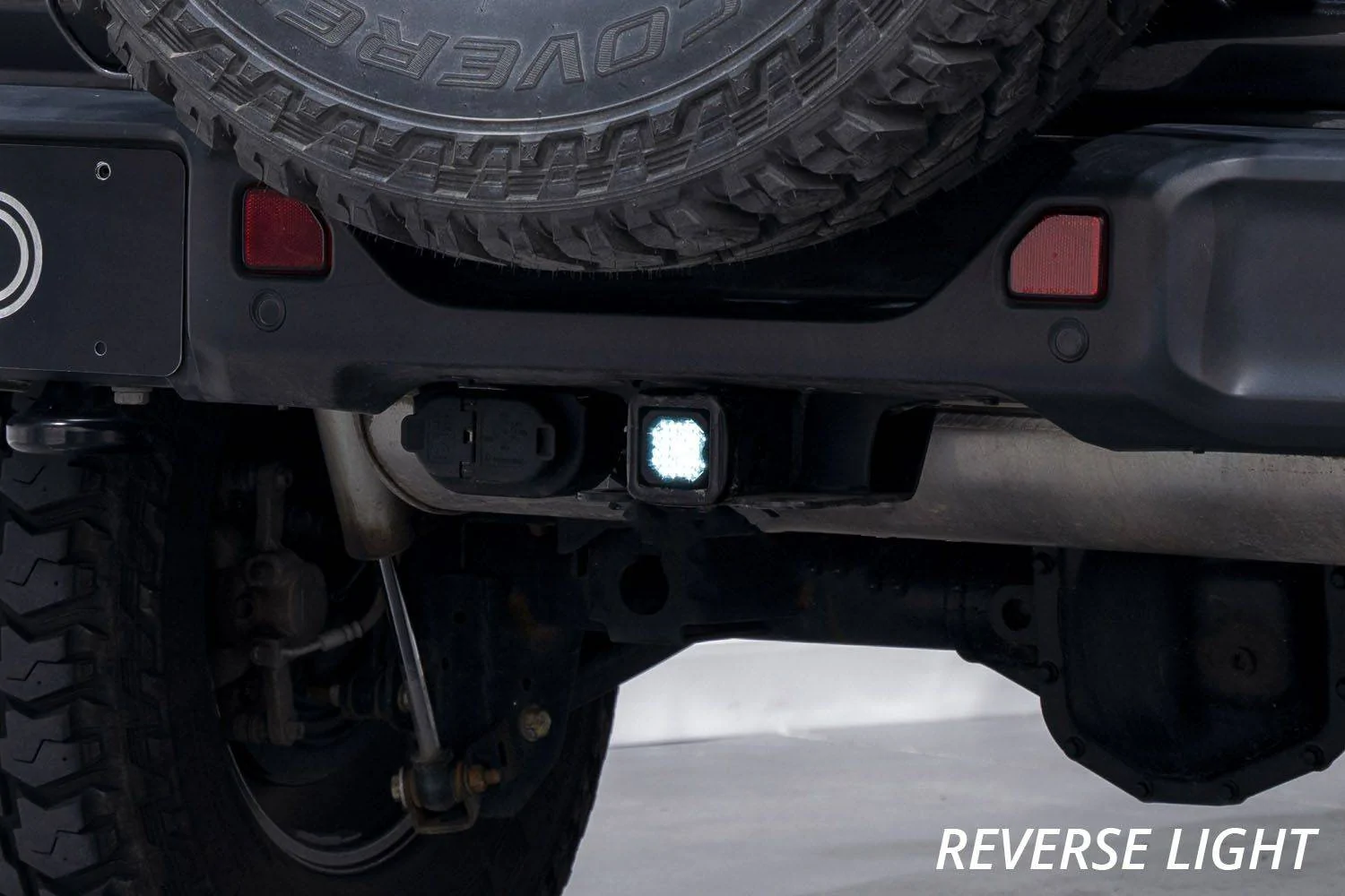

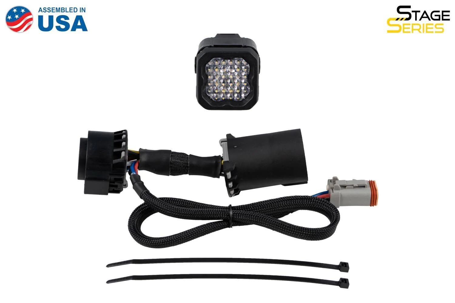

Ordered these to try.... Diode Dynamics HitchMount LED Pod Reverse Kit for JL:
hitchmount-led-pod-reverse-kit-for-2018-2023-jeep-wrangler.html
Jeep Wrangler JL Aux rear lighting plan 2018_jeep_c1r_hitchmount_studio_cropped_angle_reverse___labeled
Jeep Wrangler JL Aux rear lighting plan dd7420_ssc1_hitch_mount_pod_sport_kit_ss_us_1_1

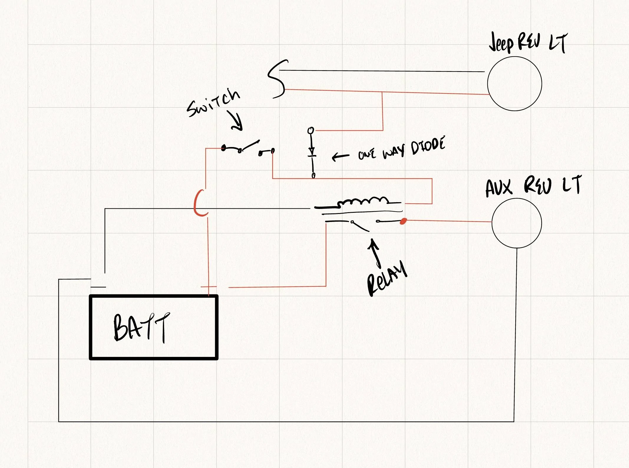

Not sure I am following. I want the lights to work with the tail reverse lights only when I throw a switch so they also come on when in reverse. Otherwise only the tail lights lights come on in reverse. I also want a manual override switch so they come on anytime I want.
You’d have to introduce a diode to avoid back feeding the factory harness. In theory this is sound, but do your own research as I’ve never actually tried it.
