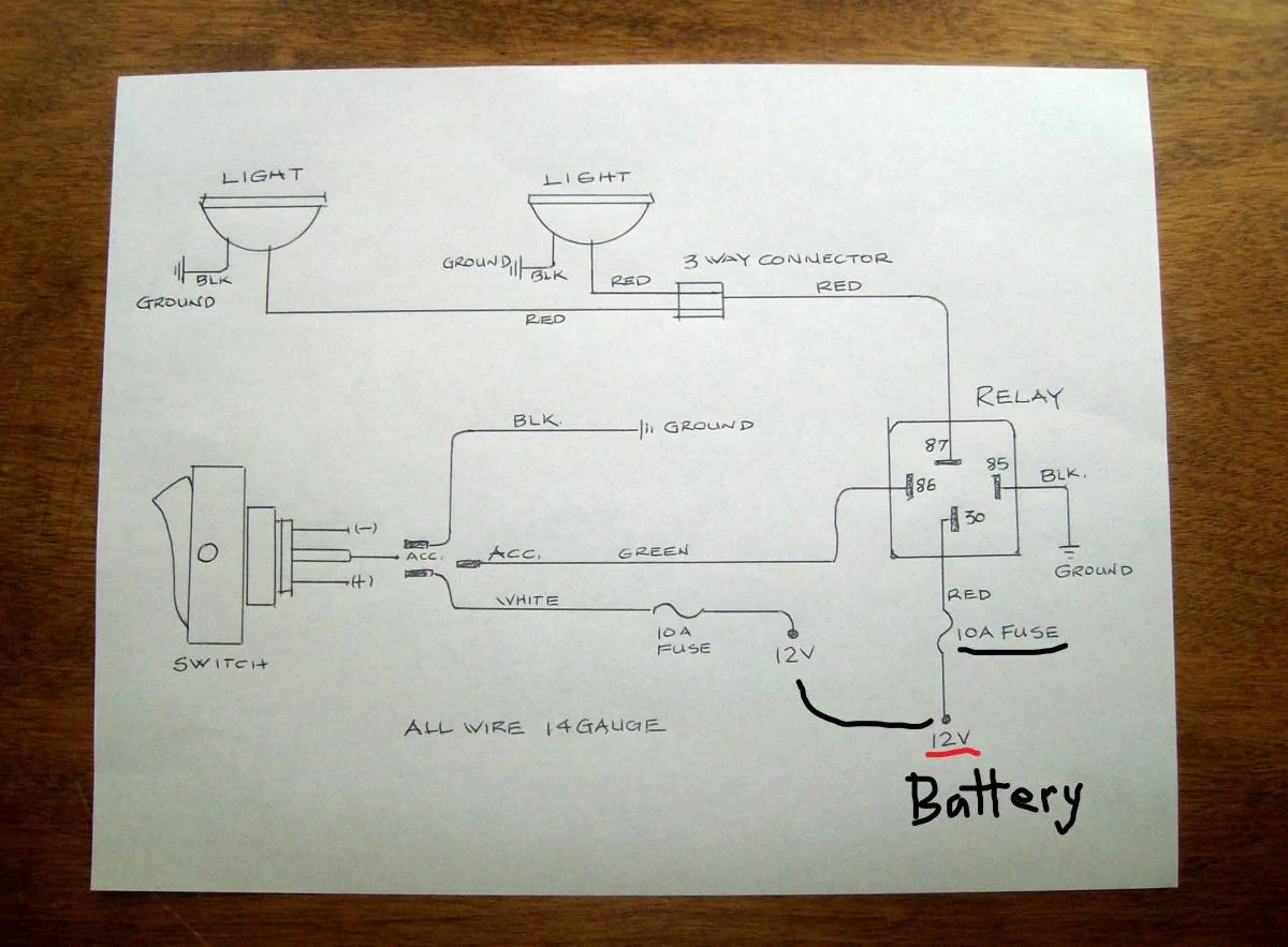

Are you talking about the electrical plug to your factory fog light? If yes, I would order/purchase a new factory plug for it and re-wire it back to factory specs. This will solve your problem with your fog light.
An aftermarket light bar: This is what I use, and it works flawless every time.
Amazon.com: Nilight - NI -WA 06 LED Light Bar Wiring Harness Kit - 2 Leads 12V On Off Switch Power Relay Blade Fuse for Off Road Lights Work Light, 2 Years Warranty,Black : Everything Else
There are other ways to wire accessories, this is the way I prefer to wire my accessories. Everything is under the hood, except for the switch. I generally mount the switch to the lower part of the dash, off to one side. You can mount the switch just behind the dash, out of sight. Depending how many amps your accessory is; The correct gauge wire, correct amp fuse and I also use loom over the wires.
Best of luck my friend.
