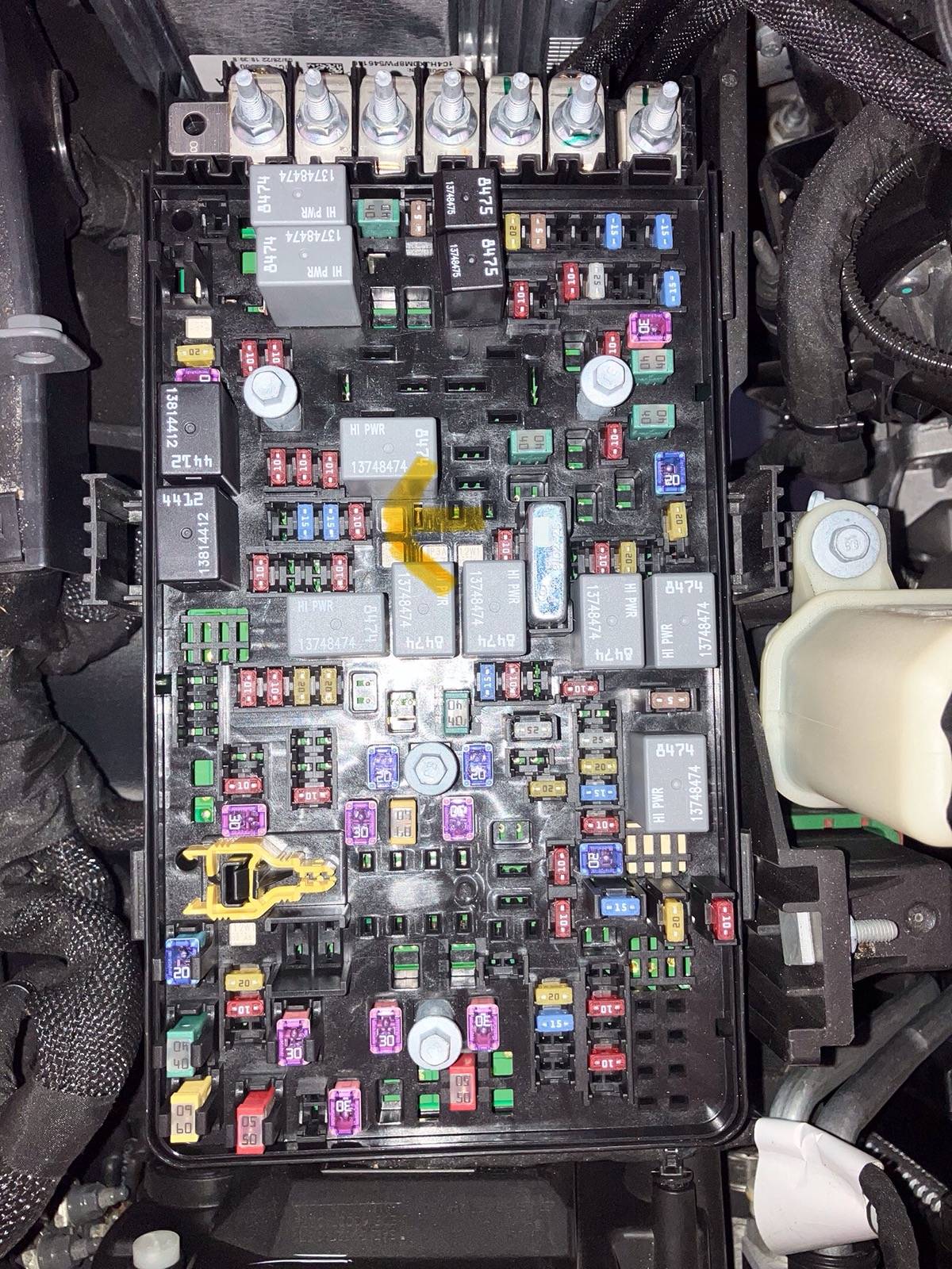

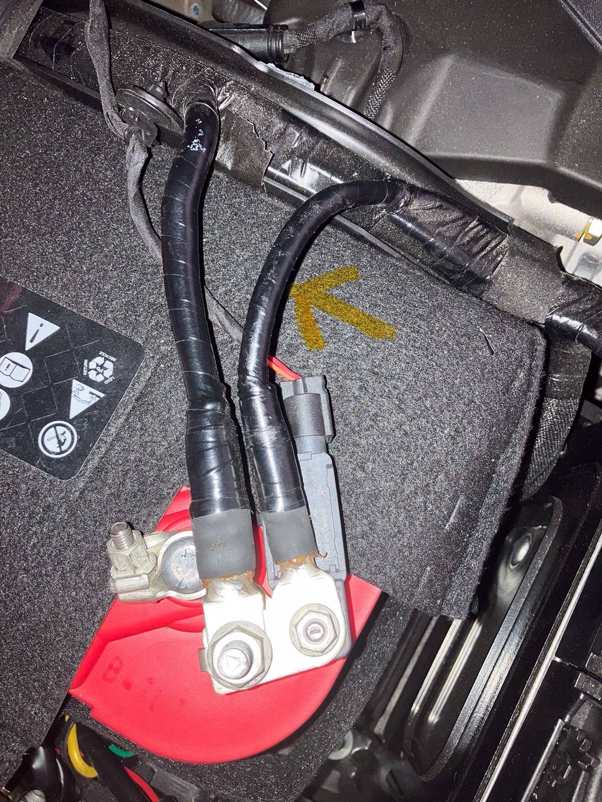

Hello forum, I read through the 45 page thread in regards to Aux battery by-pass, lots of info. Figured I would just post my own thread, not clog up previous thread, to get a quick answer. I am going to do the by-pass sometime today, just need reassurement from others that I am following the procedure from those that have done it. I already have the SmartStopStart in the Jeep to automatically press the button to turn off stop/start. Attached is two photos, with yellow arrows, of the two things to remove. Am I correct with disconnecting, which looks to me, to be the smaller gauge negative cable, at the main battery, which would be the aux battery negative cable, and taping the end of that up and tucking away? Second, pulling the red 10A fuse with yellow arrow pointing to it?
I have read that the best procedure order is:
1. Pull fuse first
2. Disconnect/tape/tuck away aux battery negative second
Thoughts from forum? Thanks!
It should be the thinner/smaller of the 2 cables.

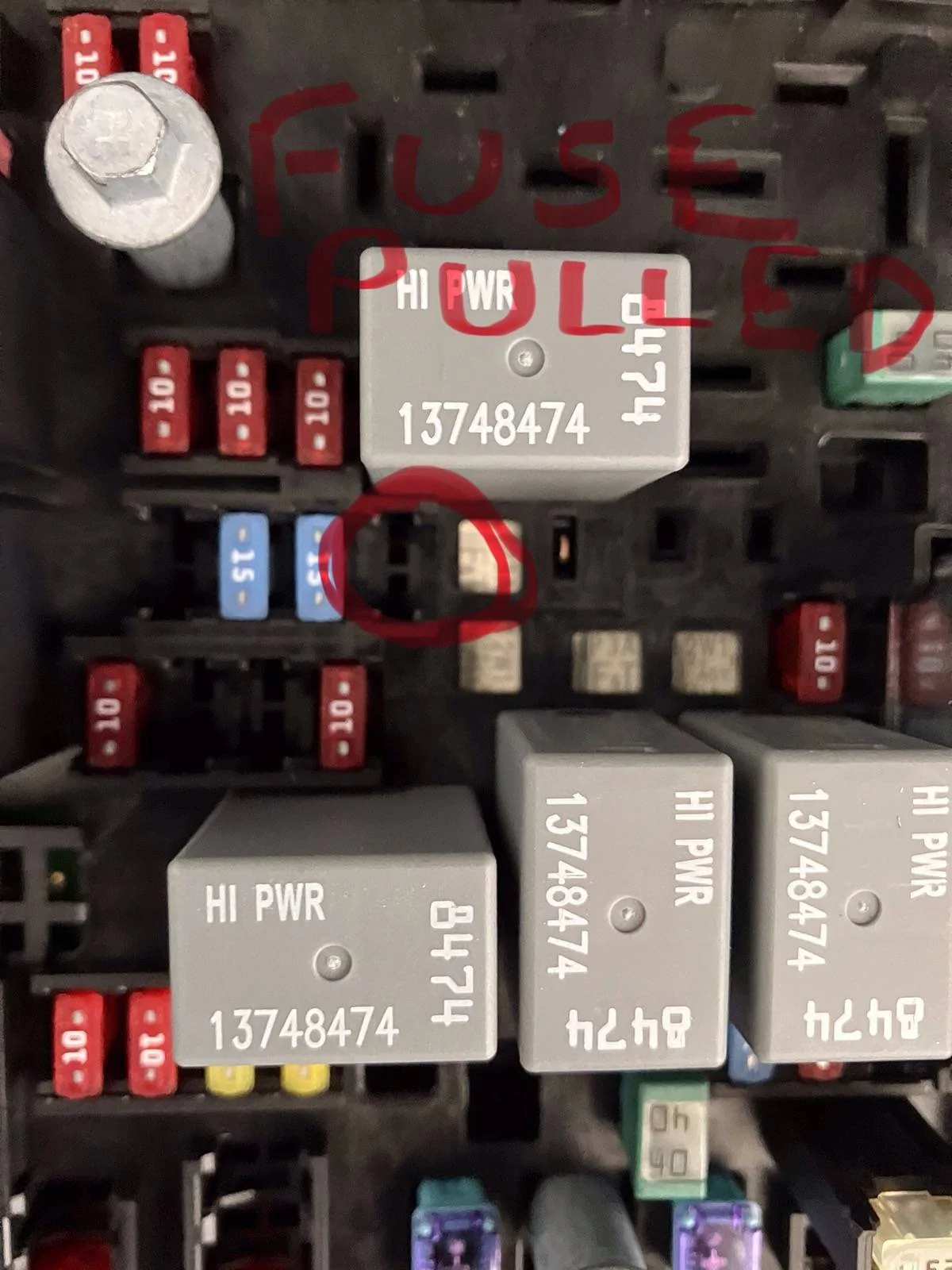

You want to pull fuse F42. Look at the inside of the fuse box cover. That should show where that fuse is. Off the top of my head, your arrow appears to be pointing to the correct fuse.
1. Pull fuse first
Correct.

By the looks of my photo, it looks like both negative cables need removed, in order to get the aux negative off, because aux negative is under main negative due to wider blade? Do I reconnect the main negative where it was taken off from, or move over to where aux negative was? Does the aux negative wide blade create some sort of bridge from main negative to aux negative?
jludave
Dave
Feb 13, 2020
4,158
4,287
The Isle of Long
IT Manager

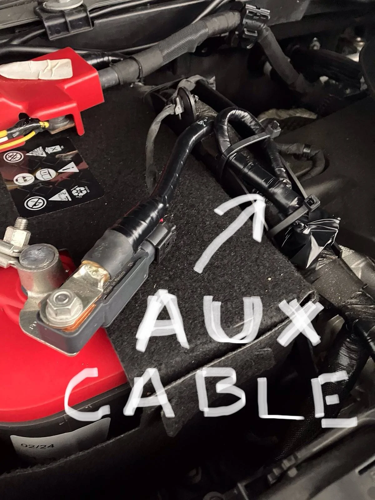

You will need to test which is actually the AUX negative. Some have found in later model years, that the aux cable was not the thinner/skinnier of the 2. Go back and look through the full Jumper less AUX Bypass thread - https://www.jlwranglerforums.com/forum/threads/jumperless-aux-battery-bypass.95945/
Put the main back where it was.
Yes. Under normal conditions, without the bypass, both batteries are connected.

But your JL was designed for it to work with two batteries, sparing the main battery to effect the bulk of the cranking load (both batteries, if present, energize the crank) or entire load of the crank if you've yanked the ESS battery, and the perfect storm of a cold night, an old main battery, a long traffic light, and too many energy hungry appliances running during an ESS event may rob the main battery of adequate power to crank the engine before the vehicle early terminates the ESS event due to low voltage in what it thinks, none the wiser, is the ESS battery, but is actually, thanks to the Fuse 42 pull, your main battery.
Pulling fuse 42 first is neither wrong nor required. The only time current runs through that circuit, which when it does opens a normally closed relay: the Power Control Relay (PCR) that separates the batteries is during an instant prior to cold crank and during ESS events. With your engine off, whether you yank the battery cable or fuse first is of no consequence as long as both are effected prior to your next cold crank.
