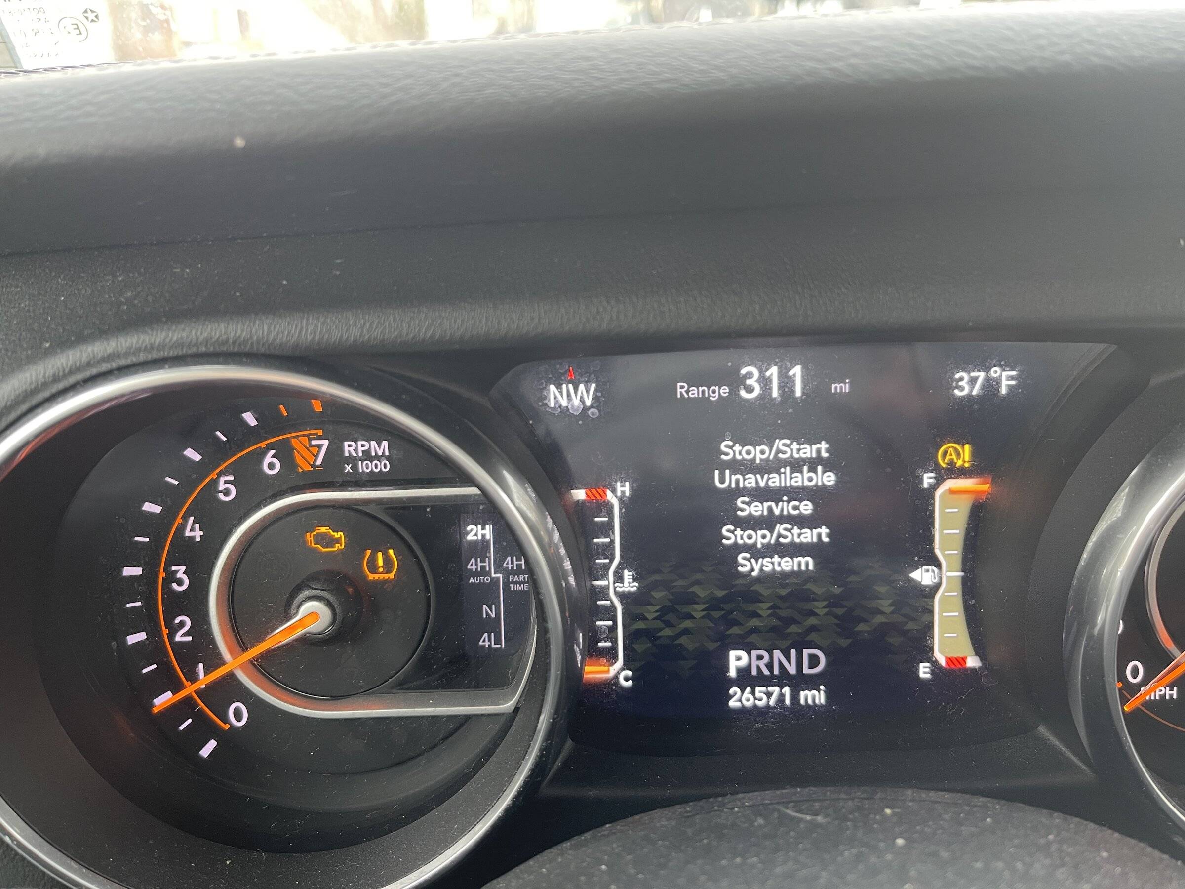

This just happened to me. Backstory (might not be important) : I used 4H a couple days ago because we got snow here. I never use it and it was pretty stiff to shift but it worked fine.
Tonight I used a remote start to warm up the Jeep for a couple minutes and headed to run an errand. 2 miles down the road while at a red light, my engine started to rumble after idling for 2 minutes, the auto start service warning and check engine lights came on. It felt like it wanted to shut off. I limped back home with the rumble and will recheck in the morning… could the cold have something to do with it? I don’t know if I can drive it to the dealer with that rumble. I hope it magically goes away like some of yours…

Well, she is undrivable this morning... got it towed! The dealership said the code reads "misfire"

You can drive it with the Stop/Start service unavailable message... As long as everything else is running okay.
