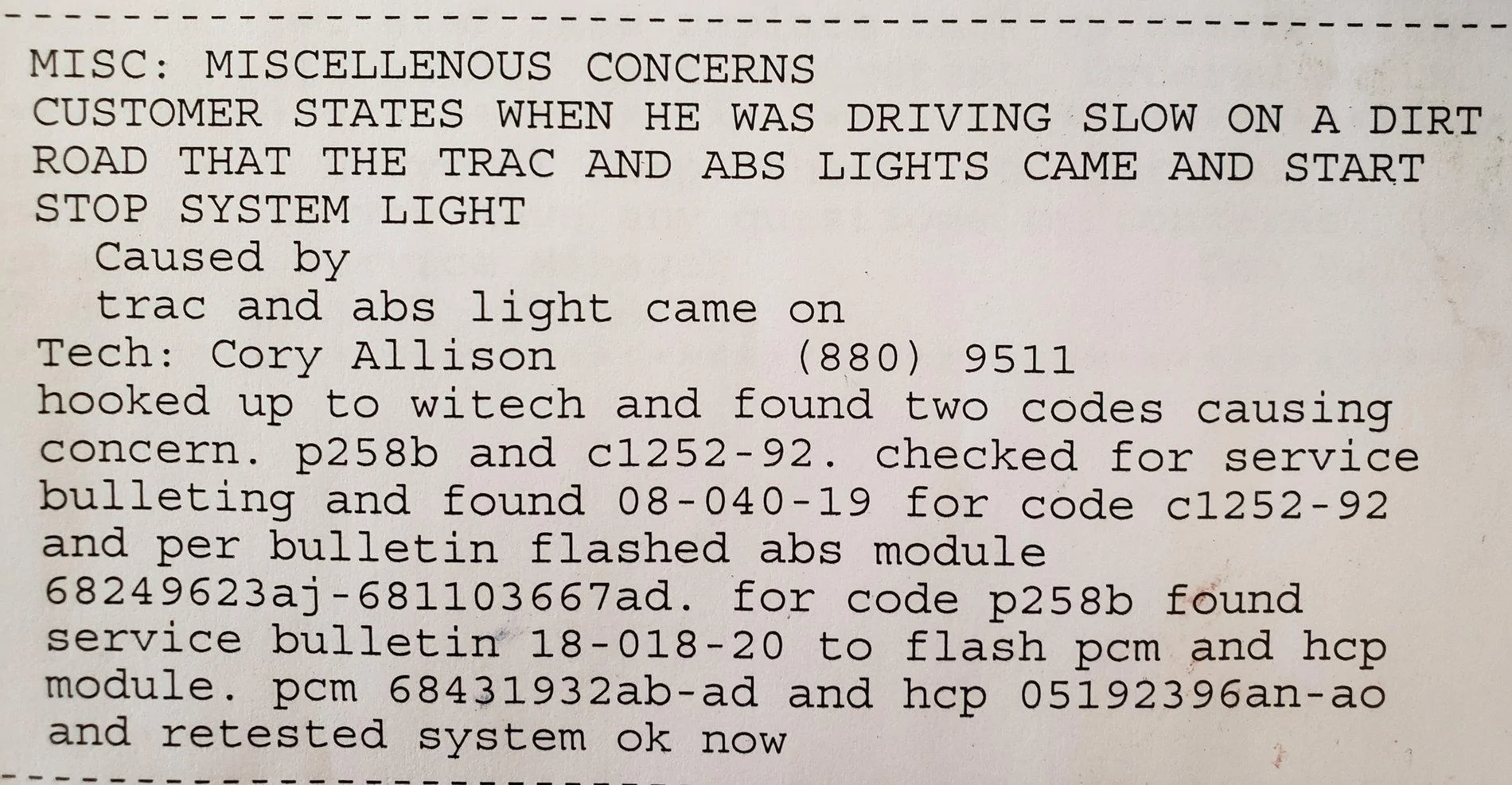

About 3 weeks ago we went 4-wheeling on a trail, my Auto Stop/Start warning light came on... At the time, we were in 4x4 Low and basically going at idle speed/RPM for an extended period of time due to the rocky terrain... I noticed the engine ran a little rough at the time, so I took it to the dealership... Their diagnosis - replaced the driver side door latch (proximity sensor equipped) because it wasn't working correctly and was causing a voltage drop... Didn't seem right to me, but what do I know?
They also mentioned my aftermarket led tail lights that have been installed since October with no problems whatsoever... Said it had tripped a soft code.
Now, fast-forward to yesterday, let the jeep idle for about 10 minutes while waiting to meet up with a guy. The guy gets there, we talk for another 10 minutes, then I leave to go back to work... I notice the Jeep is running a little rough again and then the Auto Stop/Start warning light pops back on... I immediately call the dealer and schedule an appointment for Monday at 8am...
When I got back to work, I turned the Jeep off for about 10-15 minutes, when I restarted it, it ran smoothly and the light went back off...
This is a 2018 Wrangler JLU with 13,200 miles on it, already had the oil changed twice at the dealer and all open recalls have been done.
Any ideas what's going on?
