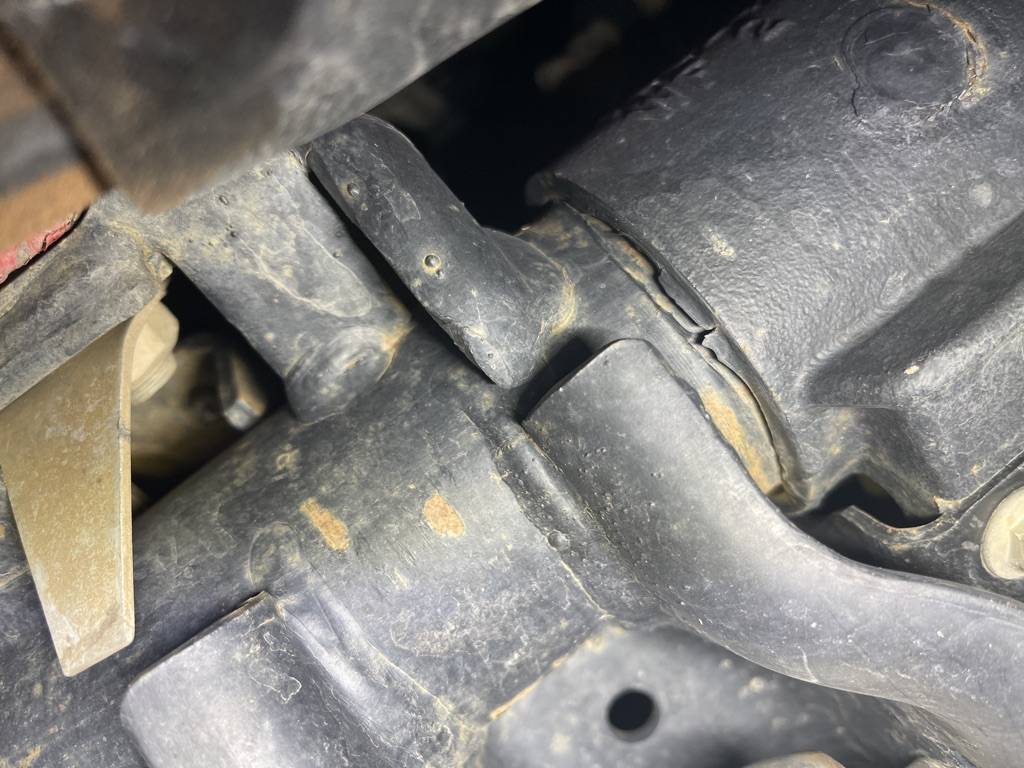

I wish it was a more gnarly story but I had to ditch off a long, straight dirt road (coming out on the west end of Long Canyon in moab near Dead Horse Point) after a dirt biker came over a crest at top speed down the middle. I was doing about 35 and hit an unlucky spot on the siding that bottomed me out and put a lot of force on the front passenger side. Guy kept going. Axle tube shifted upwards at the FAD and the spot welds are popped on both sides of the fad housing. Had to adjust the drag link pretty significantly to straighten the steering back out before I could get it back to my spot for the night.
This happened after 2 full days of successful, relaxing wheeling on Hell's Revenge, Fins n things, and Poison Spider.
You can see the unintentional camber here and the indication of movement at the FAD area. I'm only running 35" Patagonias and relatively lightweight Fifteen52 wheels.
