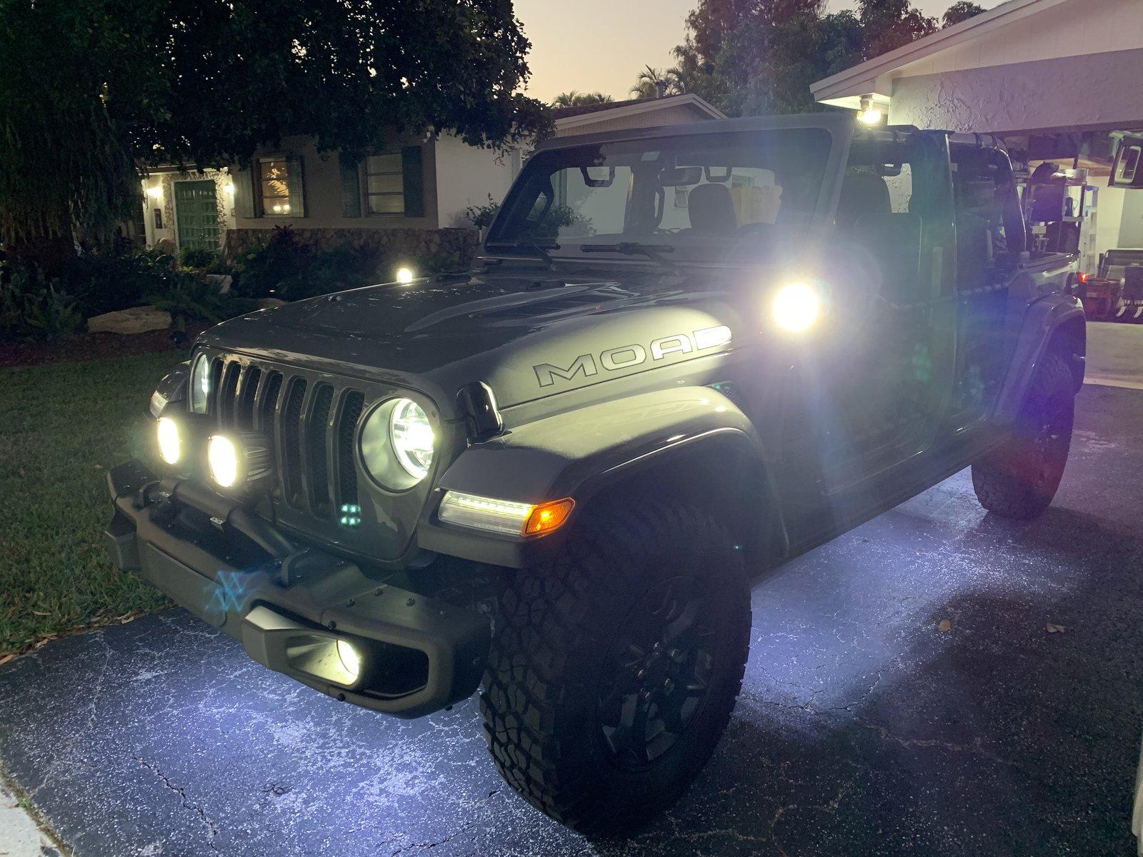

Hi Everyone, long time reader first time poster. I’m in the process of ordering my 2019 Rubi (through Craig at Koons) and I’m wanted to get the collective opinion of the forum on two options. wondering if the LED headlights are really worth the extra $900. Won’t some kind of LED aftermarket lights be available forb1/5th the cost?
Also is the hardtop headliner worth it? I had a 97 Sahara back in the day and it didn’t seem that noisy with the hardtop.
Any advice would be greatly appreciated.
Thanks-mike
Worth it!
Jeep Wrangler JL Are LED headlights worth $900? IMG_0983
Agent47
Jun 12, 2018
285
363
PNW
Mojito! JLU 2.0T (Built 7/4)
Easily worth it since you also get the LED taillights, fog lights, and fender lights. The headlights are bright and have a decent cutoff to not blind people. The headlights on their own sell for around that amount used, so if you don’t like them you could always get rid of them and still keep the other LEDs.
