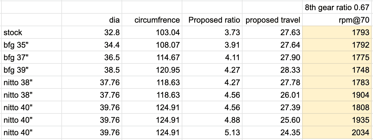

Jeep Wrangler JL Are 4.10s sufficient? 0BEC07B4-D2B0-46E4-88F8-8B21E4FE2625
I created this spreadsheet for my 392 to help me understand the basics…. This doesn’t take into account the rotational energy required by larger tires, but the difference is minor.
