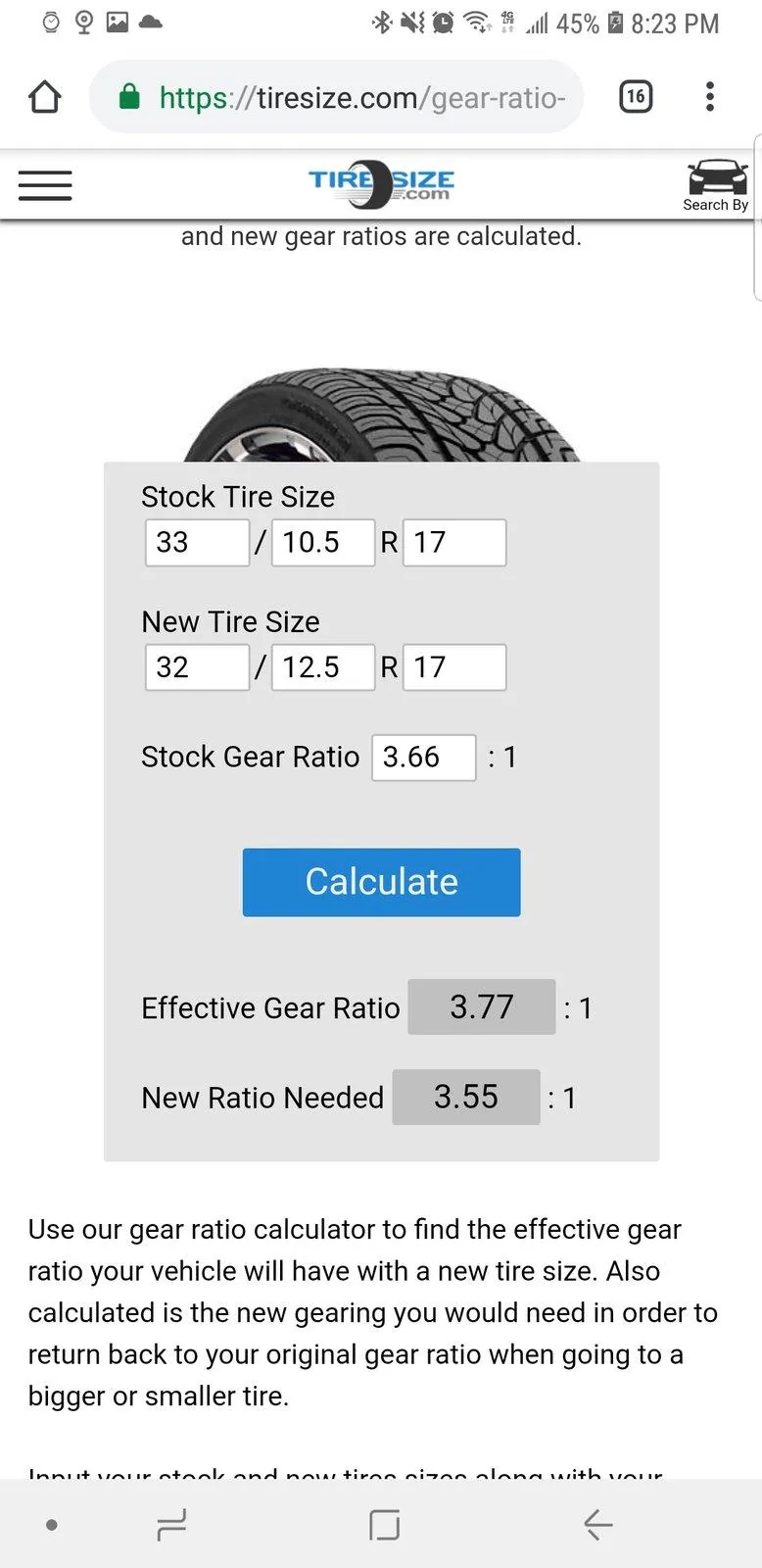

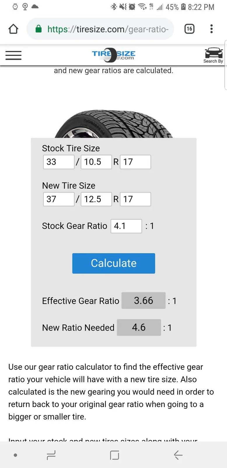

Can someone explain to me what I am doing incorrectly? If a Rubicon has 4.10 gears and comes 33 inch tires. Once you put on 37, that is essentially like having 3.66 gears with 33s which I don't think is terrible. And then I ran the calculation again which shows 3.66 gears on 33s would be like 3.77 gears with 32s. Considering Sports and Saharas have 3.45 gears, why is it so good to regear? Wouldn't the 6 speed manual and the 8 speed auto still be at a higher rpm at any given speed with 37s than a stock Sport or Sahara on stock 32s? Is it simply the weight that kills it when you go that big? Am I doing the math incorrectly?

Your calculations aren’t considering for actual tire size. So, there’s some discrepancy in the math. Also, yes weight does add into the consideration.
Third, I have a manual with 37s and stock gears. I plan on upgrading to 4.88 gears. It does surprisingly fine on road. It’s an absolute pig starting uphill and at slow speeds in 4h. 4L is ok, but The trq at low speed is significant between the 37s and 33s.

I realize 33s are sometimes 32s but same way 37s are usually closer to 36s. The 0.5 inches one way or another doesn't really move the needle all that much. So in theory or I guess actuality a stock Rubicon with 37s is still geared more aggressively than a Sport or Sahara are and is spinning at a higher rpm going 75 in a 6 speed Rubicon with 37s than a stock Sport with 32s? But with all the weight you want to be in even higher power band a stock non Rubicon. .
I live in Florida barely hills to speak of except bridges so wondering how necessary it will be for me. I am leaning towards a 6 speed Rubicon

With trying to not sound snotty, I’m not going to do the calculations to get the exact numbers. But the difference in circumfrence is different between 32/33 and 36/37. (Which is also not correct because my 37s measure at 35.75ā€ at 30 PSI.) I don’t believe the math would be linear. I don’t believe your statement is giving enough credit for the relatively small numbers. And, I was replying to the 1st part of your comment in asking what’s wrong. As a matter of theory, your math is at best incomplete.
However, practically speaking, I would put 37s and not regear if I was driving onroad in FL. I didn’t use 6th much when it was stock. I never use it now (with 37s). You can always regear later if you don’t like it.
From my experience it’s absolutly fine for driving around town (even driving onroad to the mountains). I am only going to regear for Offroad performance.

Not snotty at all, I guess what I am saying is that even if you are comparing to the tire being actually closer to 32 inches on a factory Rubicon and the 37 inch tire is a real 37. The calculation would still put the theoretical gear ratio as more aggressive than a stock Sport or Sahara on stock 32s. Even if it lowers it a bit, it won't go down from my calculation of 3.77 to 3.45 or below. You would still be at a higher RPM. But yes I get that it is not just gearing, you have to factor in probably like 20+lbs of unsprung weight at each corner and crappier aero due to the lift from tires plus presumed lift to fit the tires under the car. I guess I just need to do it and see how I like it. Since I am leaning towards a 6 speed, even if I regear my all in would be probably right at the price of an auto or just below and feel it would be better to have a properly geared 6 speed than a too low of a geared auto.
