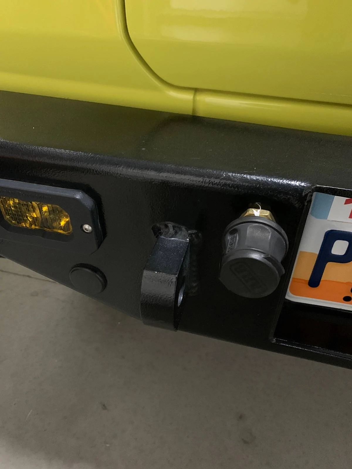

I got theses from Grimm off road, multiple sizes and fittings are online or hardware stores, I just got long enough to reach the back and used an ARB disconnect, also wired the pump into my aux switches

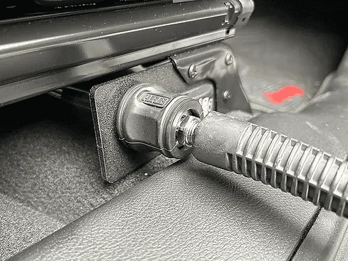

Jeremy @813 Fabrication & Design uses these on his plates. The JIC hoses/fittings are a little more difficult to track down and I believe he works with Grimm on those. I don't have a good shot on my phone (hope Jeremy doesn't mind me linking his pics), but this is how flush the JIC coupler ends up in comparison:
I don't mind at all! Yes, I always recommend the JIC-4 version since it sits flush and doesn't use the bulkhead fitting. But, it does require using the 1/4" flare air lines. I sell the GRIMM air lines with my mounts because I like how they are built vs the ARB lines. The GRIMM lines have a nice rubber/silicone coating over the lines and there are several sizes available. I usually carry 12/20/30/40/60/80/120" lines to help customers put together their custom setups.

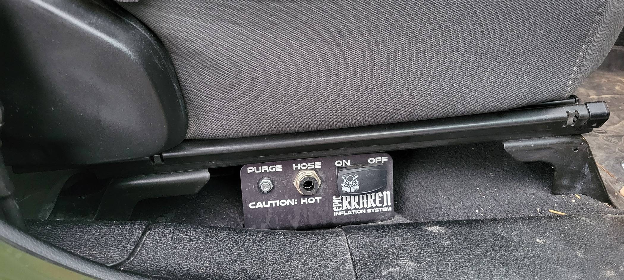

We went with the ARB twin and the Kraken mount. It's not going to bother you for sound or vibration because you'll likely be outside the Jeep anyway, we always are.
Airs up all four 37's from 12 pounds to 37 in 7 minutes. Comes with splitter hose for both sides so everything goes up at once. Simple install and fits under a standard cloth rubicon seat (which does not move up or down).
