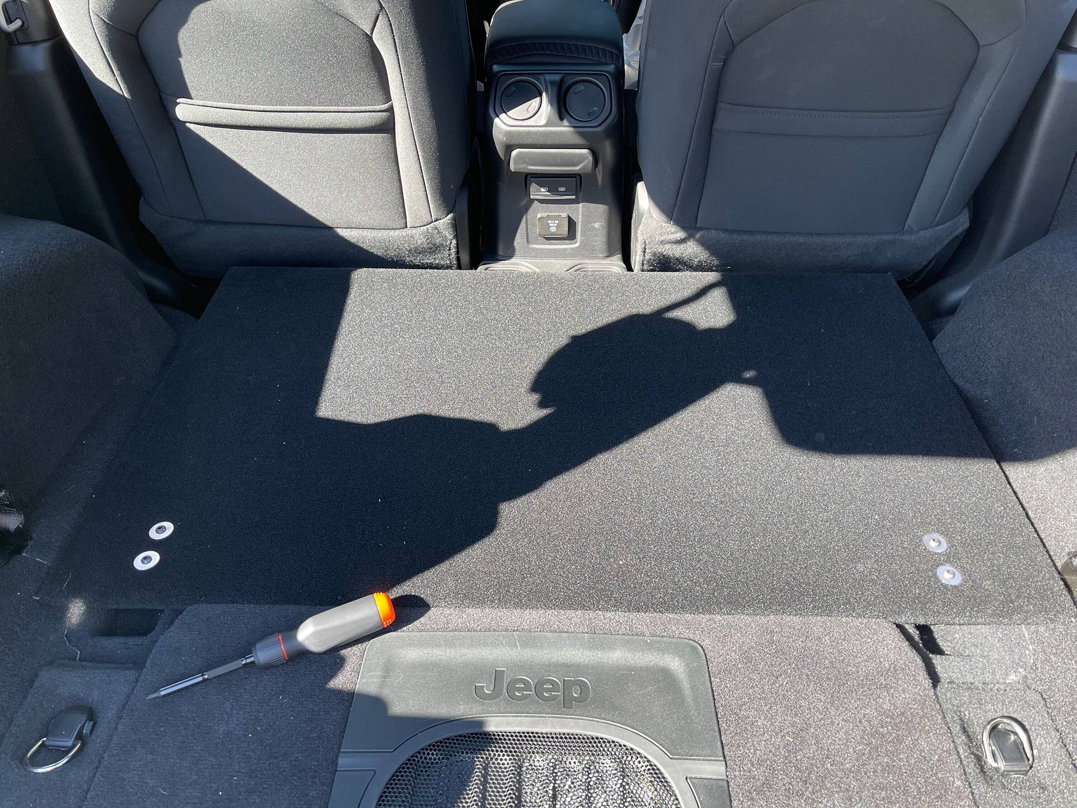

I took out the rear seat for a couple years, then put it back in for a while when relatives needed it. Recently removed the right 60% side and used a bracket to tie in just the left rear seat to the floor, with the plywood platform I made covering most of the footwell of the rear area.

Yea I made a small carpet covered platform for the back of mine to smooth out the floor to keep the dogs legs out of the holes, as well as just a nicer place to pack stuff for camping.

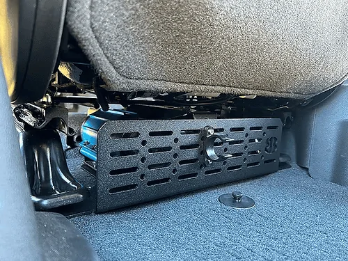

Our Under Front Seat Mount should fit fine under either seat. I was using our '22 JLU when designing the mount and did not see any height differences since I always have the seat as low as it goes. There is approx 3/4"-1" clearance from the top of the compressor. The bonus with mounting under the seat, the floor vent sits right beside the compressor so you can use the AC to help cool it when it is hot outside. I have several customers who have ran lines to outside the Jeep from under the seat, it isn't too hard if you use the firewall or floor grommets to do so. Let me know if there is anything I can do to help!
