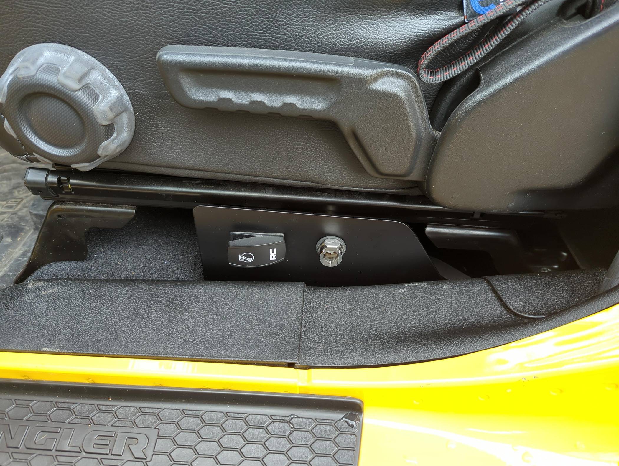

Just a question about mounting the ARB dual compressor under the seat.
Can you lower the standard manual seat down all the way with the compressor mounted under the seat?
I mounted mine under the driver's seat. Yes it lowers all of the way. I made my own mount.
