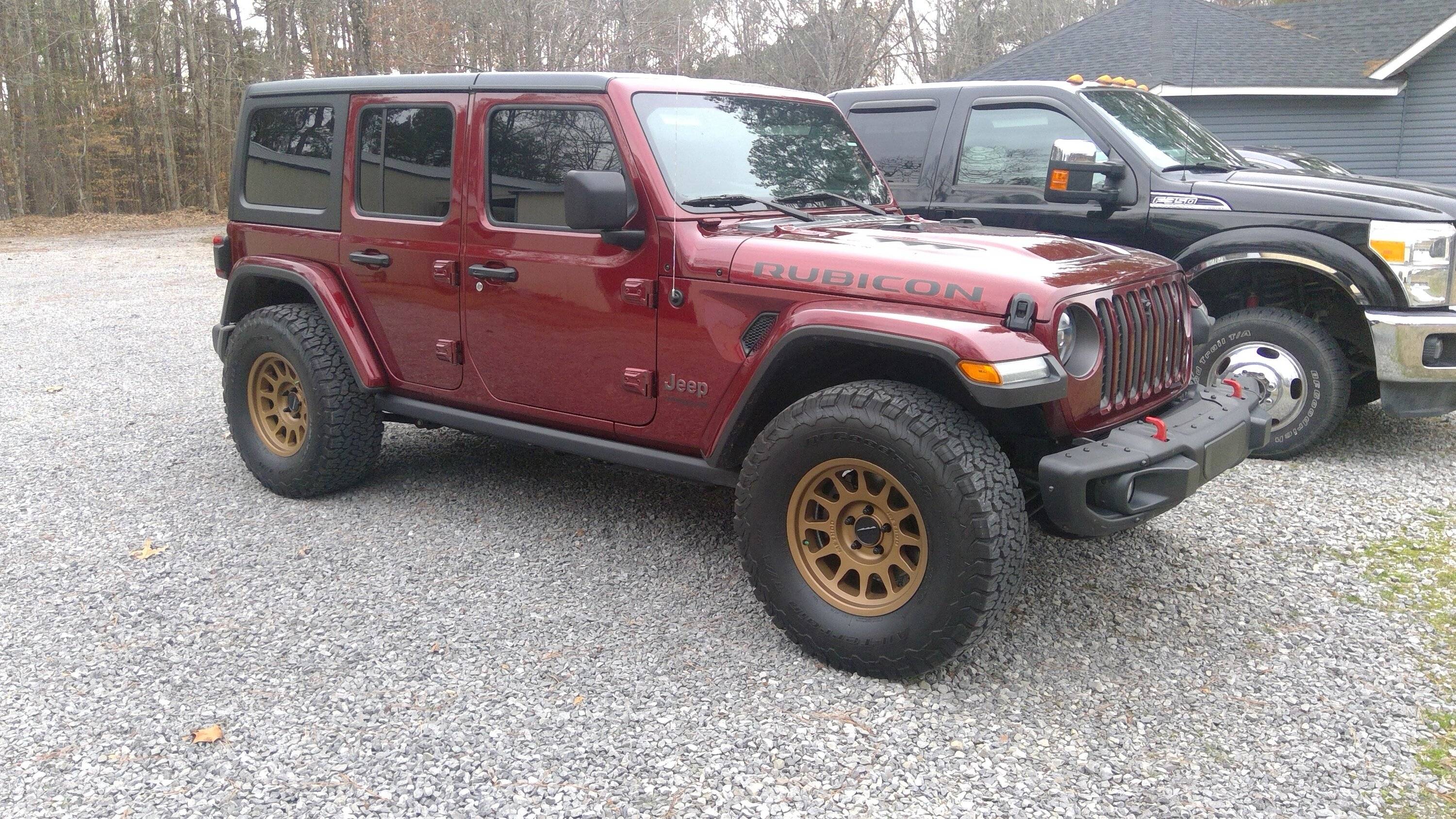

I have installed a Tazer in my 2021 Rubicon, mainly for correcting my speedometer/odometer readings. I have the BFG K02 315/70 R17 on Method 703 bronze wheels. I compared the speedometer on the Jeep to my phone GPS speed and distance to sneak up on the correct Tazer tire size. Eventually got it to within 1% accuracy, which is close enough for me. (Speedometer is spot on while the odometer will show a bit less than one mile short on a 100 mile trip).
