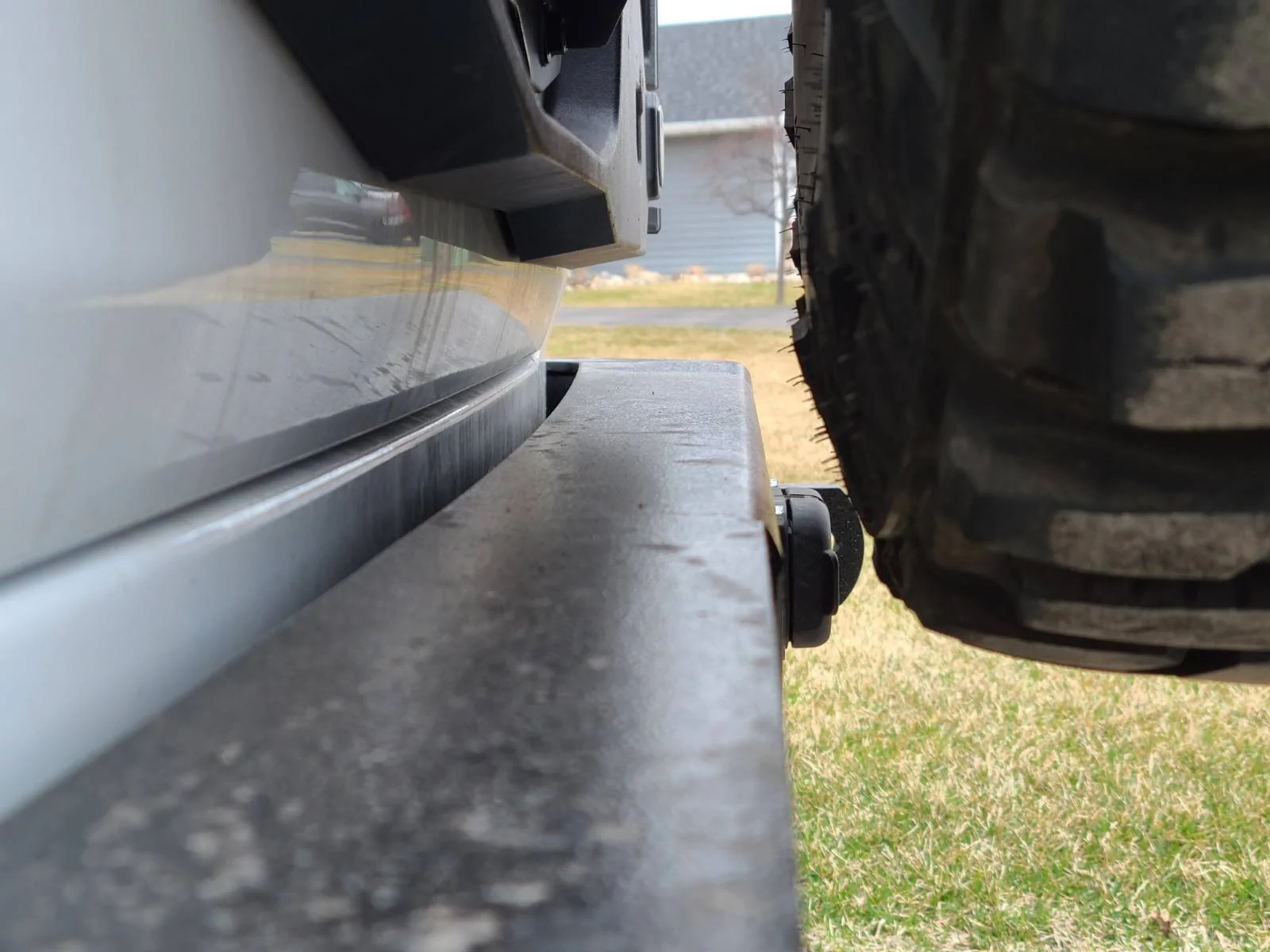

I cut the stock plastic one down it works perfectlyWhat are you using for a lower skid plate beneath the bumper?

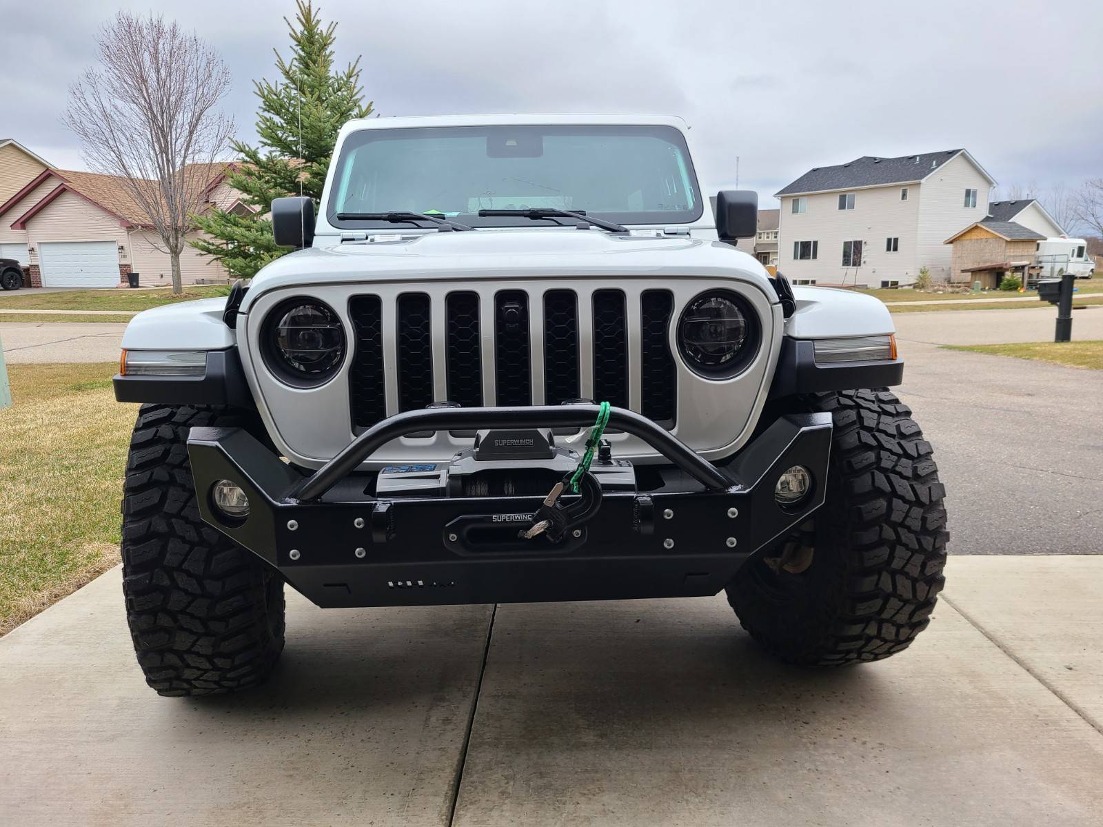

Nice looking rig!!There is NOTHING special about the Rockhard except the price. In fact the Rockhard sits lower in the front then the Barricade thus reducing approach angles. That alone should be a deal breaker.
Also note the Rock hard the D-ring is welded to the bumper and not tied to the frame. whereas the Barricade the D-ring is bolted to the frame. The Rockhard will not hold up as the integrity of their D-ring is reliant on the strength of the aluminum sheet metal whereas the Barricade being bolted to the frame takes the bumper out of the equation and much stronger D-ring.
I have had the Barricade on two Wranglers now and the oldest one 4 year now still looks like new. The Barricade is also more aux lighting friendly

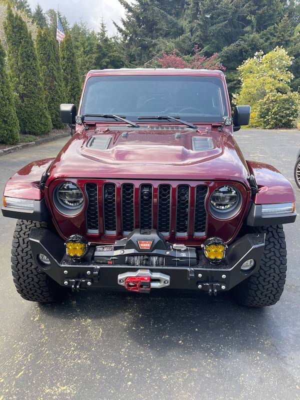

Wow, that looks great! Very nice choices all aroundI am very happy with my RockHard aluminum mid length bumper with lowered winch plate. Yes, expensive but great design and quality welds.
The factory LED foglight install was plug and play. The Warn Zeon 8S winch however was not. It required some grinding of the inside frame end caps but no big deal. Very tight fit and a bit of a struggle to wiggle it in but once seated, fits like a glove.
One main selling point was that it is designed for towing. I will be pulling behind a Class C. The optional fittings tie directly into the frame ends.

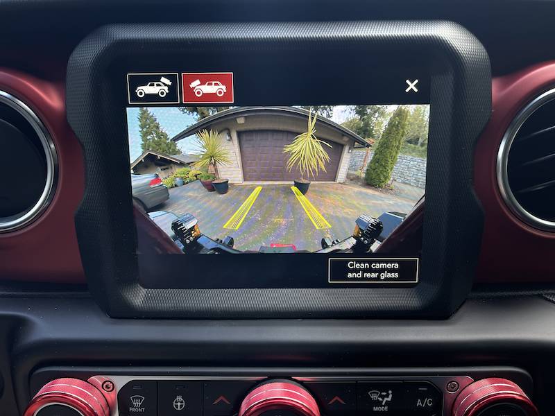

I had the bumper built minus the bull bar for several reasons. 1) Reduced weight, 2) Less camera obstruction, 3) Less grill blockage, and 4) More real estate for aftermarket lighting.
View from the cockpit...
