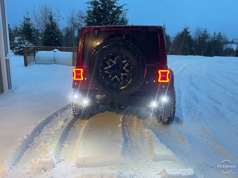

I decided I didn't like the look of the plastic plugs where rear sensors would go (don't have them) in my RockHard aluminum bumper, so:

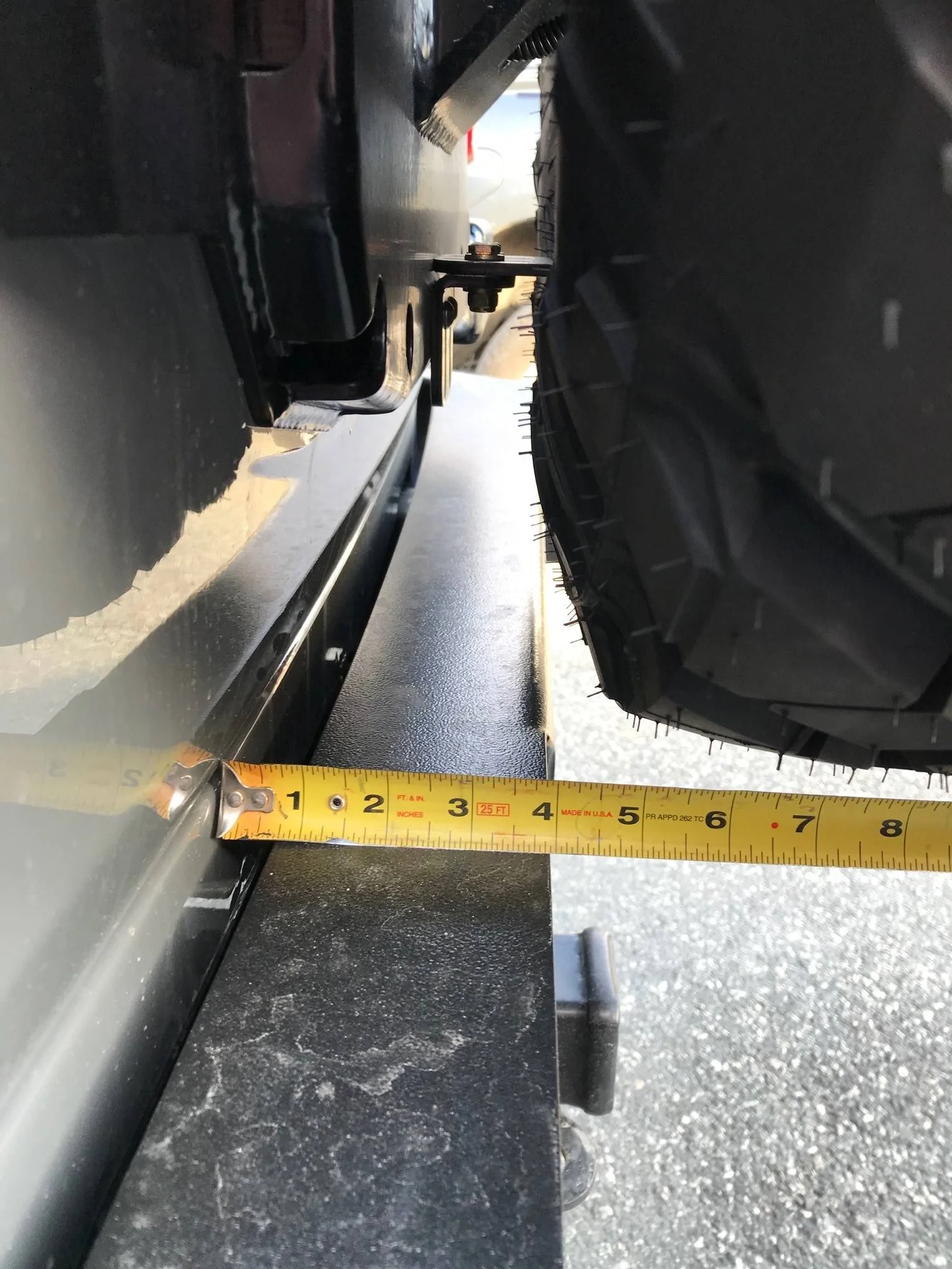

That makes sense. Hope the pics help.

I have the Rockhard Aluminum front bumper and am considering their rear product. Are you sure your rear is aluminum? I can only find steel on their website?
Like you, I don't have rear sensors and LOVE your LED application.... What LED product did you use and how did you install them? Thanks !!!

I also would like to know more about the led lights used in place of the plastic plugs, very cool idea.
As far as the aluminum rear, I can't speak for the others, but the one I have is aluminum. it is model number [RH-90340]

Yeah : https://www.rockhard4x4.com/product_p/rh-90340.htm
The LED's are just some cheap ones off of Amazon :
LEADTOPS Eagle Eye LED Lights,... https://www.amazon.com/dp/B01N30U3CY?ref=ppx_pop_mob_ap_share
I installed the LED's using the sensor adapters that came with the RH bumper and a washer. They fit perfectly. I wired them into one of my aux switches so that I could use them for lighting at campsites, etc.

Ahhh, ok I see your bumper now. My confusion was because I'm wanting the
https://www.rockhard4x4.com/product_p/rh-90301.htm
with the swing-bracket to take the weight of my 37" spare off the tailgate and to add some other accessory mounting options.
From what I can tell, that one comes only in steel.
I will still use your LED idea though! Thanks again !!

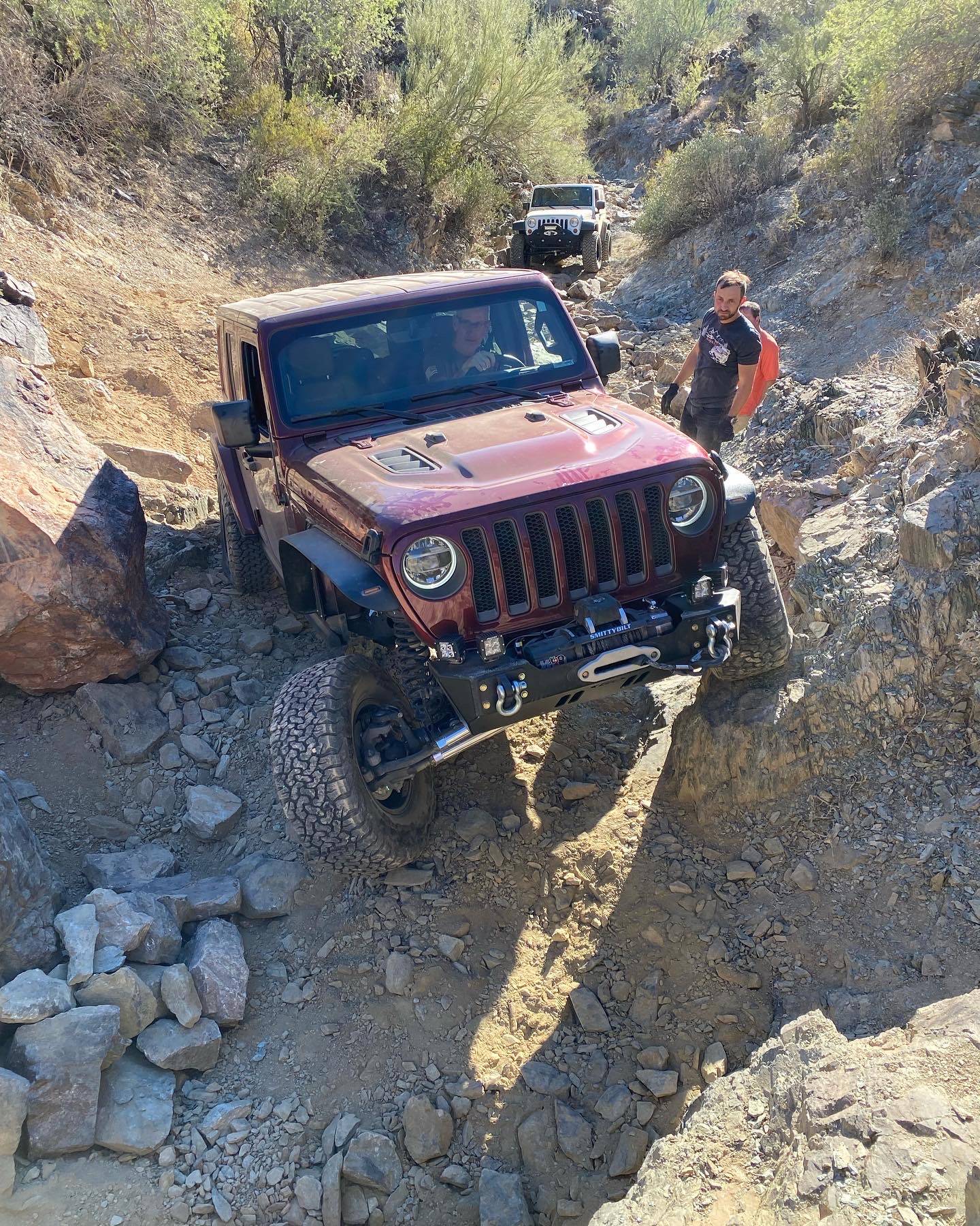

I have a Genright Front aluminum that I really like. Winch sits low as to no block airflow which is important if you live in the Desert lol. I haven't decided on a rear yet so glad I found this post. My rear is barely hanging as is but need rock sliders first.

Looks great. I've got mine coming this week. Did you need to extend the fog lights harness?
Even though he did not, yours may not bolt right up. Rubicon fog lights are apparently different from other trim's fog lights.

2018 Rubicon here... guess I'll find out from the shop this weekend!
