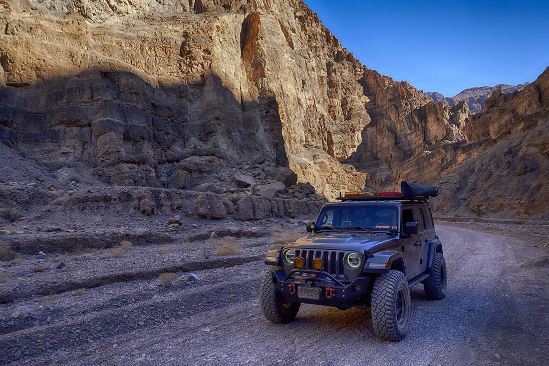

Here is my RockHard Aluminum Mid width front bumper with recessed winch along with some Baja LP4s. This is a toad behind my RV so I am trying to keep its weight down.
The OEM LED fogs plug in perfectly. I did the install myself. Yeah the Warn winch is a super tight fit. That is once you do a little grinding on the frame end flanges. If you have some DIY skills, dive in. I would be happy to advise.
I love the low profile and not restricting the airflow. Note also I had them 'delete' the bull bar. I didn't want it interfering with the front cam for crawling.
Jeep Wrangler JL ALUMINUM bumpers ONLY. Let's see them! IMG_2399
Note the clevis fittings specifically designed for towing. They tie directly into the frame ends.

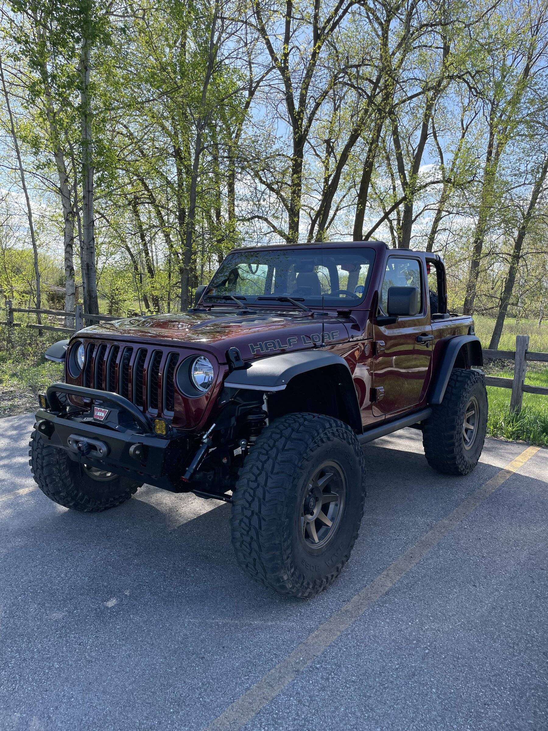

Next Venture Motorsports Featherweight
Added Diode Dynamics SS3 fogs by stripping the wire harness out of the old bumper.
Warn Zeon Platinum 10-S fit with no problems or interference.
Powder coated in a satin black on the aluminum cover and skid plate and then a bronze on the steel winch plate.
Trail cam still has an excellent view; even a little bit more on the sides than factory due to the stubby design.

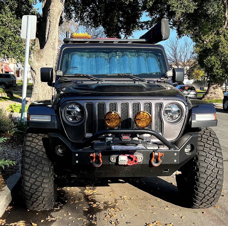

That looks great. How much does the bar block the camera view?
Jeep Wrangler JL ALUMINUM bumpers ONLY. Let's see them! 20220518_180123
Yeah, between the bar (which the bumper can be installed without) and the winch, I can't see much. Through the windshield, I can see a little in front of the yellow tire track lines, so the camera is good for a few feet, but not where you really need it. If I put a light bar on top of the bar, the camera will be totally useless for trail use.
I do like that I can see the hooks in the camera. they actually stick a little farther forward than the bar, so they are the furthest forward point. So, I can see before I punch a hole in my garage door or the car in front of me in a parking lot.

Thanks for the reply and picture. I think I'll stay away from bumpers with bars. Good to know the bar on this one is optional.

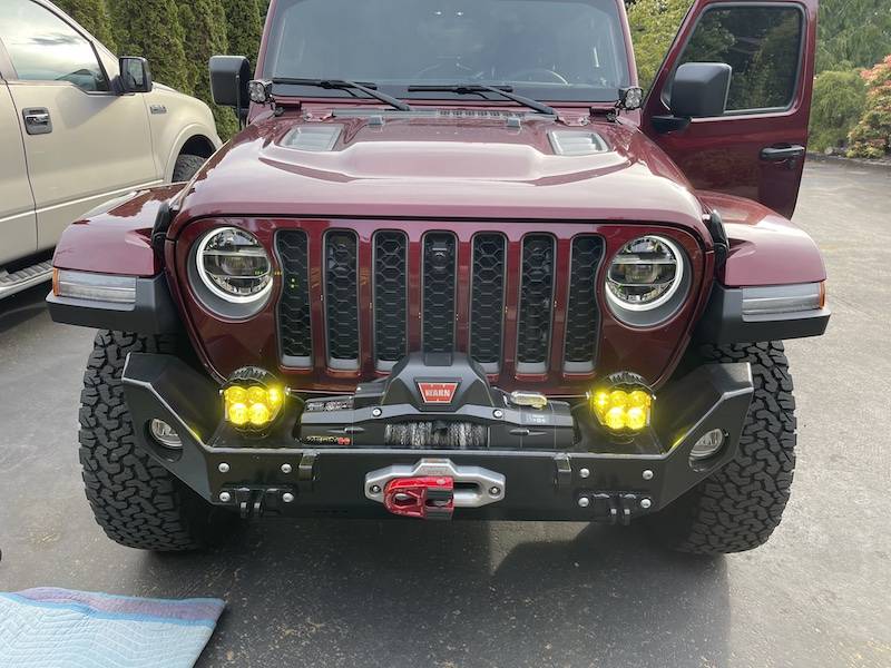

Here is a proper of my Rock Hard Aluminum mid width and lowered winch plate, with shackles and the Factor 55 Ultrahook. Really happy with how it turned out. The winch is a Superwinch SX10.
I don't know if shackle pins coming loose and falling out is common or not. But it happened twice with my JK so ever since I find shackles that have quick release pins. The pins in the shackles I got for my JL are actually bolts with nuts on the other end and a quick release pin to prevent the nut from screwing off.

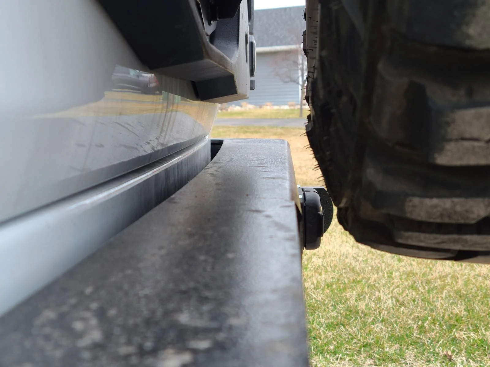

For the rear I went with the Rock Hard aluminum as well. I really wanted a bumper that kept the license plate located in the bumper. I also like that it is low profile and only sticks out about 4" from the back of the Jeep.
This bumper does not have a cutout for the spare tire so you need to have a spare tire mount that either raises the spare above the bumper or can be pulled out far enough to give the tire clearance. Rock Hard does offer a couple parts that enable you to raise the spare high enough for clearance.
I have the Teraflex Alpha HD tire mount and hinged tailgate reinforcement. In order for this to work with the Rock Hard bumper you need a wheel with 4.5" backspace or less, which is what my wheels are. The stock Jeep wheels have 6" backspace so they will not work with the Teraflex tire mount and Rock Hard bumper. The second image shows the clearance I have with my spare and the bumper. To achieve this I set the tire mount to the highest position and pulled it out all the way.
