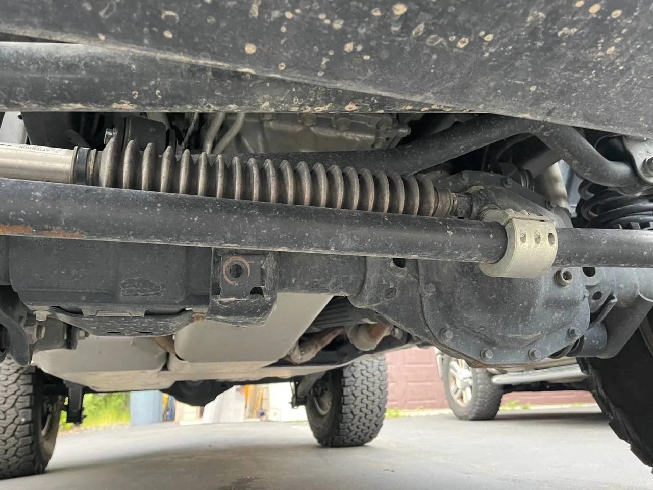

I should add that I used a Synergy stabilizer bracket to get it rotated and tucked away from potential damage. I am advocating that is better than other aftermarket stabilizers as I don’t have experience with those on a Jeep. I do really like the ride improvement of this one though.

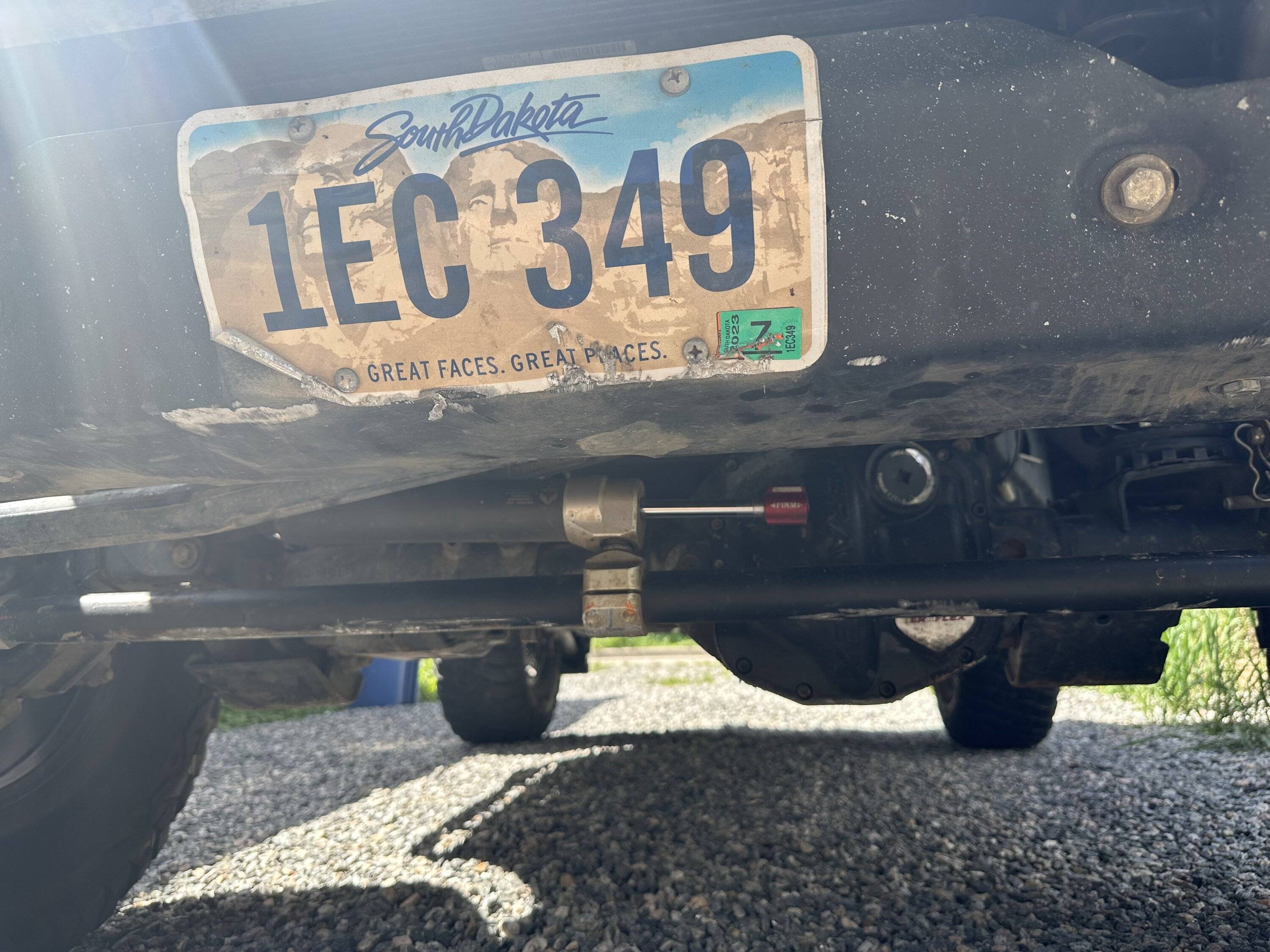

Have Falcon adjustable and non-adjustable stabs in two and remained stock in my 392. They noticeably soak up the big jarring bumps like expansion joints better.
