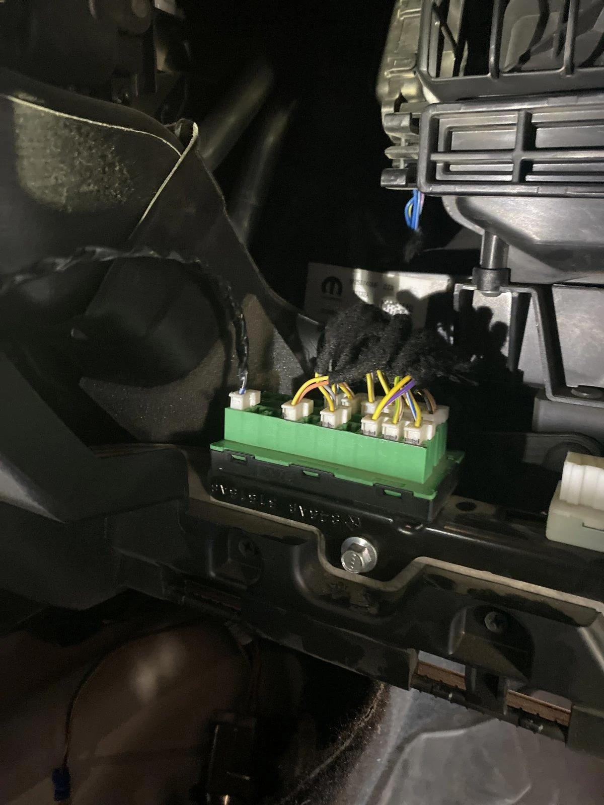

can anyone give me some advice as to how to remove the connectors Freon the green side?

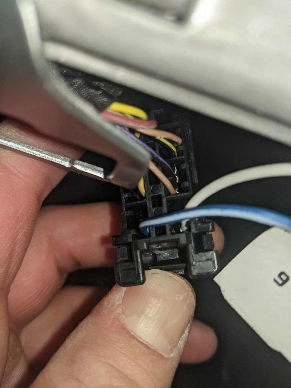

You don't open it the pins push in from the back. Push until you feel and hear a slight click. The u shape of the pin only fits one way. Make sure you have the right numbered slot as they are a bitch to get back apart once clicked in.

Hey does anyone know how to remove the wires from the connector? I installed the #1 wire top left and #9 bottom left but it won't light up. Maybe I got that wrong? I just can't figure out how to remove them now. Thanks.
