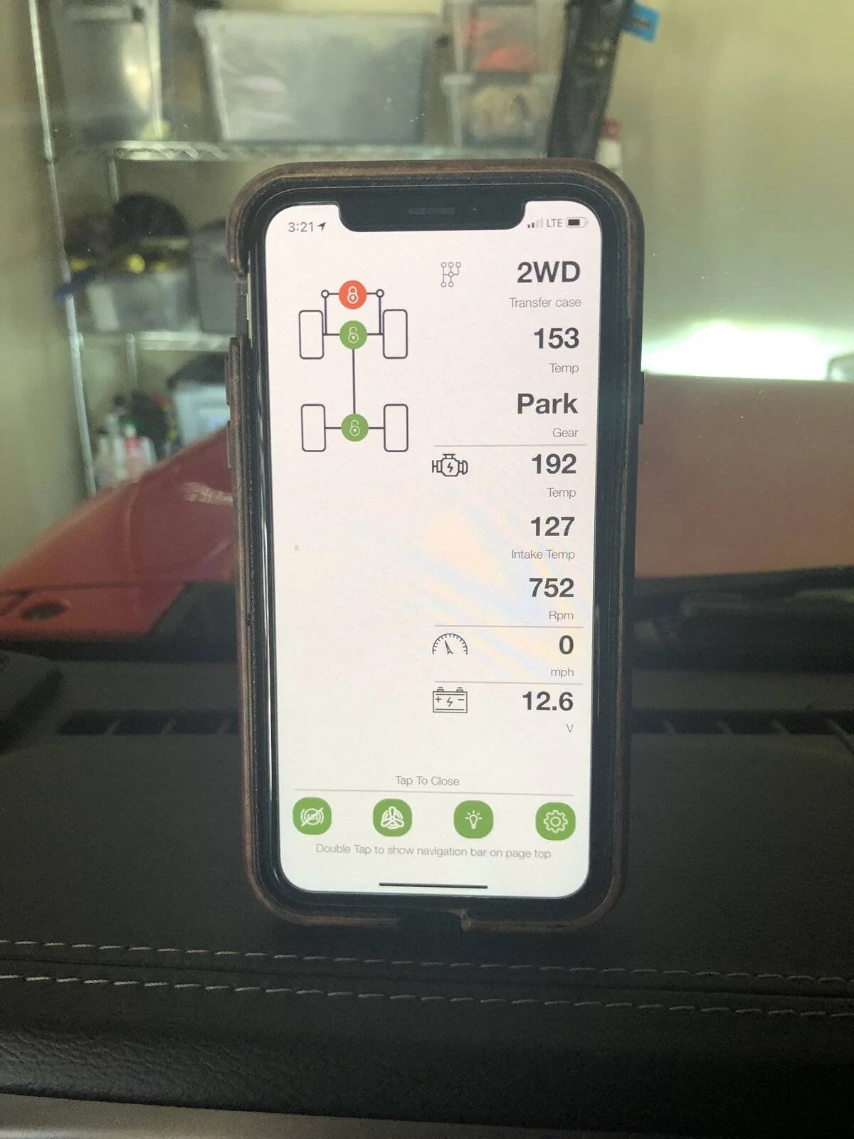

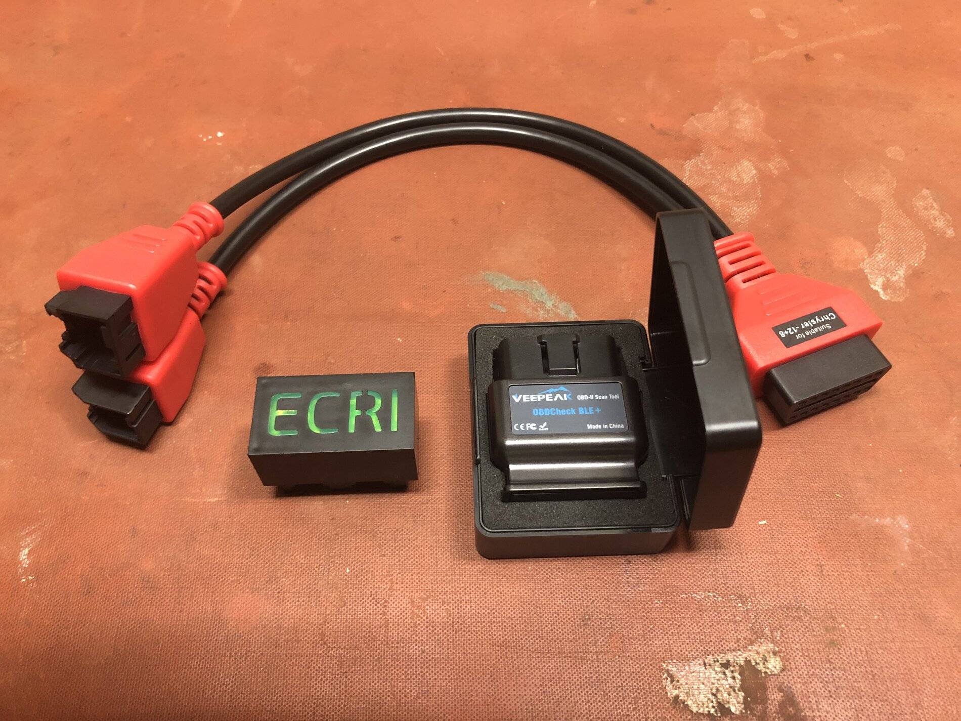

Free is nice but for $75 and 5 mins pulling plugs from the SGW and plugging them into the ECRI bypass and then you can just carry the BT code reader in the console and if you chose to you can plug it in and have some additional info while rolling
I leave my bypass plugged in all the time as I have 50k miles on my 2018 and the warranty is gone, not sure if it would be detected by the dealer service ppl if you left it in.
Also note, I have pictured both the 12+8 cable and ECRI bypass module, I started off with the cable but grew tired of plugging it in & out and was prepared to get a different bypass module that cost a lot more but found info on the ECRI and I even have it daisy chained to my SSS module and no conflicts and I had been unplugging my wireless carplay module as I thought there would be a conflict there but not with that either so with all installed I have ESS, TPMS adjusted, LED lights, tire size, wireless carplay and host of other things like a poor mans Off Road Pages taken care of for less that $200 ??
