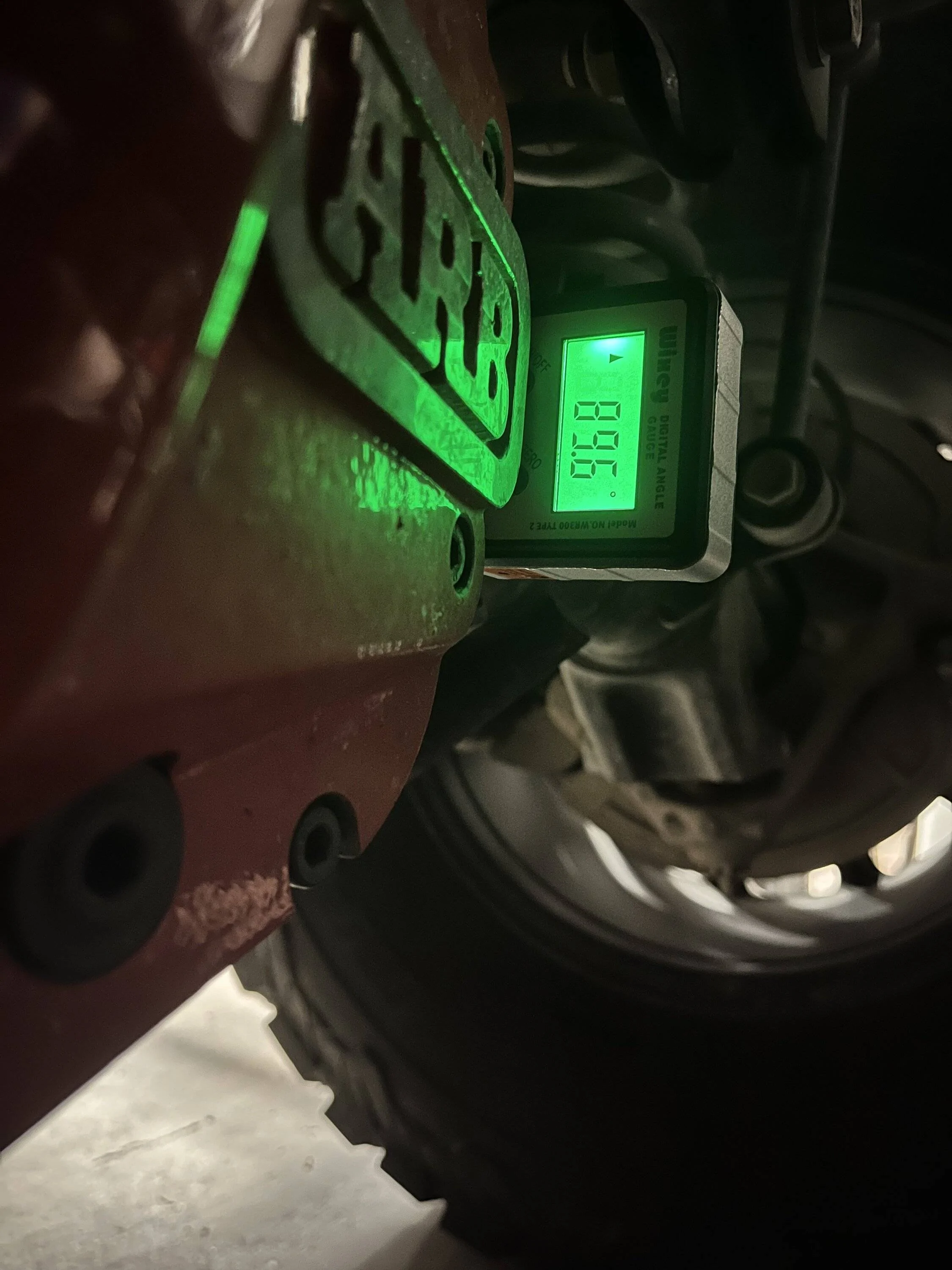

On the 2.0T it’s lower. Average of 89.6 and 89.4… 89.5…. Does that equal 6.5° or 5.5°?
I’m going to guess 5.5 because the 2.0T doesn’t handle quite as well as the diesel. Always figured it was due to the lighter engine but may be it’s that and less caster?
Under 90 is less caster……

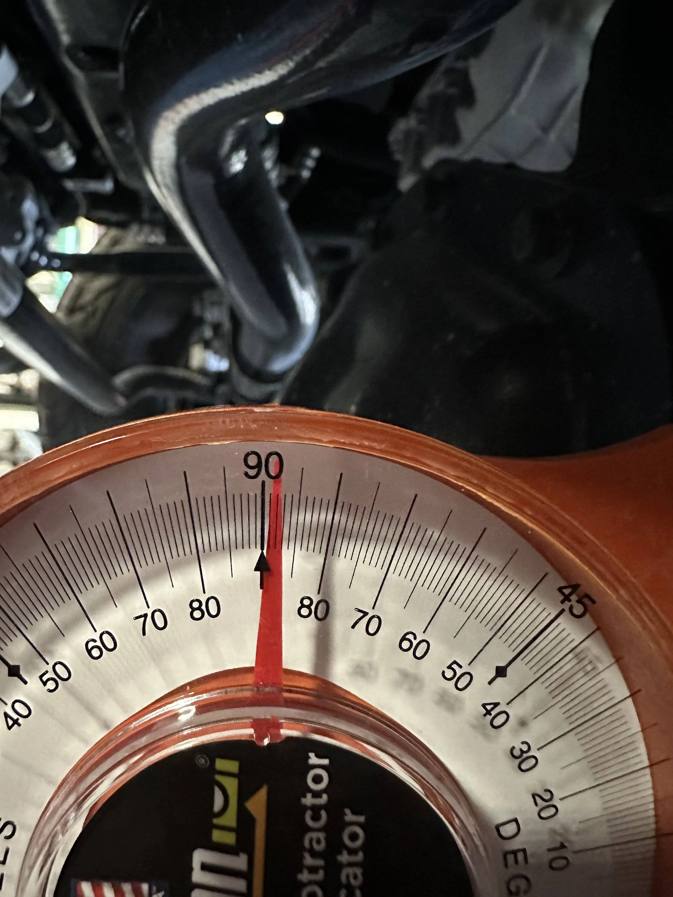

This is where I currently sit

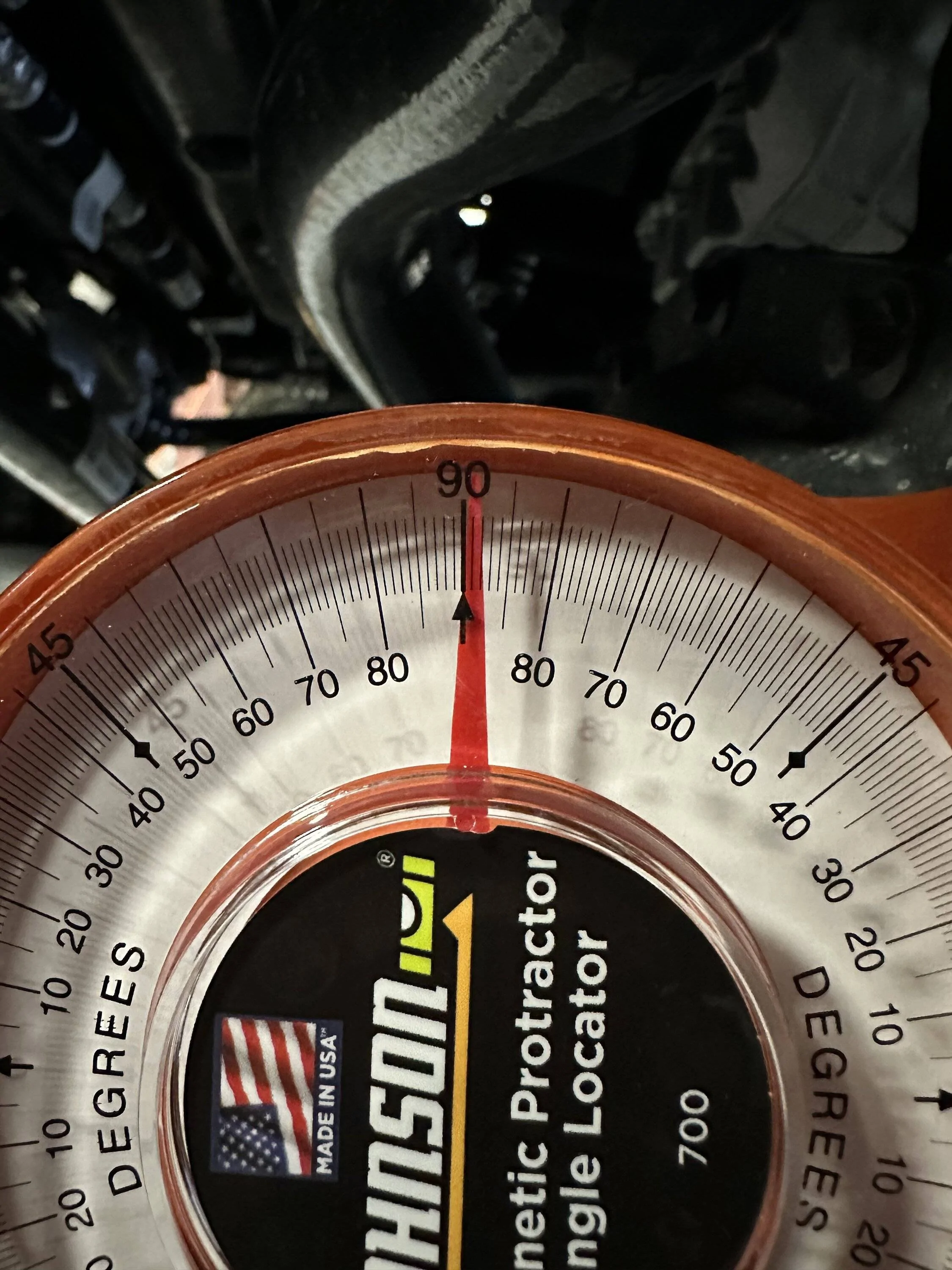

And now on the 3rd hole:

So that made a noticeable difference in the way the steering feels. Much better - thanks guys
